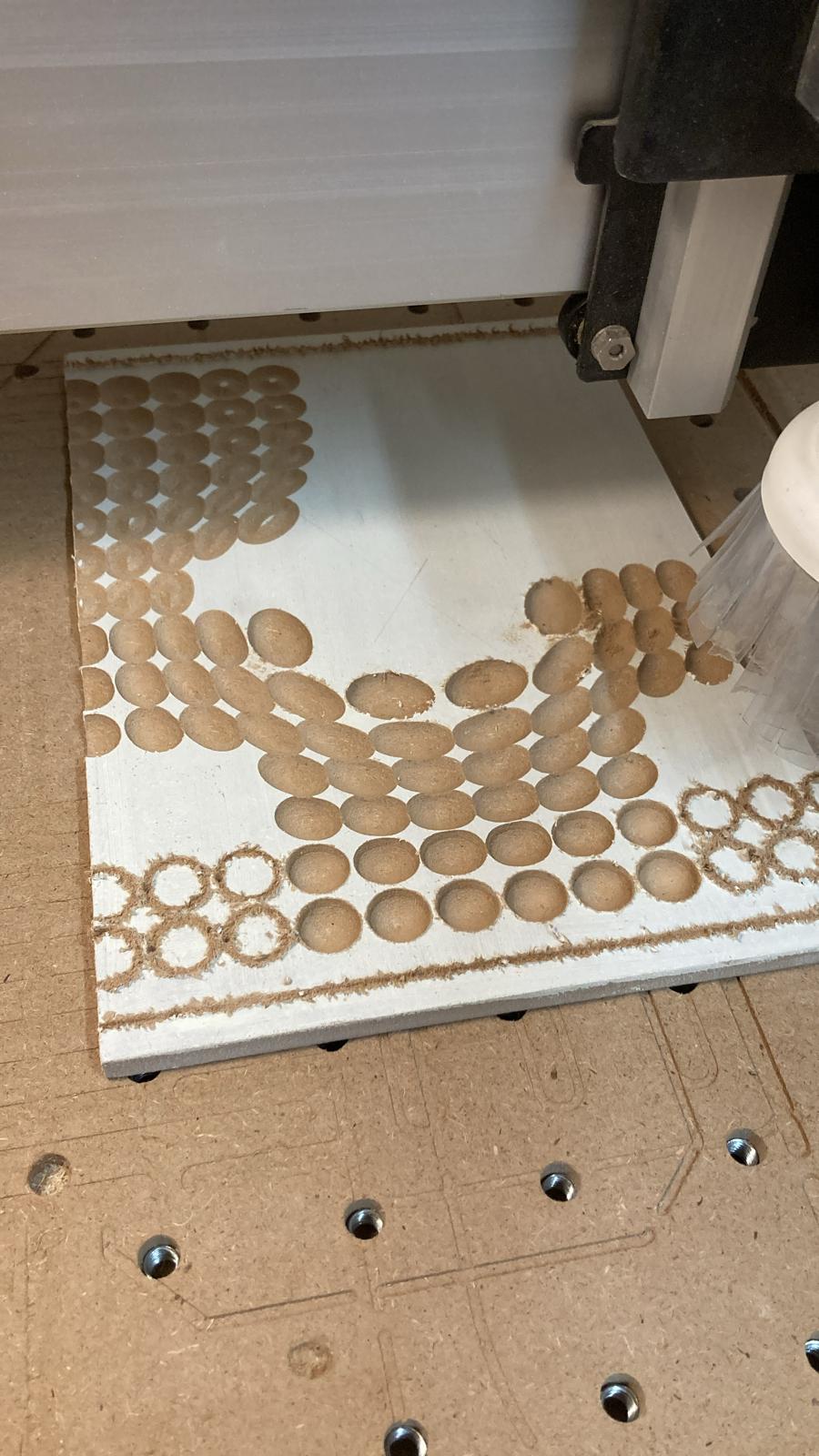

for a small decoration project I am trying to engrave a dotted pattern in fusion. attached are my fusion file, image of first attempt with my Shapeoko 3xxl and example of desired result (similar).
the starting point is a 2d pattern that I model in rhino + grasshopper, which is imported in fusion via dxf.
My first idea was to simply use the engrave tool path in fusion but with a lollipop bit, but fusion does not allow me to do so.
then I thought to use the engrave tool path anyway (generating the TP in fusion with a “virtual” 90° v-bit with same diameter as the lollipop) but actually mounting a lollipop bit on the cnc… but this obviously didn’t work either because for a given depth of cut the virtual 90° v bit has a different width of cut with respect to the lollipop. The image I attached shows this, that the machined circles are too large (besides other attempts with simple engraving of the edges…they look terrible on mdf but the final piece will be birch ply…)
Before understanding the nature of the problem I have also tried to tweak the bottom height, but this did not have any positive effect on the outer edge of the circles, with are still machined too large, so much that they intersect with each other (visible in the upper part of the sample).
How would you solve this (hopefully without having to model every circular slot)?

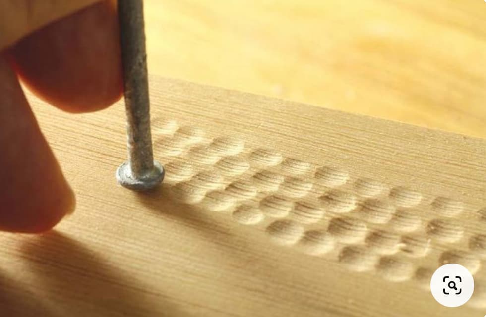

It’s difficult to tell from the 2 images what you are trying to achieve. Your part looks like ovals, whereas the dented wood with the round head nail looks like spherical dots.

Substituting a V-bit won’t work because the angle of the tangent on the ball changes with depth.
You might be able to get close with much higher angle v-bit, like a 150°. YOu could calculate the angle based on the maximum depth and the ball diameter.
Ideally you want a toolpath that does the same thing as a v-carve, but with a ball mill.
If it’s round / spherical dots, then I think a drill toolpath would be the most efficient. You again would have to calculate the depth based on the tool dia & desired depth.
