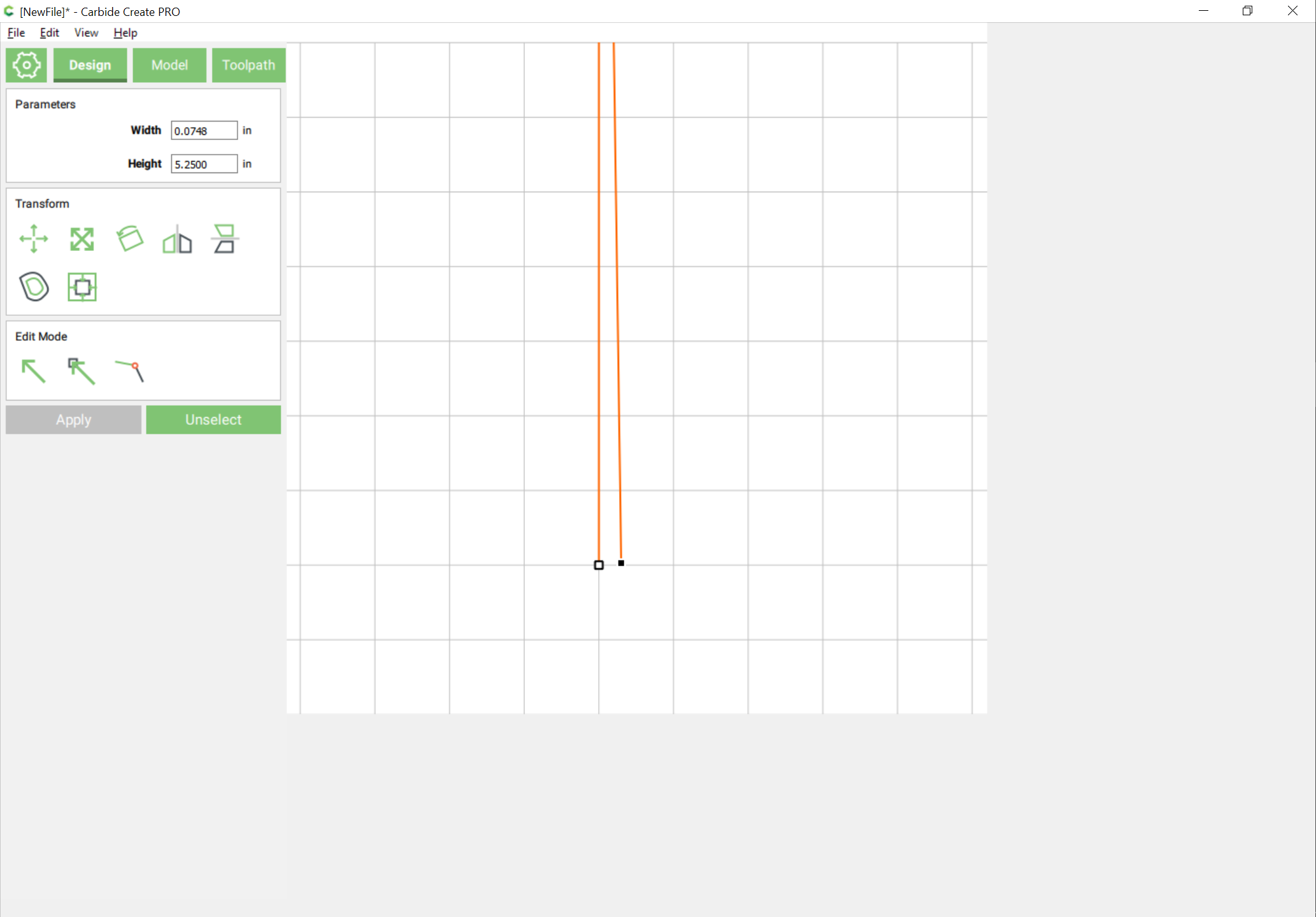

Hi, I’m looking to create a key hold so I can hang up some stuff. I want this to be a repeater process so I wanted to CNC it. I’m trying to figure out a way to create a operation to go into the mater Z depth and travel Y distance and go back to the original starting location and exit.
Is it possible to do this with CC or do I need to use Fusion360?
Thanks
Draw a polyline with two legs and 3 nodes:
and then drag the two open nodes to close to the desired entry point (they can’t be on top of each other or the path will close):
then use a no offset toolpath:
I actually use 3 perpendicular lines to create a “U”. The line that connects the two parallel lines is only 0.0005".

What William suggested works. @CrookedWoodTex, yes, I want to do a key hole but I couldn’t get the bit to enter and exit the board at the same location. @themillertree, that should also work too!
