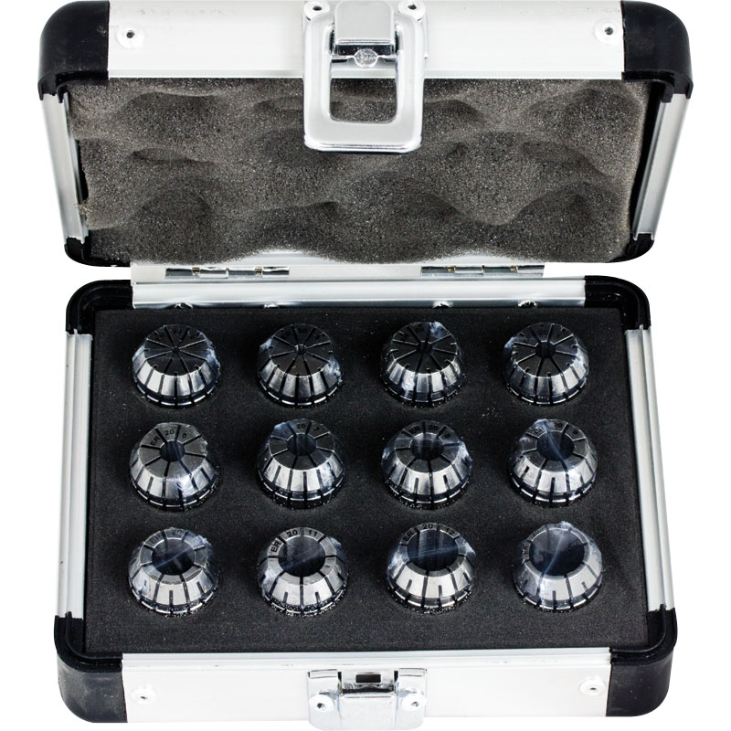

Given the price difference I went for a low runout set
I’ve not found myself having any issues with these.
As for the nuts, be careful to get high RPM balanced nuts, the bearing nuts tend to be for low RPM heavy mills where the out of balance doesn’t matter, on a small spindle they shake quite spectacularly…
