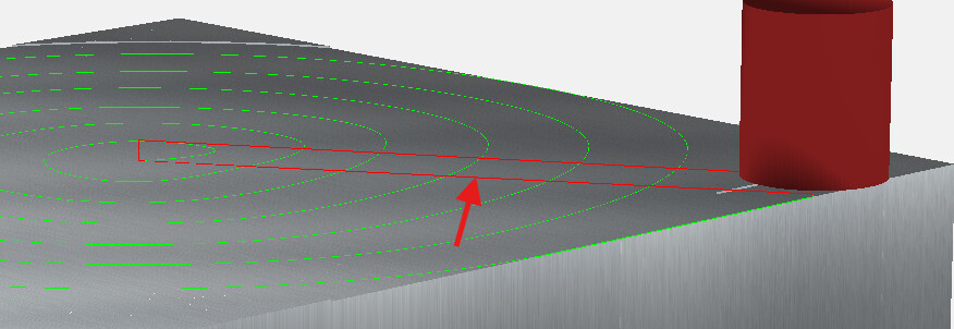

Running into an issue in a contour path with an erroneous rapid move that occurs at the end of the first pass.

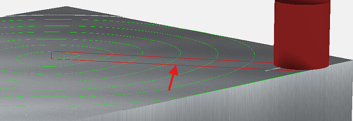

It looks to me like it’s just returning to the starting point to begin the second pass, is it too low and causing a problem?

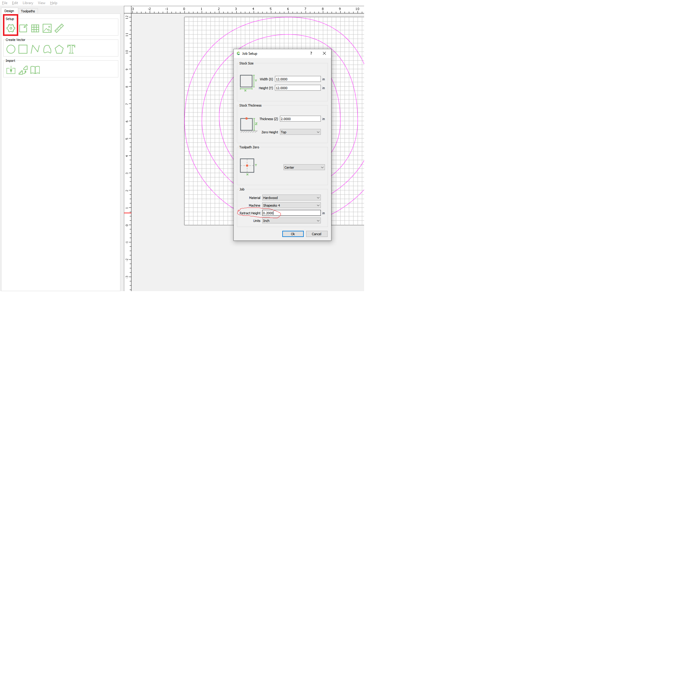

You could change the retract height to make it clear higher
The higher rapid move is at the retract height. Changing it makes no difference.
I guess I’m not understanding what it’s doing that it’s not supposed to do
Good catch!
Bug report filed.
It’s making a rapid move at -0.010 after a 0.020" cut. But it’s crossing an area that didn’t get cut, so it’s a rapid collision.
