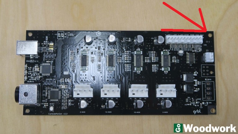

To make a good ground, can i take a feed off of the corner screw on the control board, tap a screw into the y rail and then run wires to that from all the other parts?

For the investigation itself don’t bother connecting at the board level, you could just try to run a wire from somewhere on the machine plates, to the known good ground/earth, and then do the same for the moving parts (X/Z gantry, router). Quick and dirty, just to create an evacuation path for static charges, to see if it changes anything (since it can be a completely different thing, there are multiple possible sources for disconnects)

I kept getting a disconnect issue that was driving me insane. 50% done with a 2 hour cut time let’s disconnect, restart make it to 94% then disconnect, why not. It takes a lot for me to get frustrated enough that it shows but at this point I took my hearing protection off and whipped it at the bench, the wife just happened to walk into the garage at that moment and she was like WTF I’ve never seen you do that. Long frustrating story short I took some 16gauge (or there about) and grounded everything. Ran a wire from a screw on the router, one from a bolt on the z axis, one from a bolt in the right y extrusion, one from the left side of the gantry, and even used copper tape (or whatever it is called) to tape a wire to the body of my MacBook Pro and ran them all to one of the bolts that holds the enclosure for the board. I have not had a disconnect since then. Maybe try giving that a shot and see if it helps only took about 30 minutes so even if it doesn’t you’re not wasting a bunch of time.
I’ll include photos in case my explanation isn’t as clear as I had hoped.
Sorry I’m new so I am limited to 1 picture per post and only 3 replies in a single thread in a row, so I tried to give the most “helpful” pictures.
