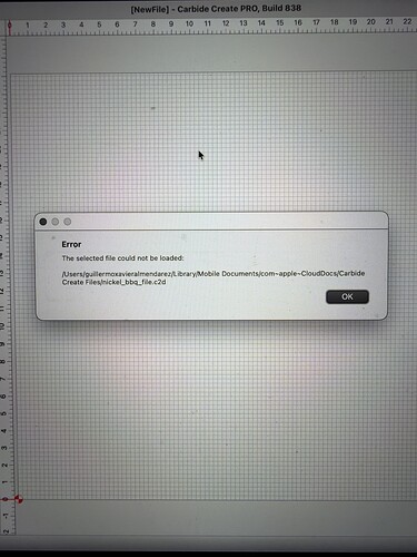

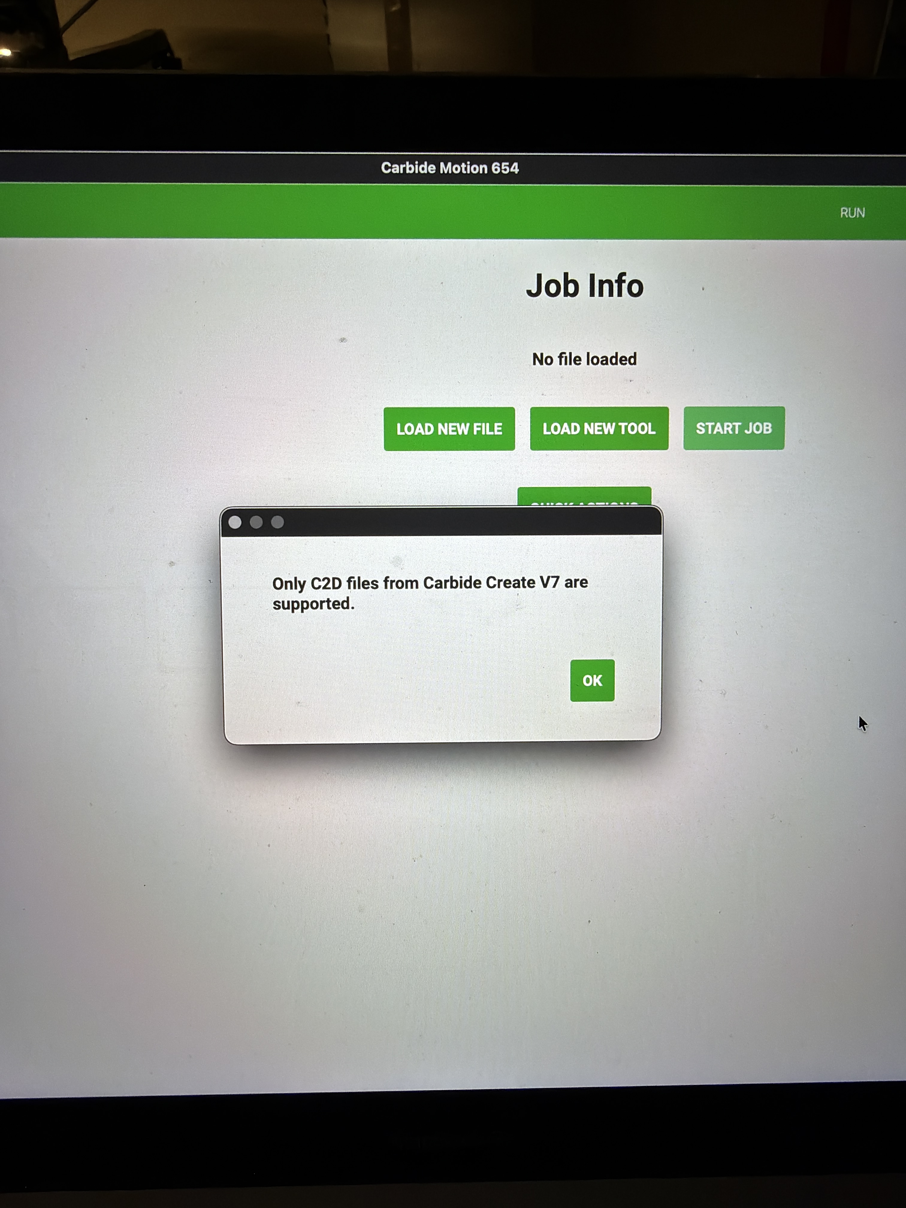

Error Message on Loading File
What is this? I just got this file right where I needed it and now this. Super frustrating.
Most like the file is a v6 file.
As noted in:
https://carbide3d.com/blog/create-v8/
Create V6 files do not load into V8
You will need to open the file in v7:
and re-save as a v7 file, then open in v8, verify all is as you wish, and re-save as a v8 file.

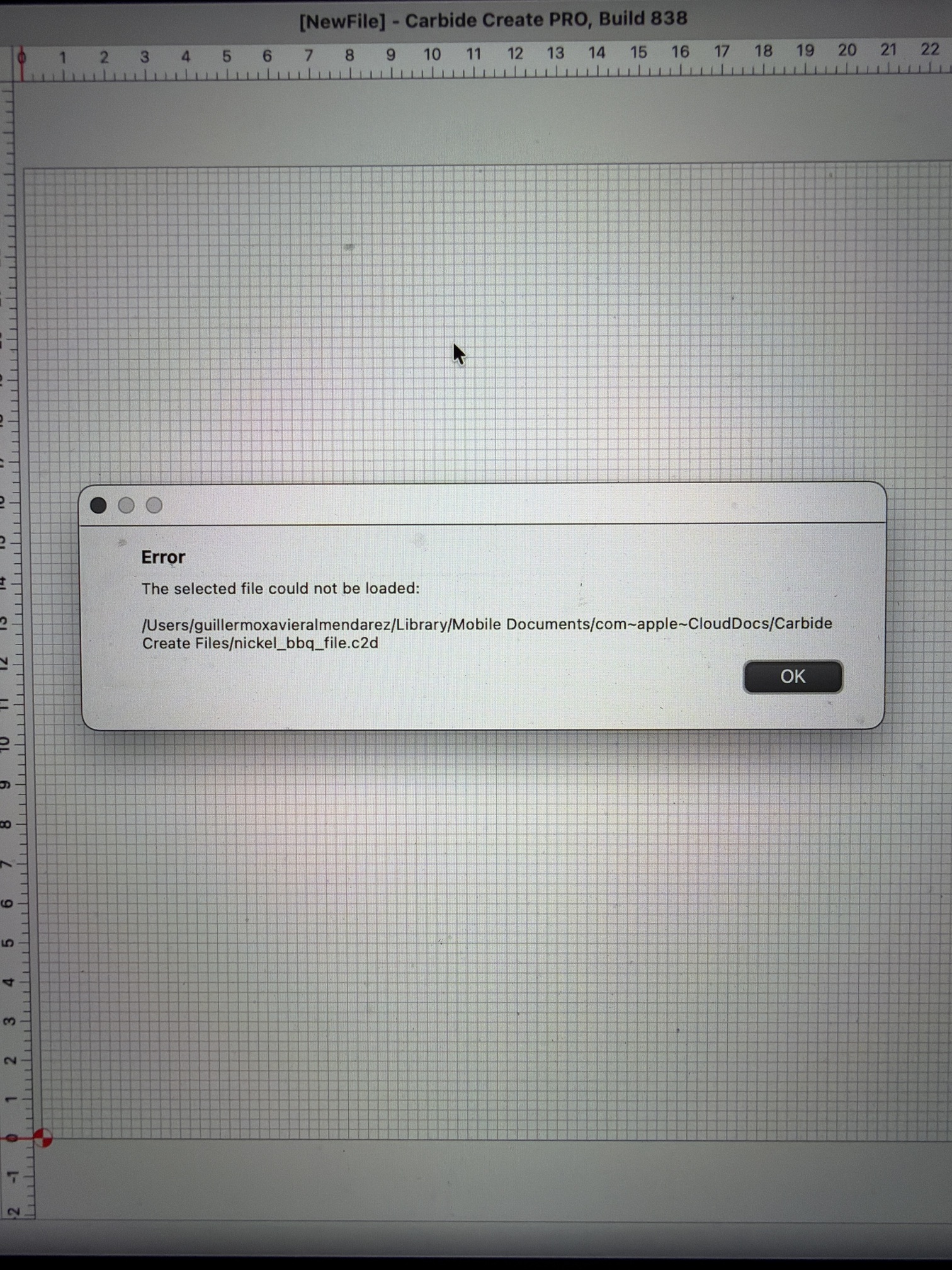

Where do you do this, because I have created 12-15 versions of it on Create 842. As soon as I close it after saving it, I get that message over and over.
Please send us the .c2d file which you are having this problem with, either upload it it here or mail it in to support@carbide3d.com
Is Carbide 3D no longer compatible on a Mac soon? I got it to work, but had to create a new folder in my desktop and not in iCloud.
We have archived the last build of Carbide Create which will work in Intel Macs at:
More recent builds and the current betas require the new Apple M-chips:
https://carbide3d.com/blog/intel-osx-support/
