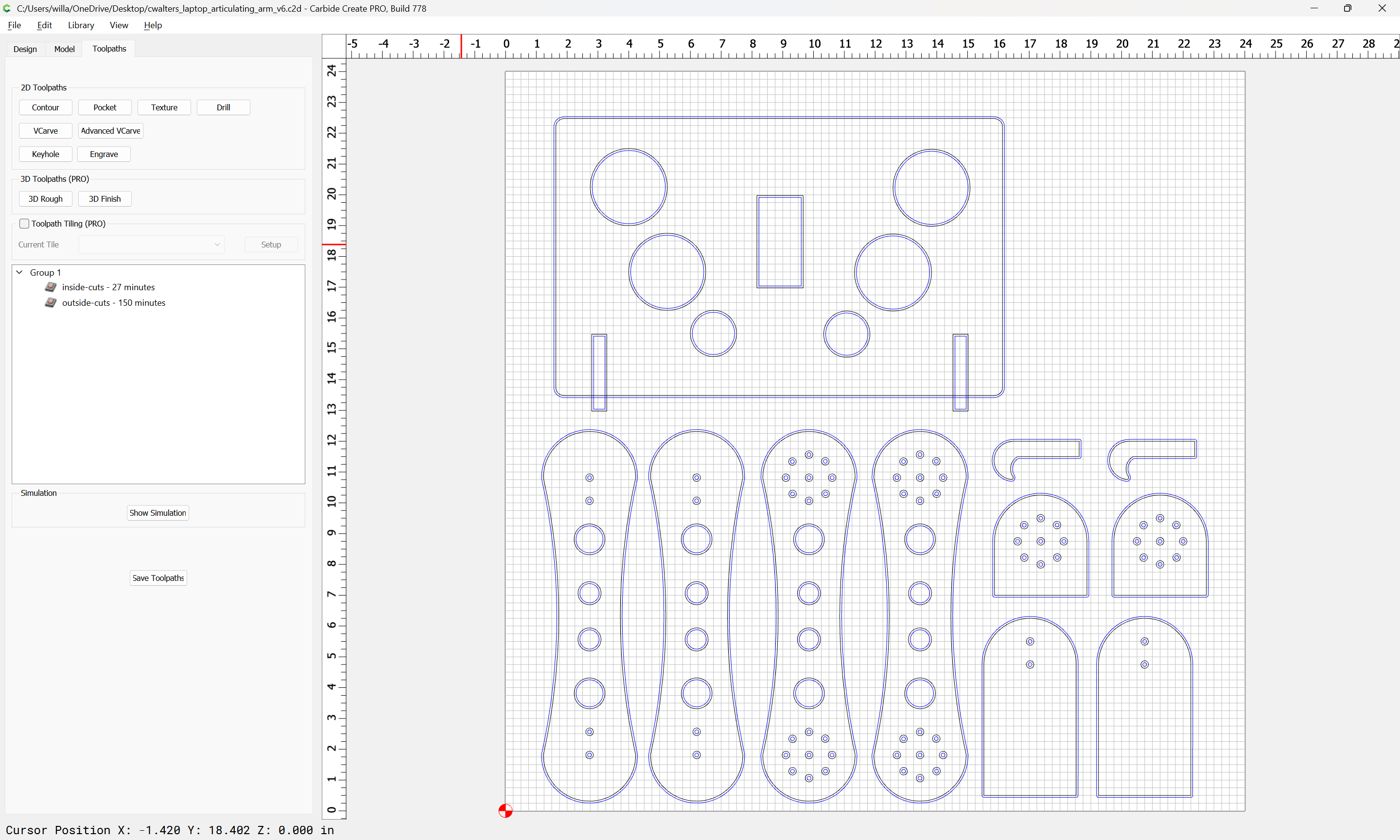

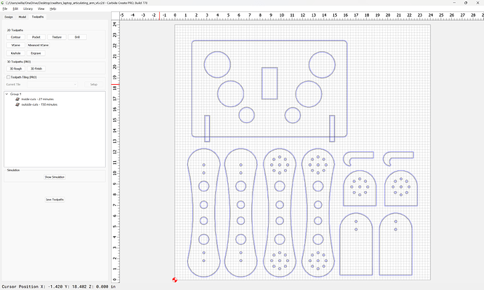

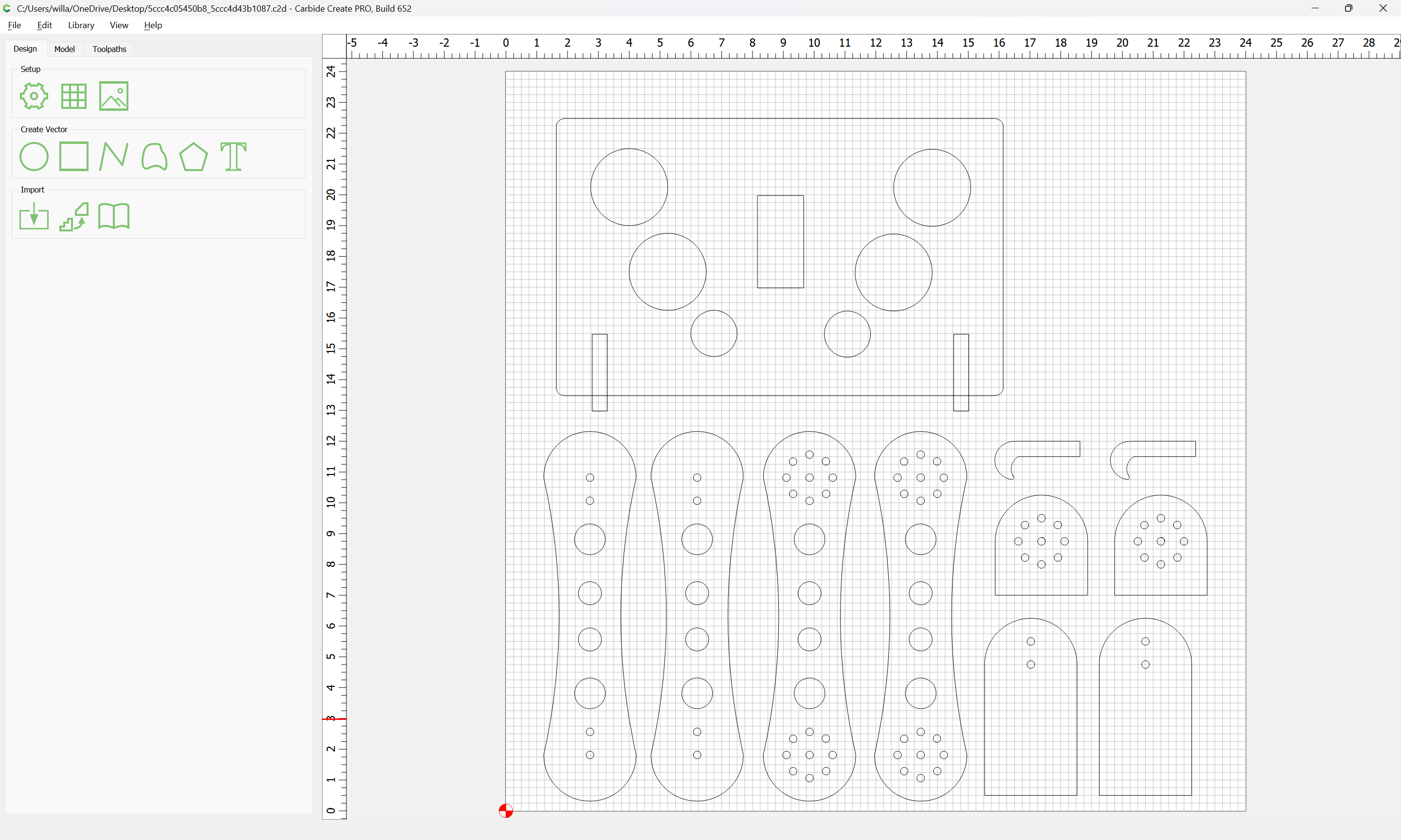

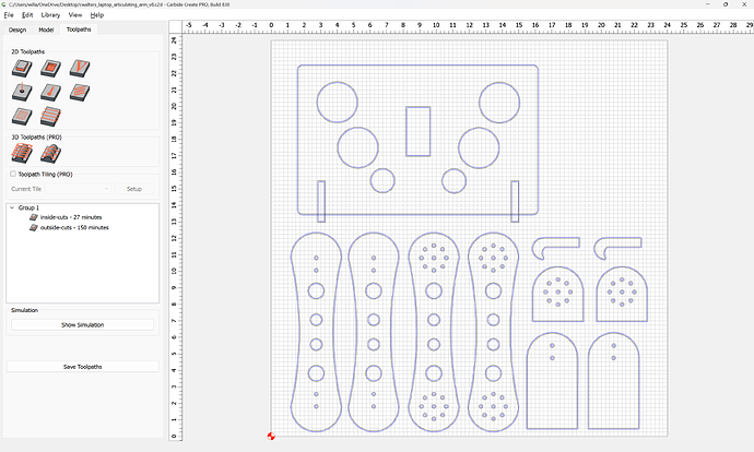

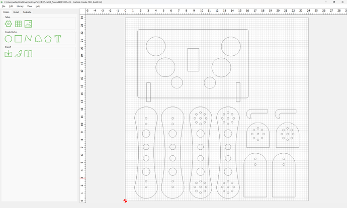

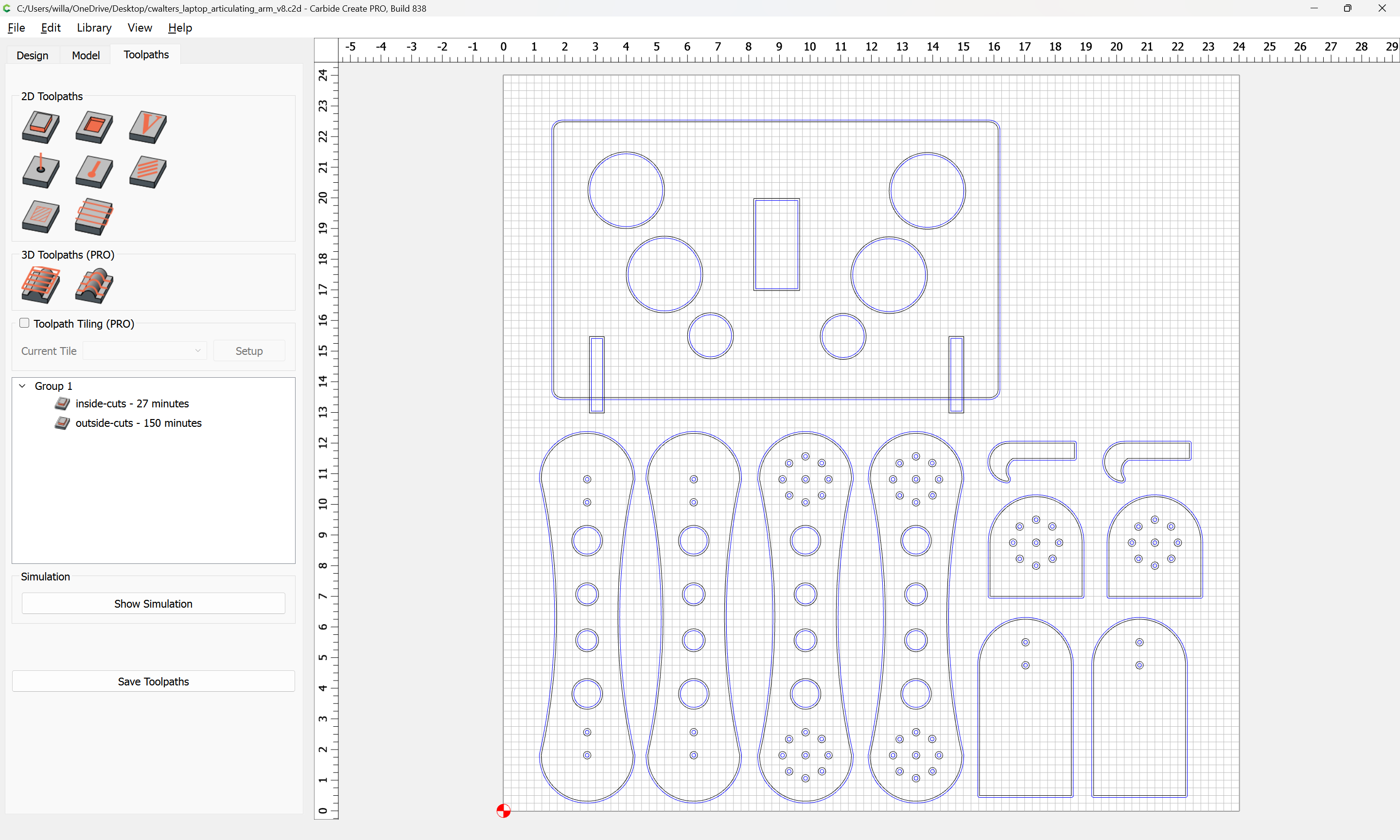

Here is the link:
which opens in v6:
and once re-saved, opens in v7:
and once re-saved as a v7 file, opens in v8:
Attached as a v8 file.
cwalters_laptop_articulating_arm_v8.c2d (264 KB)
