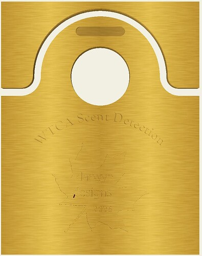

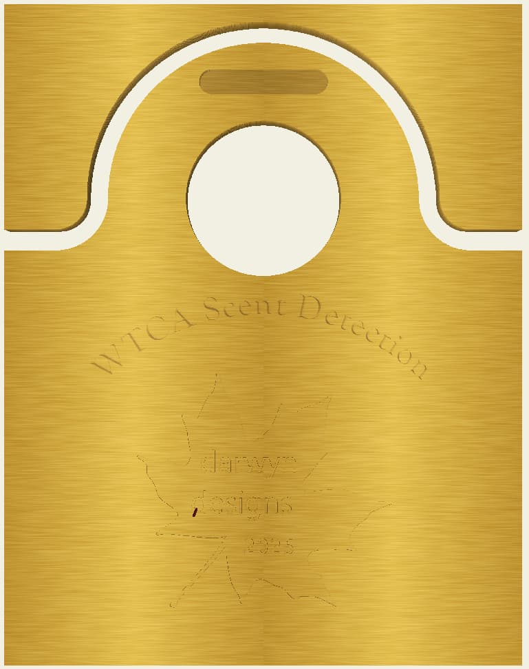

In order to improve the appearance of the simulation, I frequently create toolpaths (usually pockets) to remove excess material from the simulation. I would never want to run these paths in the real world.
I can manually disable them (which I do now), but switching them on and off repeatedly as the project iterates is ripe for errors.
I would like a way to designate a toolpath as “No GCode” - never saved to the output file.
EDIT: Also, such paths should NOT add to ‘Toolpath Volume’ in CC Pro.

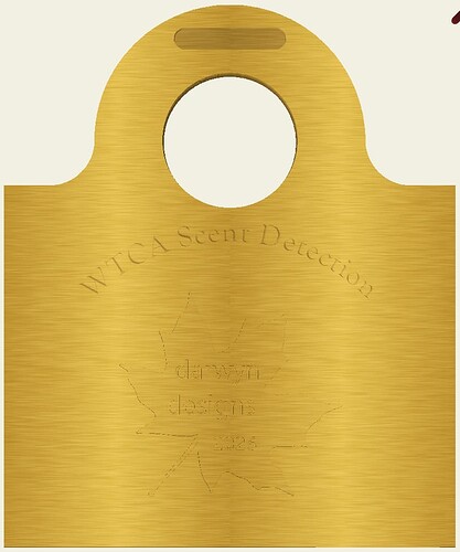

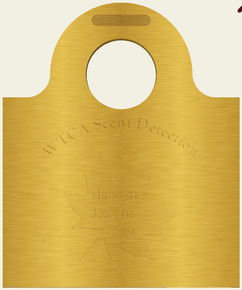

I’ve included a couple of screenshots, here, if I was trying to get a project approved I think the second one is better.
Without:
With:
