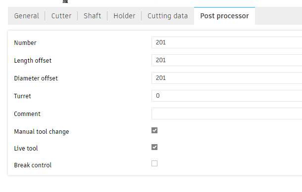

I’m using Fusion, and so I often end up with multiple jobs (.nc files) using the same tool. Like using an end mill to bore holes and then to cut out the part. However, every time a job runs, it wants me to load a new tool, even though the tool is the same.
I get that Carbide Motion won’t know what tool is loaded, but could that dialog have a “Tool Already Loaded” button so that it doesn’t have to do the BitSetter thing again?

I can’t speak to whether or not CM will ever implement a feature like that, but if these are programs you’re running again and again, you can just open the gcode file and delete the load tool command (M6).
You can also edit your post processor to deal with m6 automatically. I’ve got a check box in my post to toggle the first M6 code on/off. I also added a toggle for the remaining M6 codes if any additional tool changes are necessary. It’s really convenient for testing quick cuts.

In Fusion, Post processor tab, if you select the Manual Tool change checkbox, the M6 command is not in the Gcode.
