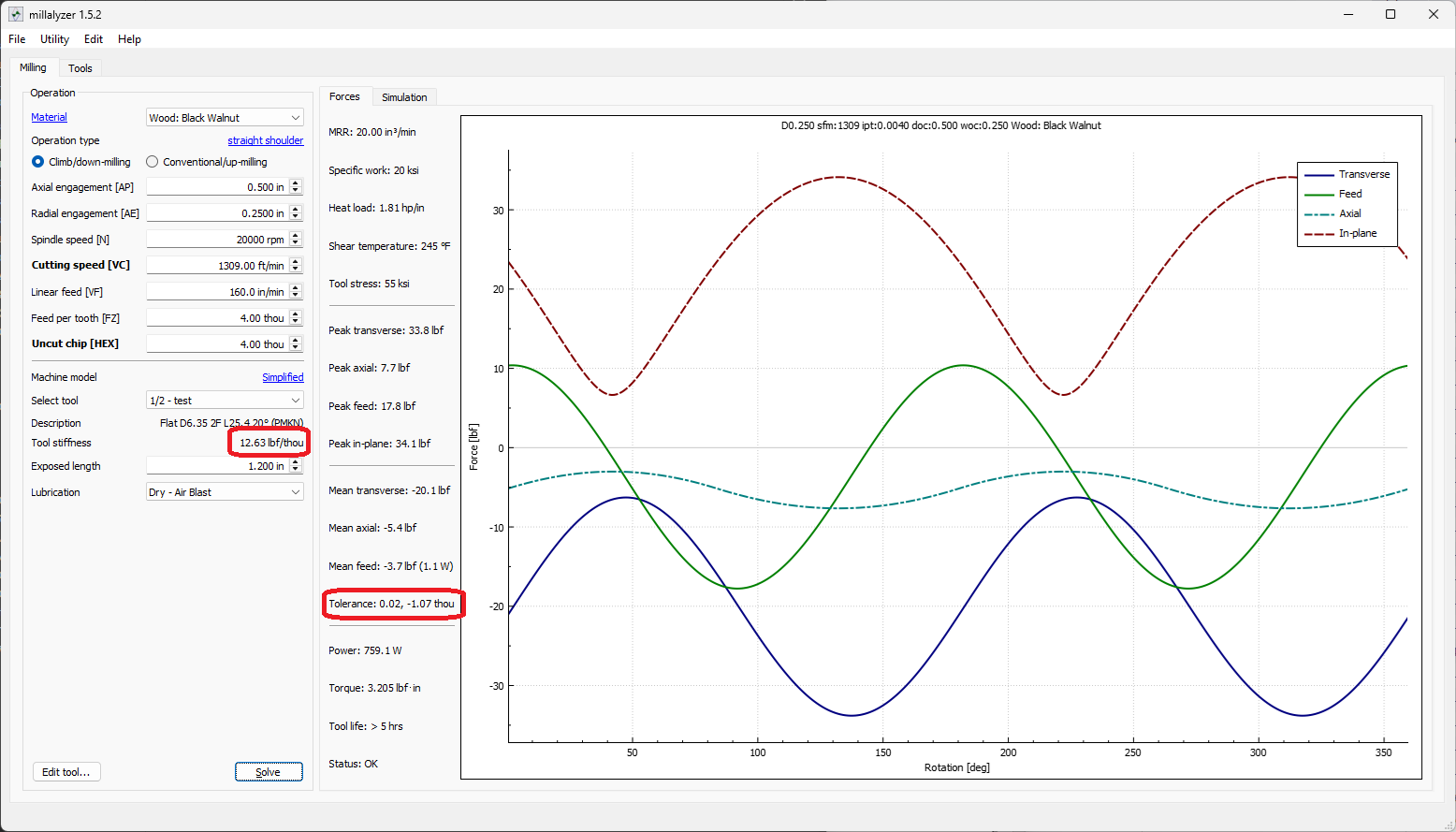

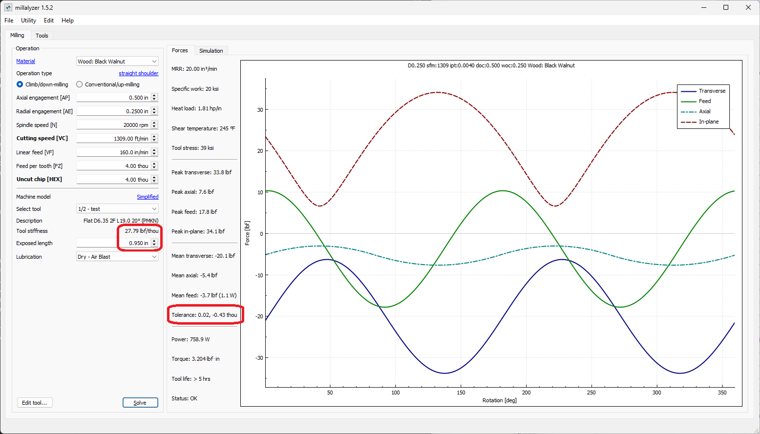

If I understand this correctly you are asking how much more you can push a 1/2" shank tool regardless of the diameter of the cutter. If that’s correct, then there’s functionally no difference at this level of machining. There’s some exceptions for when you get to things like metal. For the most part the rigidity isn’t significantly increased if the stickout and cutting length are reasonable though.
Here’s an example using Millalyzer:
Only thing I’m changing between these examples is the shank.
1/2" shank:
1/4" shank:
So again with the same stickout (1.2") and cutting length (1.0") you pickup 2.65lb more to deflect the tool 0.001". But that works out in this test cut (0.50" deep, slotting, 20KRPM, 160IPM/4064mm/m, in black walnut) to only being a cut difference of 0.00021"/0.0083mm more deflected. You are going to reach another limit before this minor shank difference matters.
Where you will see differences is that in general the rest of the tool will not be the same. The length of cut, overall length (and therefor stickout) and carbide grade used will typically all be different. Typically not in beneficial ways.
You can see more of a technical breakdown I went through with this on the 8mm vs 1/4" here:
Main points being that things like the rest of the tool geometry are more important in rigidity even when shrinking both the shank and tool diameter.
Hope that’s useful. Let me know if there’s something I can help with.

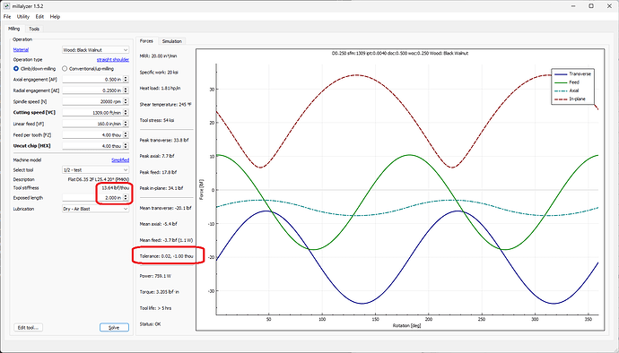

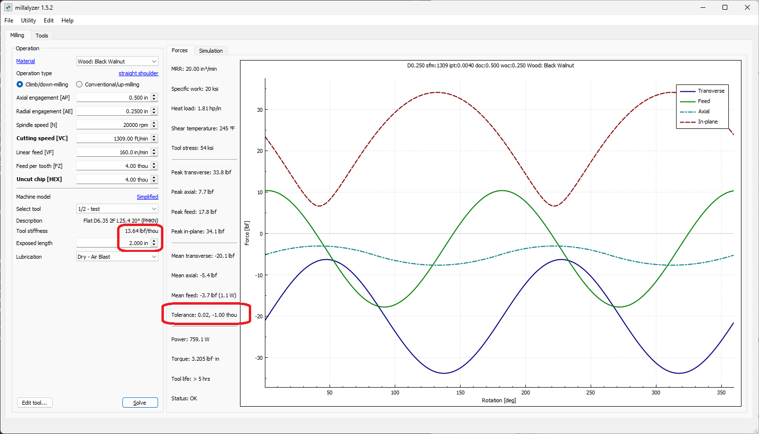

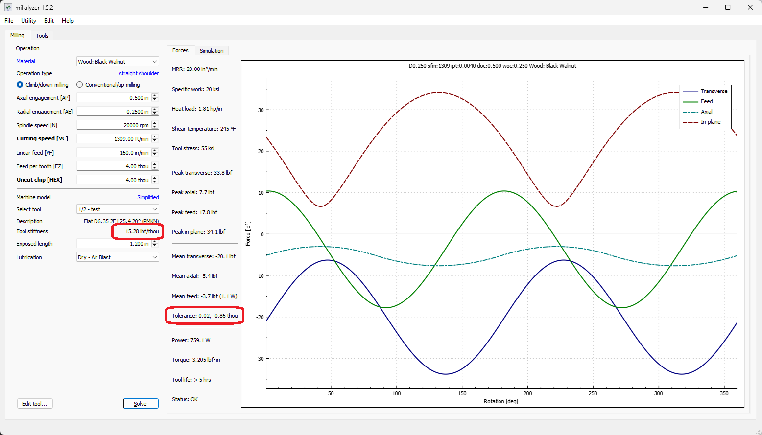

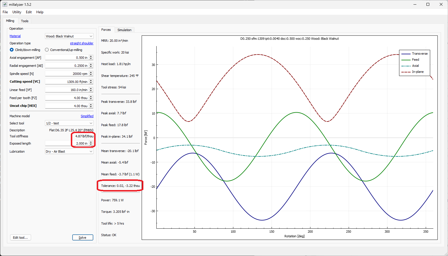

More or less it depends on the other factors. As an example let’s say that we have the same tool above in a 1/4" and 1/2" shank. But even though there’s only 1" worth of cutting length we are leaving 2" of the tool sticking out of the router/spindle. In this example the 1/2" shank would be of benefit.
1/2" Shank:
1/4" Shank:
However, if we get the shorter overall length tool and only have the 1.2" sticking out of the collet the effect is as previously stated.
Or, lets say that we only need to cut 3/4" and have a 1/4" cutter with that 0.75" cutting length and can have only 0.95" sticking out of the collet:
It’s vastly more resistant than the 1/2" tool even at the 1.2" of stickout.
Vastly more matters here than the shank size.
Typically the reason for larger spindles is if you are either power limited or to use larger cutting diameter tooling. There’s ways you can reduce time by using it that way. But a 1/4" diameter cutter on either shank is going to be limited more by other factors first barring if you have a required stickout that’s fairly long.
