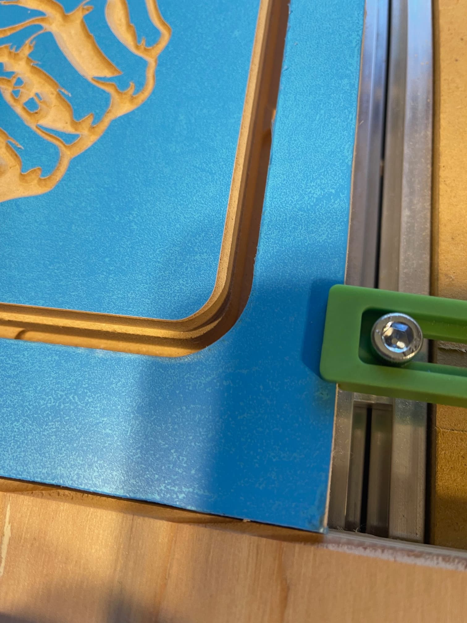

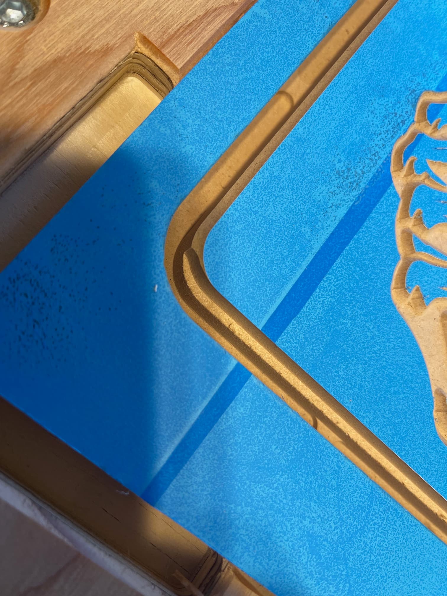

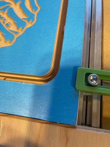

This was a sign project. I created a contour path to cut out the sign. The Contour cutout was done with three tool paths. The first one used a 1/4" end mill to start at the top and cut down to .30 of an inch. The second Path switched to a 90 degree V-bit to add a chamfer to edge. For the final path I copied/pasted the first contour path and changed it to start at .3 and cut to the bottom with tabs. The first two paths went as planned. When the 3rd path started, it did not start in original path, it started about an 1/8" of inch (or slightly more) into the project and removed the chamfer along the bottom of the sign, but it only did this the first time around. As it continued to carve to the bottom, it used the correct path. You can see this in the pictures I took of the left and right bottom corners. I don’t understand why this happened and if it will happen again. It messed up a 3 hour project and I am worried about it doing the same thing again. This did not happen in the simulation.
What sounds odd to me is that after the first pass of the third toolpath it went back to where it was intended to cut, but the first pass was off the ~1/8".
Was this just the Y-axis?
Did it cut above the intended edge at the top, or was it only along the bottom edge?

The machine did not cut in the wrong place. A CNC cuts exactly where it was instructed to cut. That said there are things that get the CNC off its original path. The material may have moved. One or more axis may have lost steps. A dust host may have caused you to get lost steps by getting hung up on something. Drag chains can get caught or fall off their perch.
So yes the project was not cut like you intended but the software cut exactly where it ā€œthoughtā€ it should. So if an SO4 Pro or SO5 lubricate your linear rail bearings. On an SO3/4 check your stepper motor pullies and the v-wheel for proper tension. Make sure your rails are clean. Check your dust collection to see if it could have been obstructed.
The software does not randomly move but the software assumes everything mechanically and electrically worked. When something mechanically or electrically went wrong the software has no feed back mechanism to correct itself.
