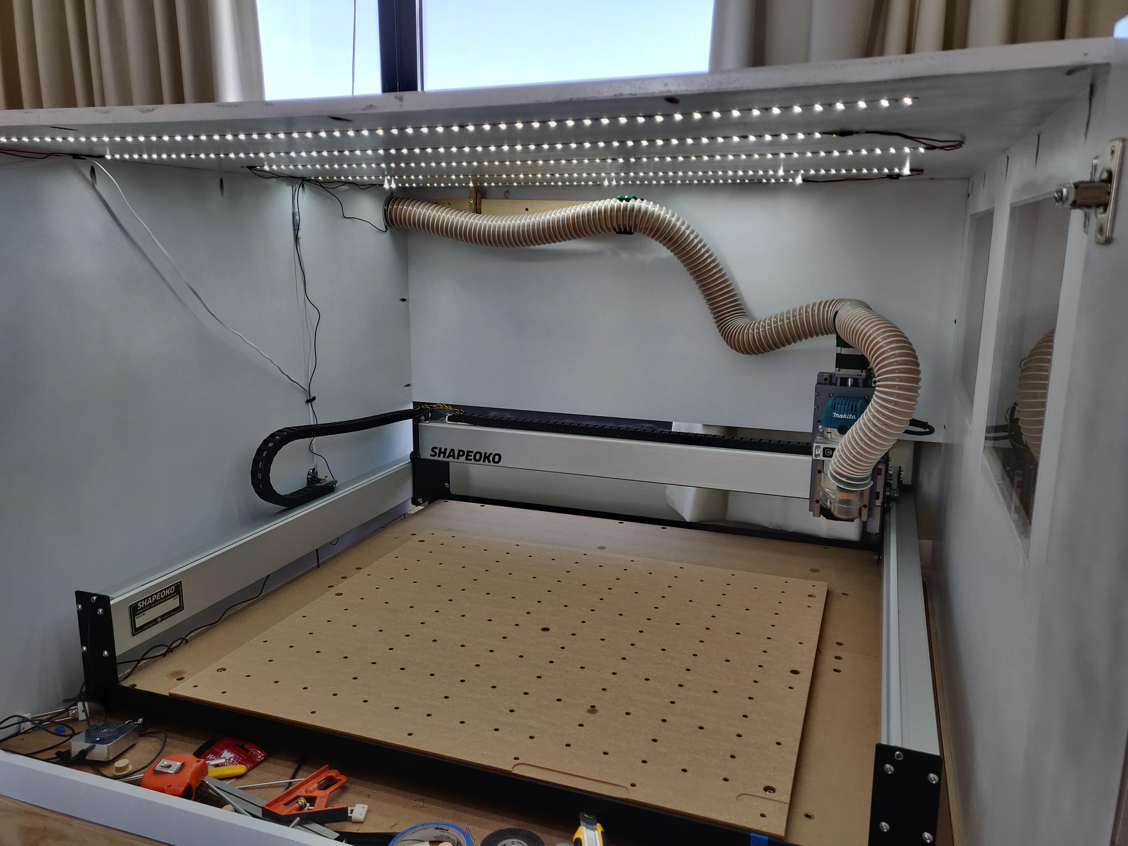

Finally an enclosure but need help with HDZ
Due to Covid i was away from my shapeoko for a few months as I coudn’t travel back home, but finally got back to it with my new (and not so easy to order) HDZ. with this upgrade I decided to fully disassemble my SO3 and made a better effort on tramming, squaring HD eccentric nuts etc. and finally building my enclosure which i’m pretty happy with although for some reason even after watching Winston Moy videos i made the same mistakes, i keep bumping my head and I forgot to measure the depth with the dust shoe so i had to extend the table and re-make the enclosure!! o well.
Now the troubles:
First problem: Touch probe was misbehaving and CNC would freeze mid job, THANKS!! to this forum, found out it was because i moved the box to the enclosure and lost the grounding on the X rail so this has been apparently fixed.
Second Problem, When I tried to pause my waste board surfacing job because the whiteside end mill grabbed the brush of the sweepy and when I resumed the job I lost about 3mm on Z as it plunged into my waste board. (this is happening every time I pause a job). any ideas?
Third Problem, not sure if it’s related to the second. i started seeing drops of grease in my waste board, looks like the left rail on the HDZ is dripping, is this normal? any fixes?
Any help is greatly appreciated!

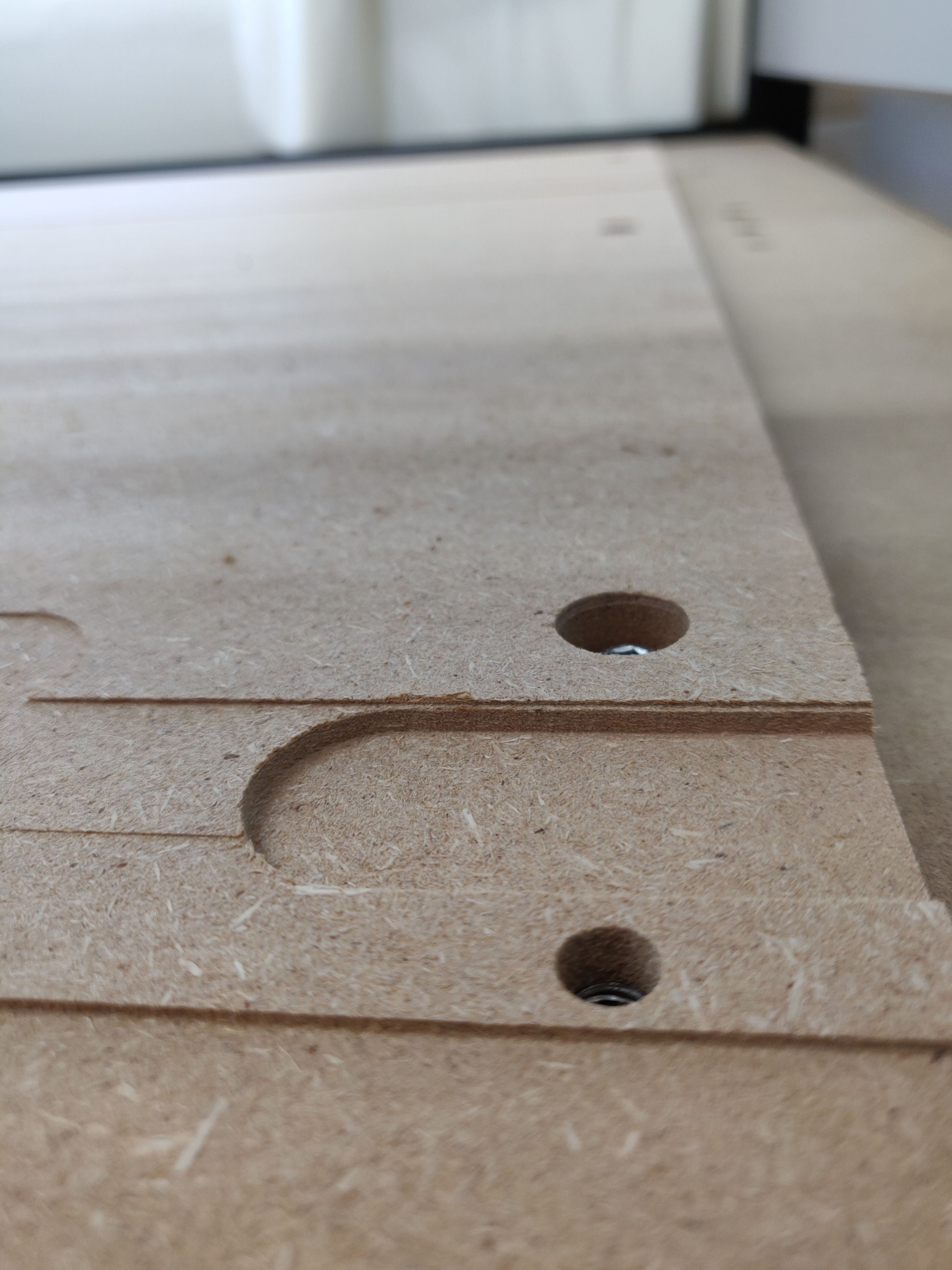

Hi Liam, just by pausing the job and hitting start again. So in this specific case I started the surfacing job, the sweepy was dragging the brushes and got caught with the end mill some bristles went flying and I paused the job, hdz retracted, I removed the brush section of the sweepy and hit start to continue it slowly went down to what appeared to be close to Z0 stopped and then plunged about 3mm more and resumed motion. It did it in a couple more similar scenarios different causes for pause. You can see it in the ñicture of the waste board. (Never thought I would have such a hard time surfacing :slight_smile: )

That really shouldn’t be happening. When the machine pauses and the Z retracts, does it stop short of the top of the Z axis or bump into the end and make a bit of a grinding noise?
Also, how consistent is the Z depth whilst the machine is running the surfacing cut? On an HDZ you should expect pass to pass to stay well within 0.025mm (excepting any tramming ridges).
The retract seems and sounds fine goes up and stop maybe about 1/2 in before hitting the limit switch. Consistency of cut also seemed fine during the surfacing, the end result looks and feels pretty good.
