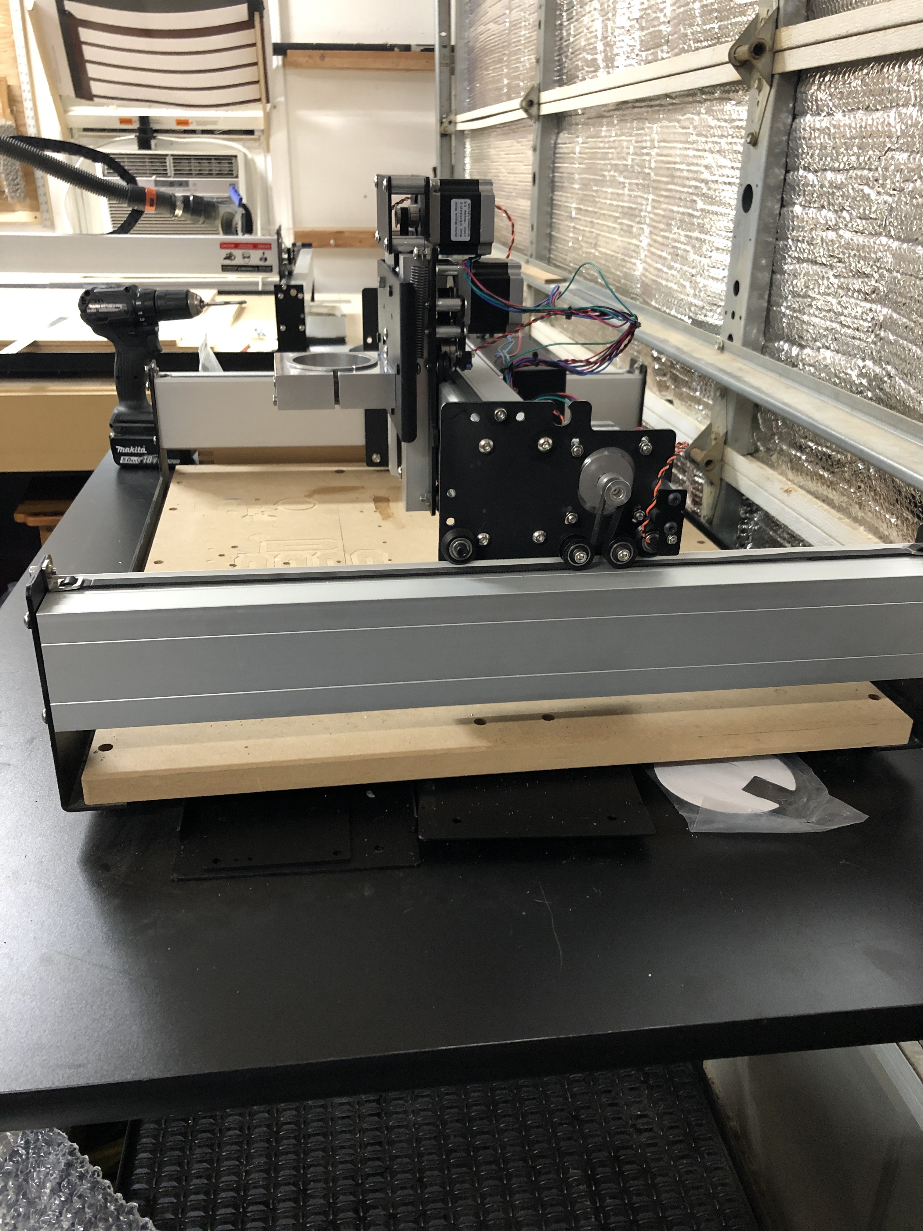

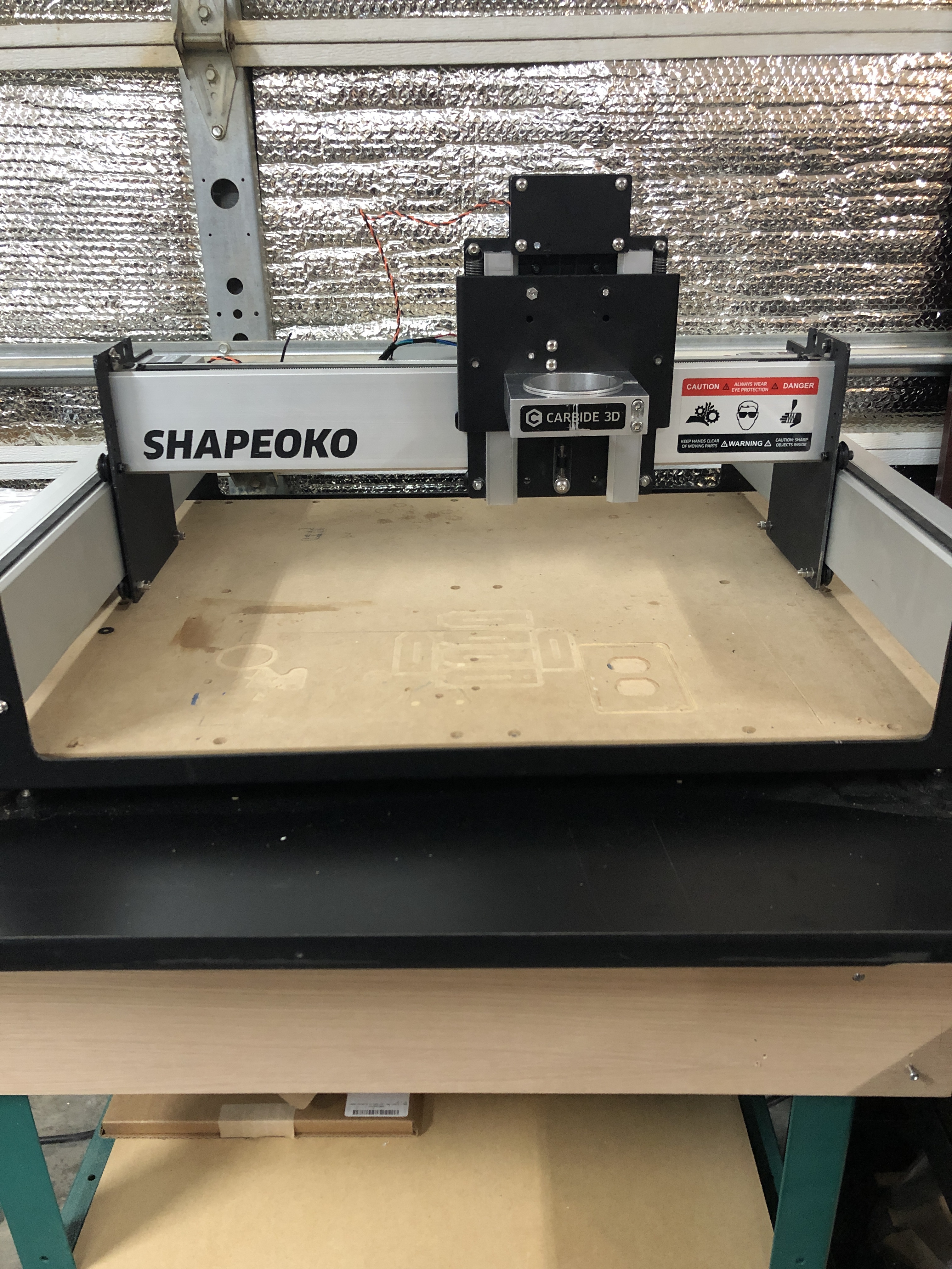

Finally have my Franken-oko up and running

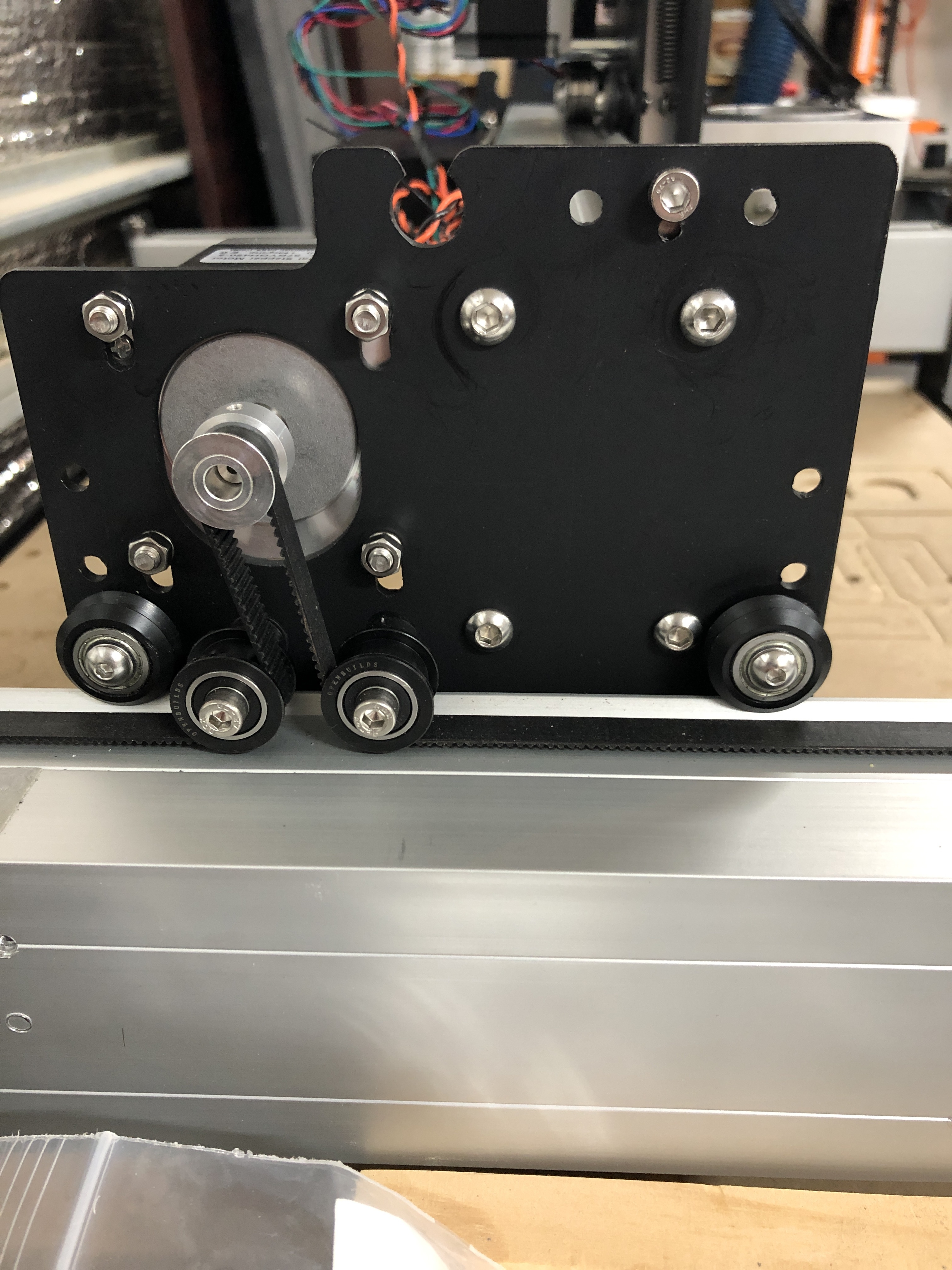

I had lots of leftover parts from upgrades, so I decided to try and make a new Shapeoko3. The main thing missing was the Y axis plates, which Carbide would not sell me. I had someone cut a couple for me with a water jet for $70, which I though was a great price. Electronics and a few other parts were easy enough to source. I got the whole thing together for about $270.
Not sure what I’m going to do with it yet, but it’s together and working great.
