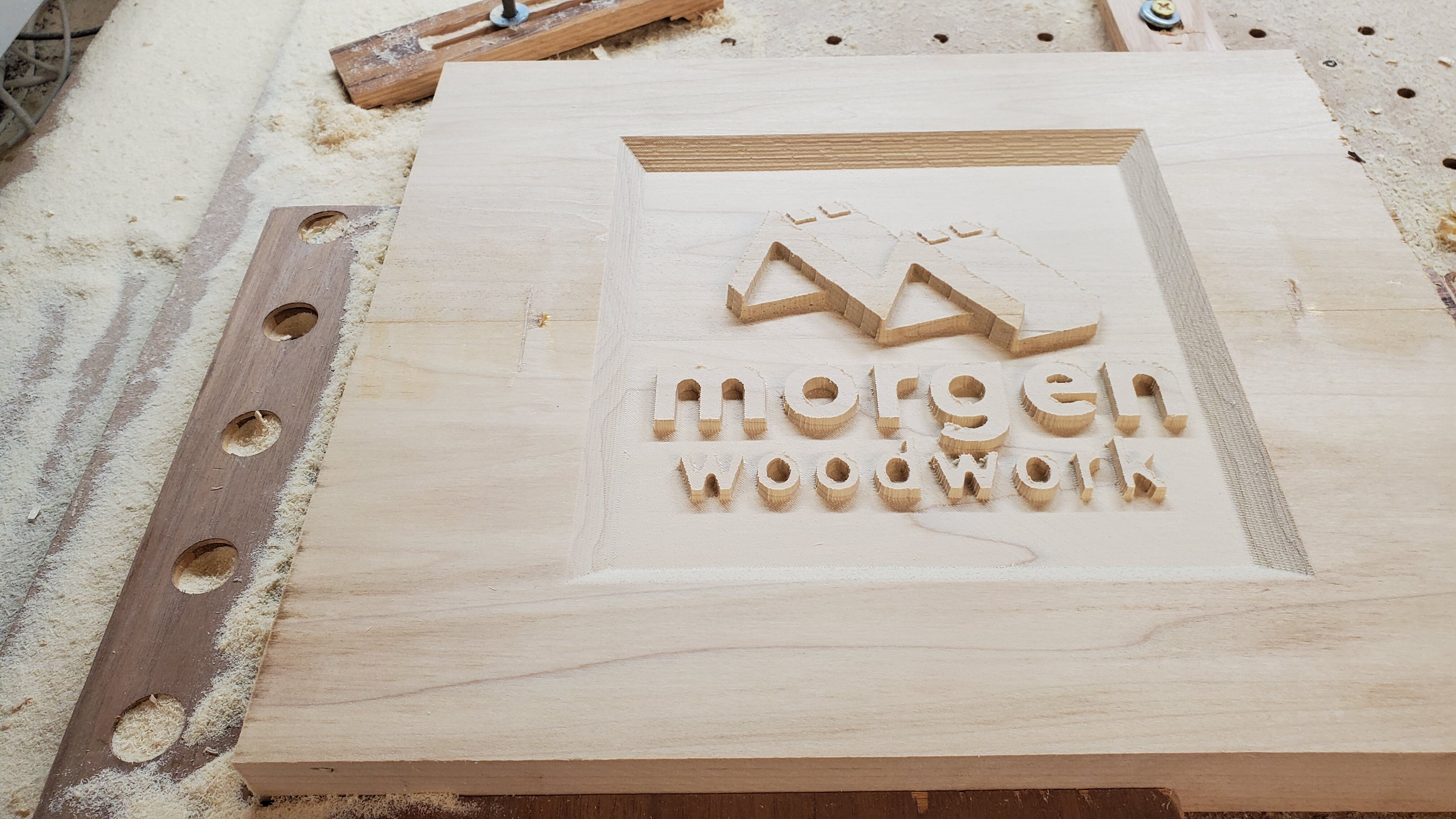

I finished my first 3D Modeled piece using CC Pro. It was a 2.5 hour carve and all in all, I’m very happy with the output. I took these photos before doing any post-creation sanding, so that I could share the results with the community…First here’s the result…

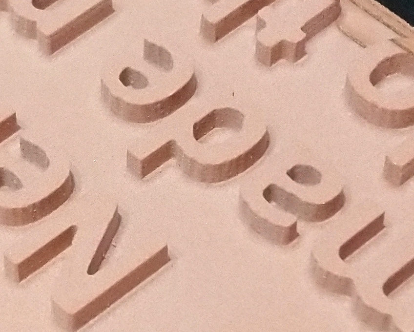

Room for improvement…I’m not concerned about the fuzzy tops - that’s easily remedied with a quick pass of 220, but on closer view, the edges of every surface is scalloped.
I used a 45 degree finish pass with this bit, set as a 1/16" ball tip (which is the advice I had received because this type of bit is not supported directly by CC) at 50in/min, 20% Stepover, .050" cut depth.:
I’m guessing the experienced among you have seen this before and remedied it. Could you please share? Are better results going to come from a different bit? A different angle? Different speeds?

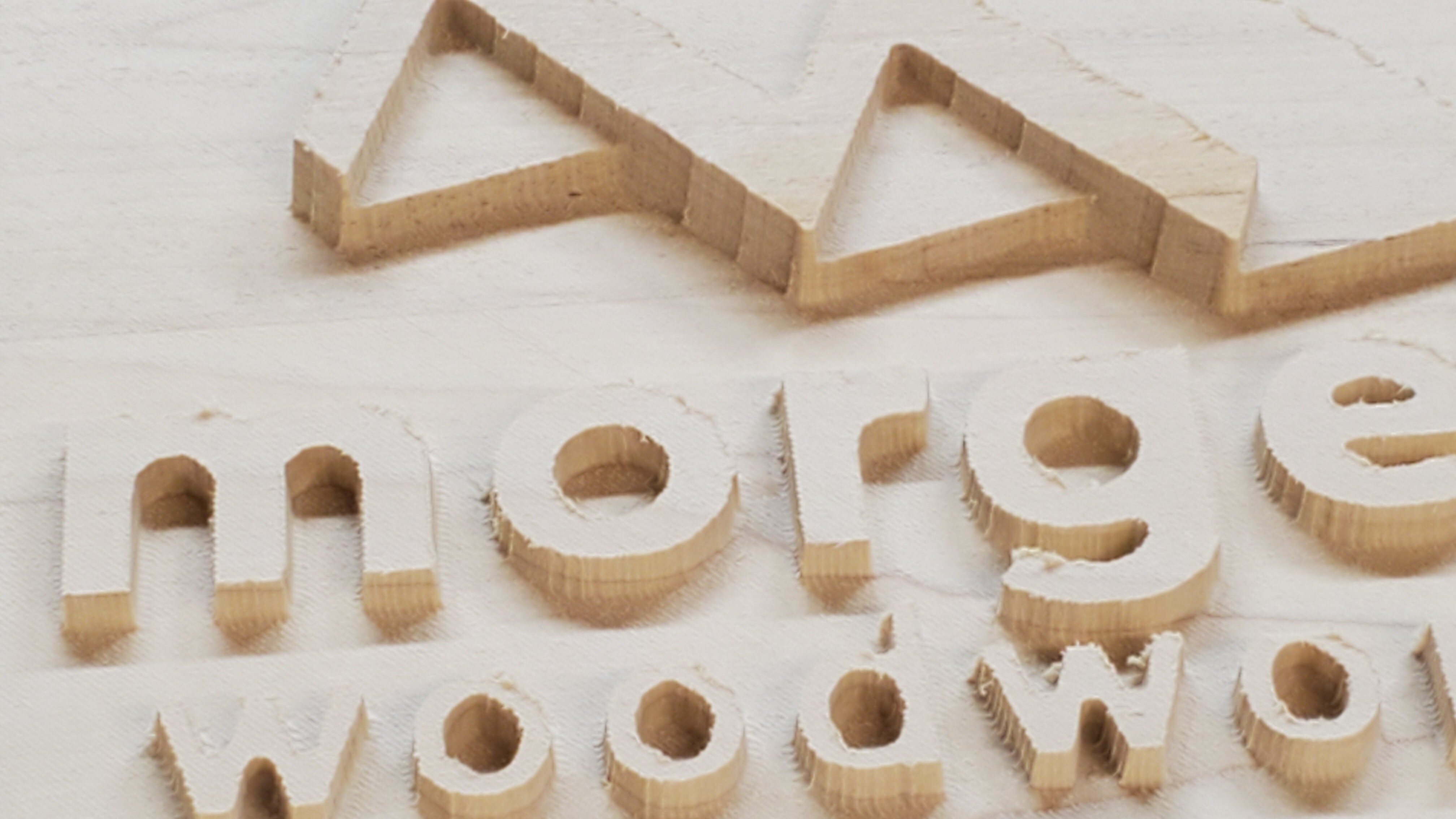

I did vertical and horizontal passes for that thing below when I was playing with CC Pro and a similar tapered bit, and got relatively clean letters,
but the cone-shaped tool still left tiny marks if you look closely enough (those letter legs are 2mm wide):
If you piece is still on the machine, try a horizontal finishing pass ?

Since most of your design is 2.5D and with a limited number of different depths involved, I wonder if you should try and revisit the project to only do the sloped outside borders with a 3D toolpath, and use regular pocketing toolpaths for the rest? I think you could optimize cut time by doing this, as well as wall finish.
