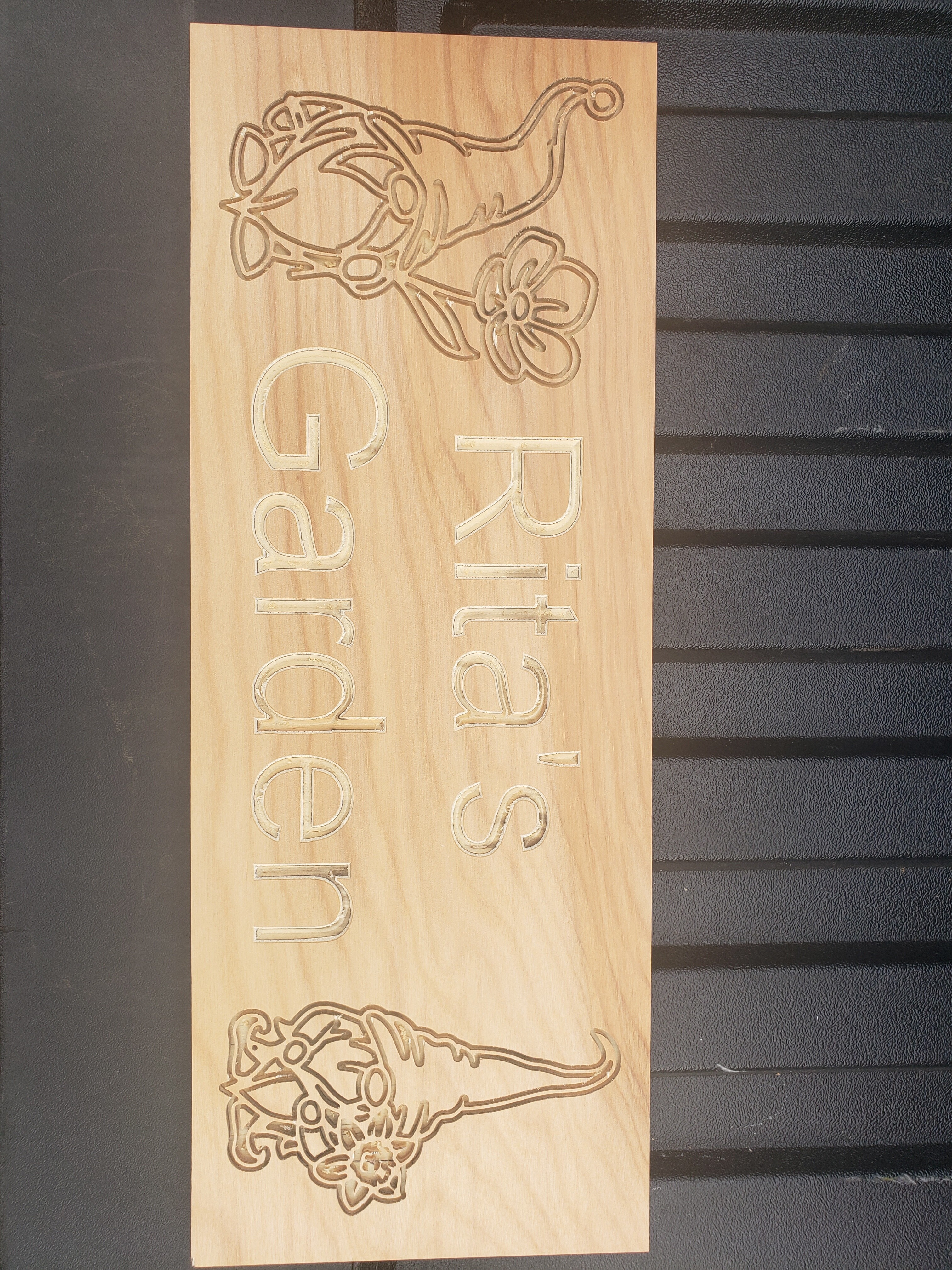

First full test run
Super happy with how it came out, first design where I did everything from importing the image to setting paths, other than testing it on plywood (small amount of chipping out) it came out super clean no sanding required. for the real one I’m going to do an epoxy fill and make it from maple. [details, letters are 90 v-bit, 50"/min, .25" depth 18,000 rpm. gnomes are 1/6" endmill, 35"/min and .015 depth]
