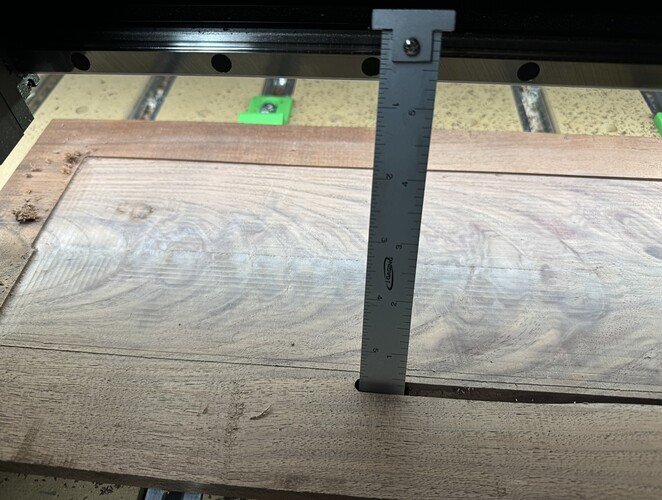

Flatten job Z-Axis drives 1/2 into project
I am running a .040 flattening job. 1/2 way thru it looks like it might be cutting slightly deeper and then on one leg it just started to run deeper into my project 9” until it was 1/2 inch deep onto the wood. I also have a problem when i turn off the machine that the spindle runs down until it hits the spoil board. It acts like the machine cant hold up the spindle.
Issue A - Make sur ethe endmill didn’t slip down in the collet.
Issue B - That is normal. C3D assembles those pretty accurately, so there isn’t much friction to hold it up once the steppers are powered down. It holds up a router just fine, the 65mm spindle some of the time, and the 80mm spindle never. :smiley: Progressively gravity does it’s job the heavier you get. That’s why if you get their 80mm spindle kit, it comes with their strut to hold it up when powered off. You can also purchase it separately here:

I think I’ve read similar situations before where the gas strut was actually failing or defective or something. Either way best bet for this is probably reach out to support as it’s unlikely to be anything else besides maybe a faulty controller.
