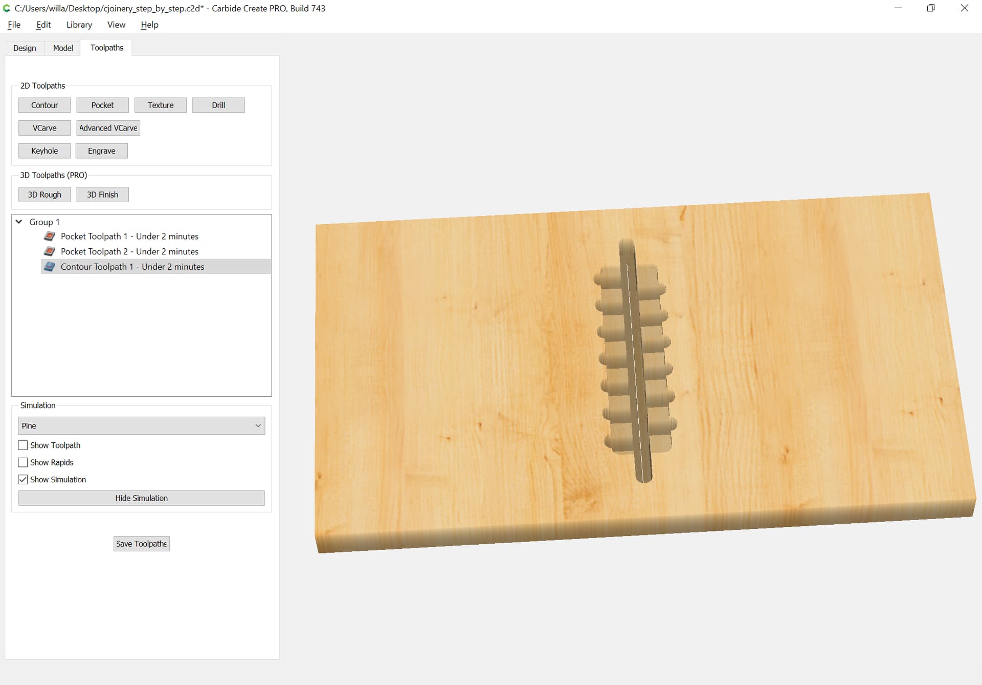

Assign toolpaths:

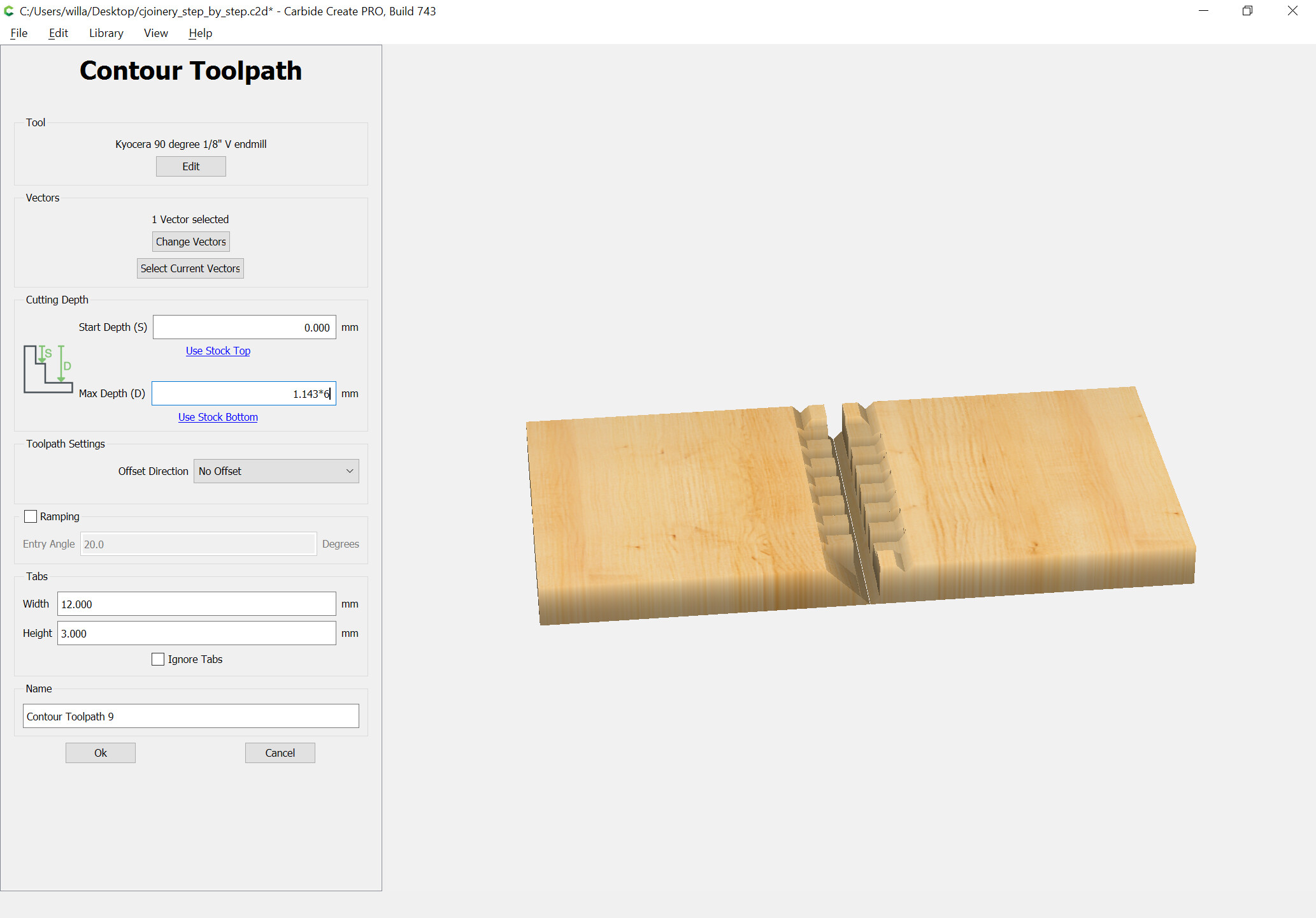

There will be two separate sets of V grooves:
  • two sets which run the full height of the joint
  • two addition sets at the edges of the joint which clear the miter at the ends
One, at the bottom of the joint is obvious:
Or would be if the stock was the same size as the parts:
The other paths of this twain are:
Next, determine what the minimum number of passes necessary would be:
One option would be to have a different number of passes on each side.

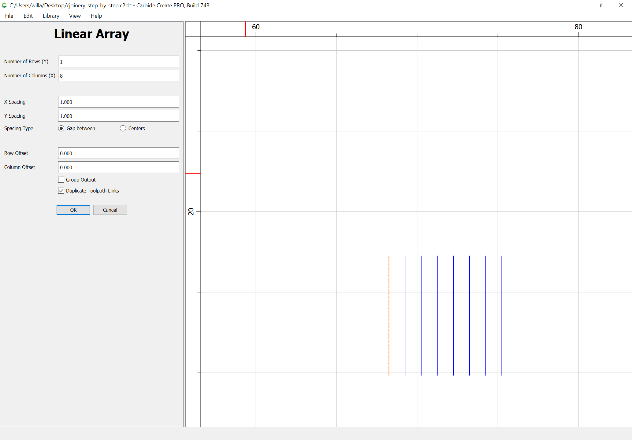

Draw in a suitable line for one cut and use Linear Array to duplicate it as many times as needed, w/ extras for origin and end points:
If need be, adjust the width of things to line up w/ stock thickness.
Then, measure the distance:
and assign toolpaths working down to the necessary depths:
Duplicating geometry w/ toolpaths allows us to arrive at:
cjoinery_step_by_step.c2d (108 KB)

Dang this didn’t work
The V-bit seems to have carved more than is shown in your pictures
You have to use shorter geometry for carving only the V at the ends — if the 3D preview doesn’t show the fingers being left, adjust things until they show.

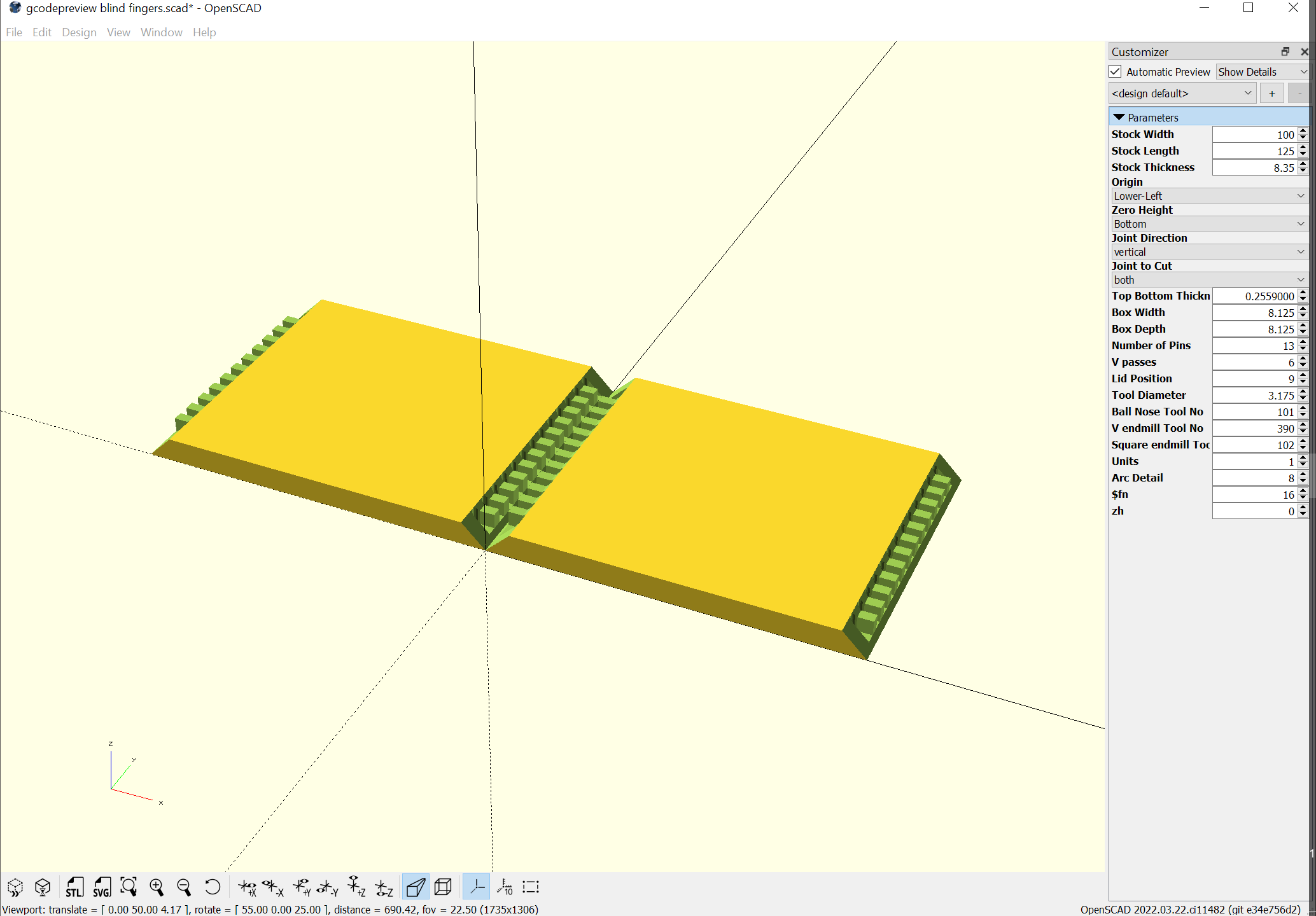

Worked up an OpenSCAD file for cutting these:
gcodepreview blind boxjoint.zip (852 Bytes)

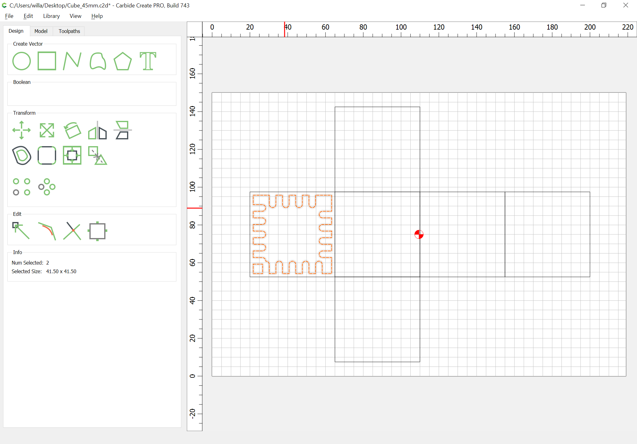

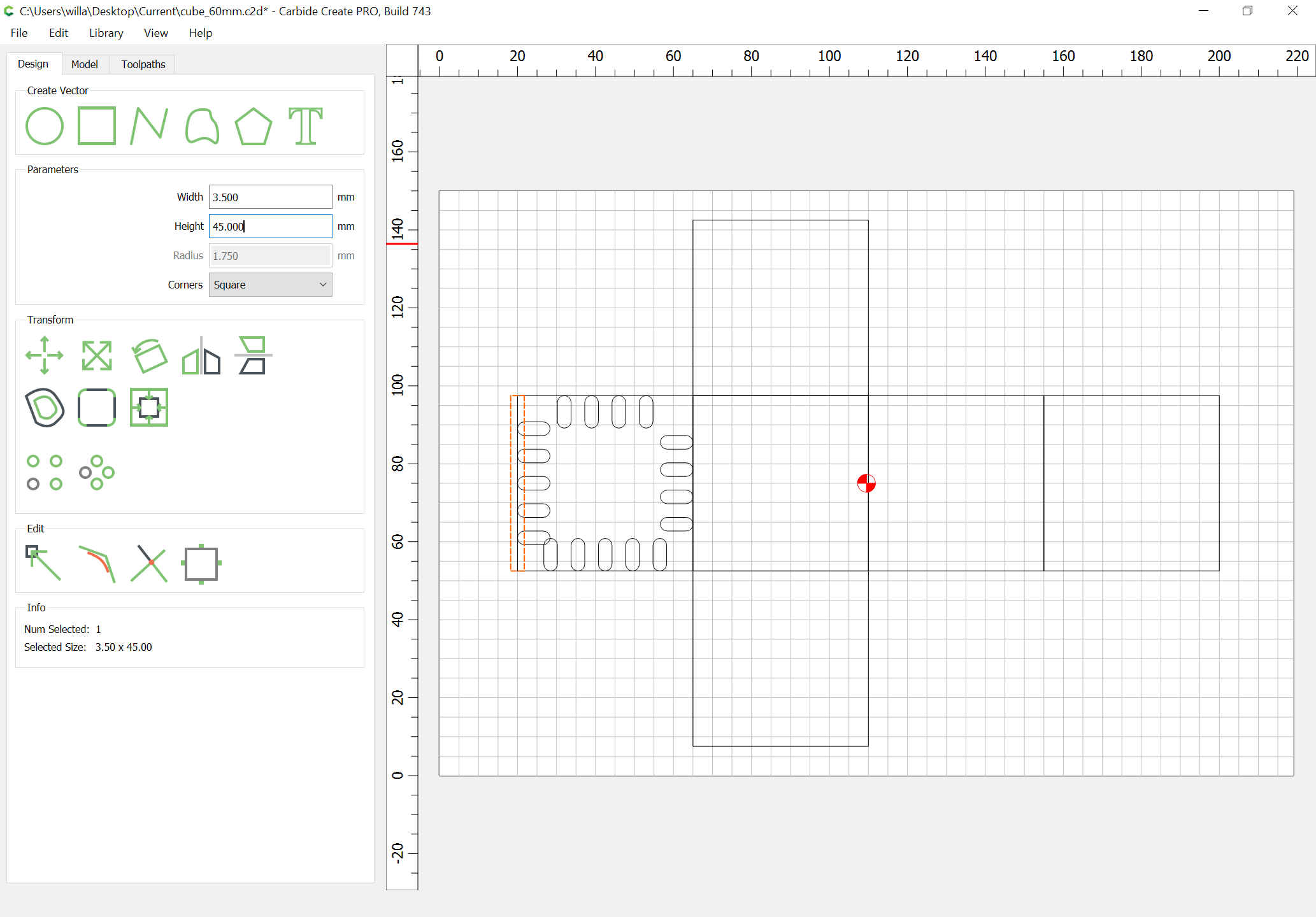

First, draw up all the squares:
Then, draw in a paired set of fingers using Linear Arrays:
(size is stock thickness x endmill diameter plus 10% or so)
Delete the extra:
Select all and group:
Select a face and align to center:
Duplicate just the geometry for the fingers and rotate 90 degrees:
Draw in geometry to cut the central channels:
Duplicate and rotate as necessary to encompass all 4 sides:

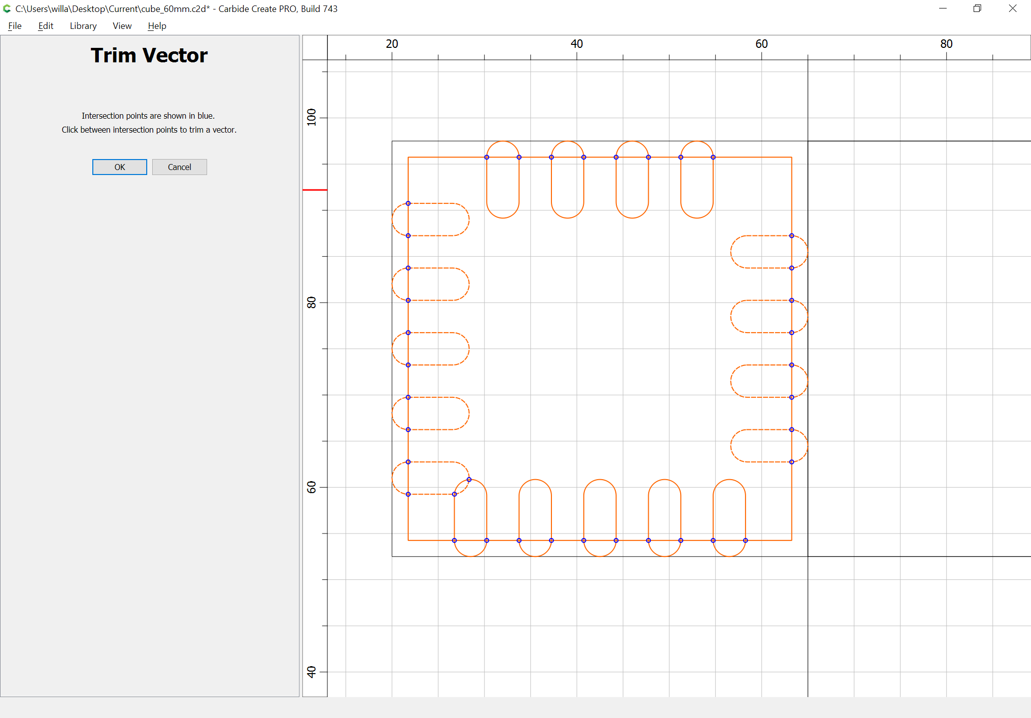

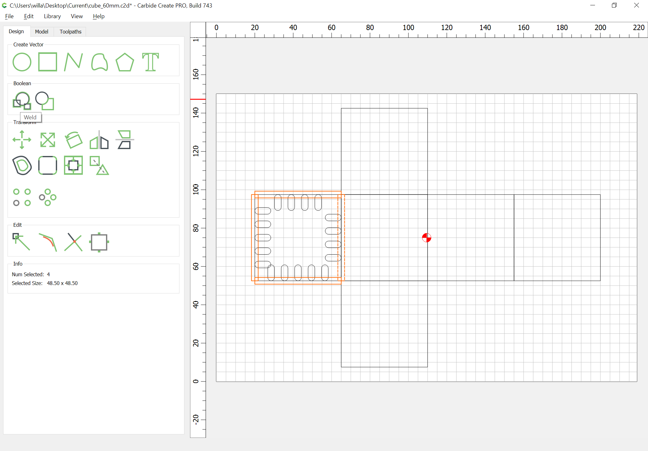

Select all four and Boolean Union:
Delete the unnecessary outer geometry:
Select all the finger joint geometry:
and use Trim Vectors to eliminate the unnecessary geometry:
Then use Join Vectors to close:
Duplicate into the center of each other face:
Select all of the faces:
and offset to the outside by half of endmill diameter plus 10%:
