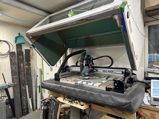

Overall been great reliable machine. I Got it to a set a forget system using mist and air and vacuuming same time in a sound proof cabinet with baffle air intake to allow air in while vacuuming out.

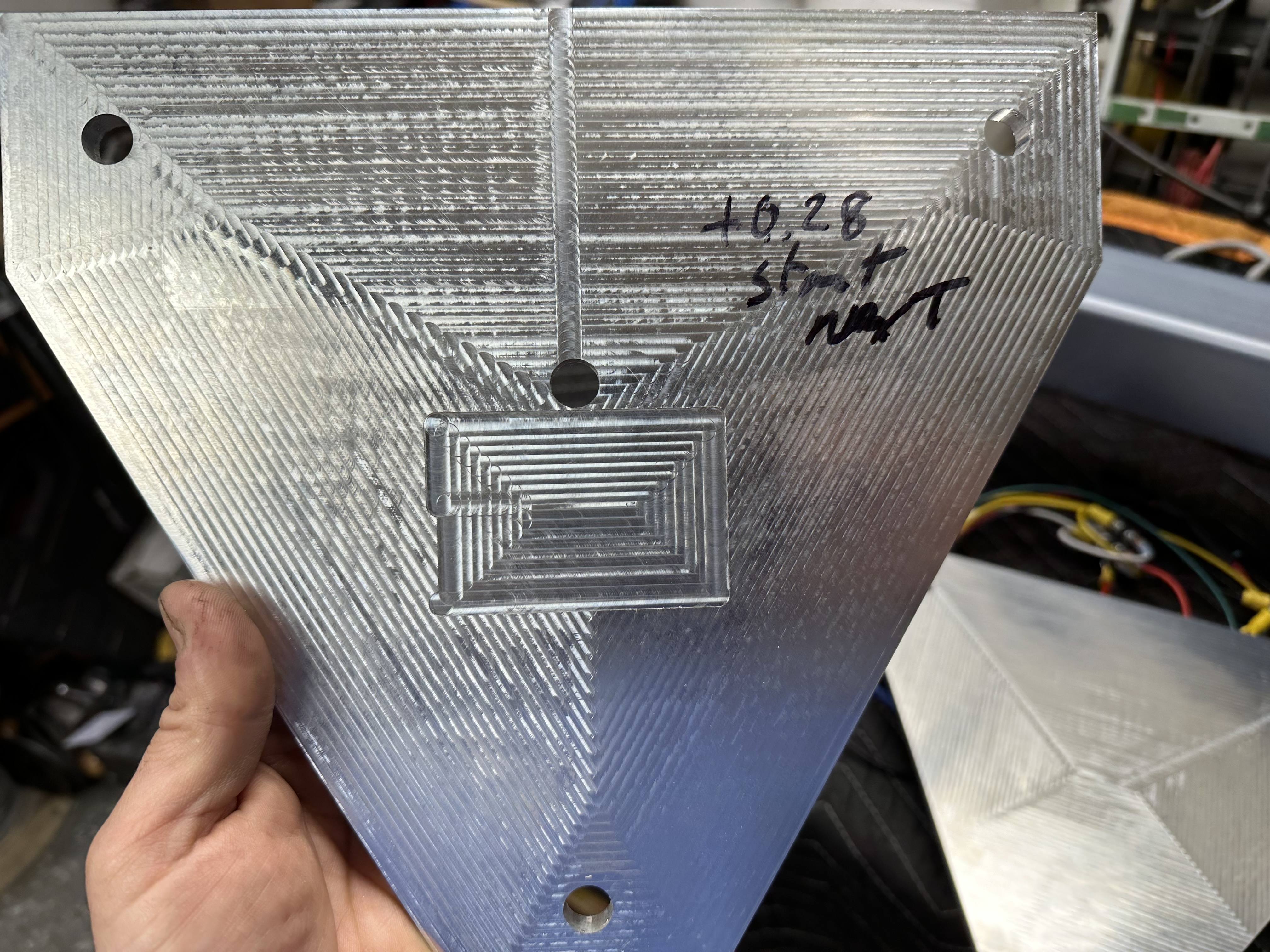

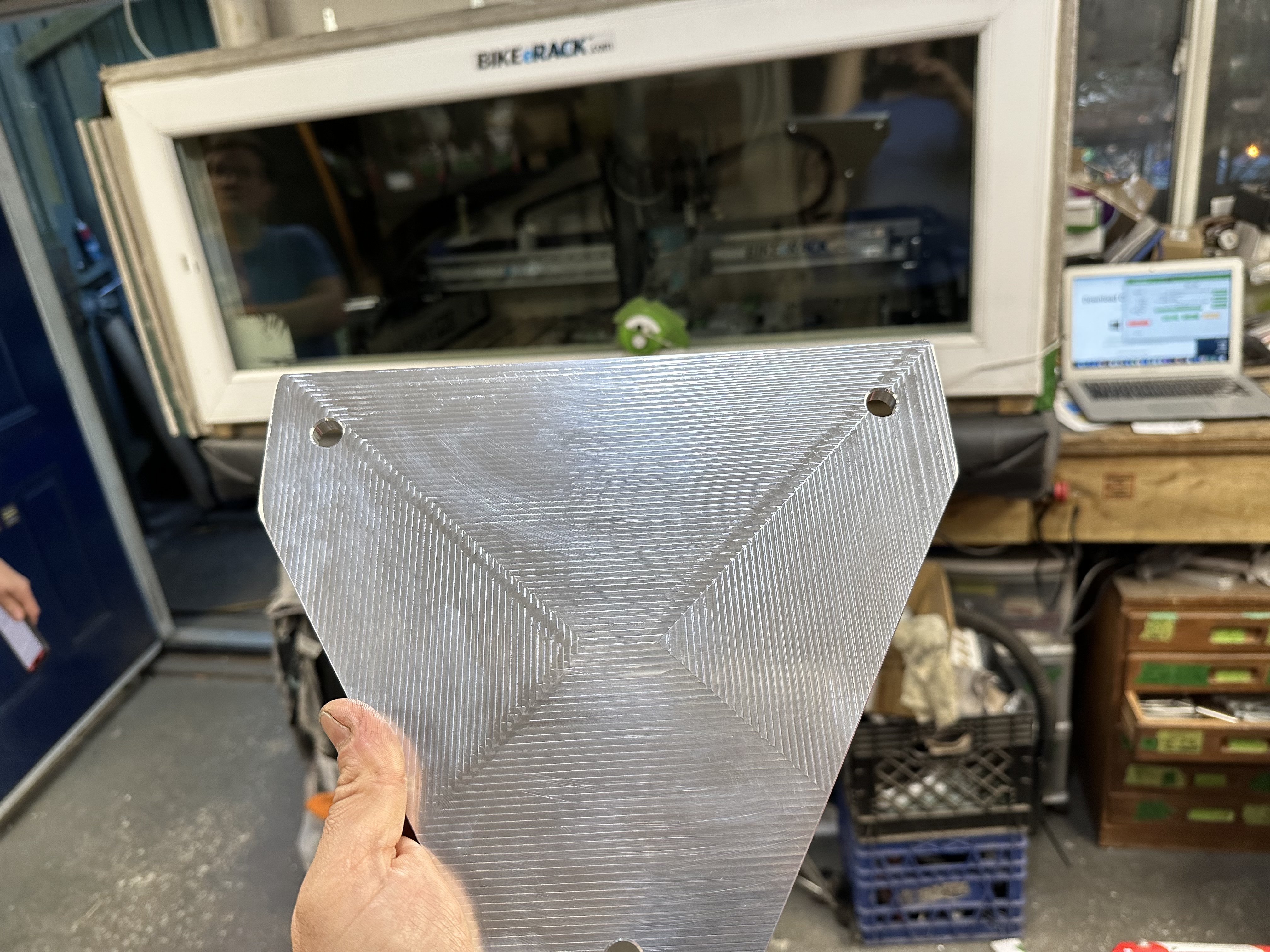

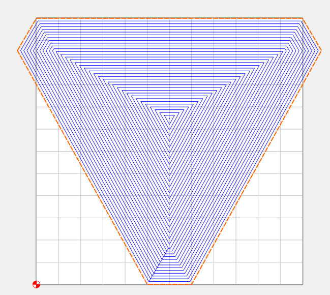

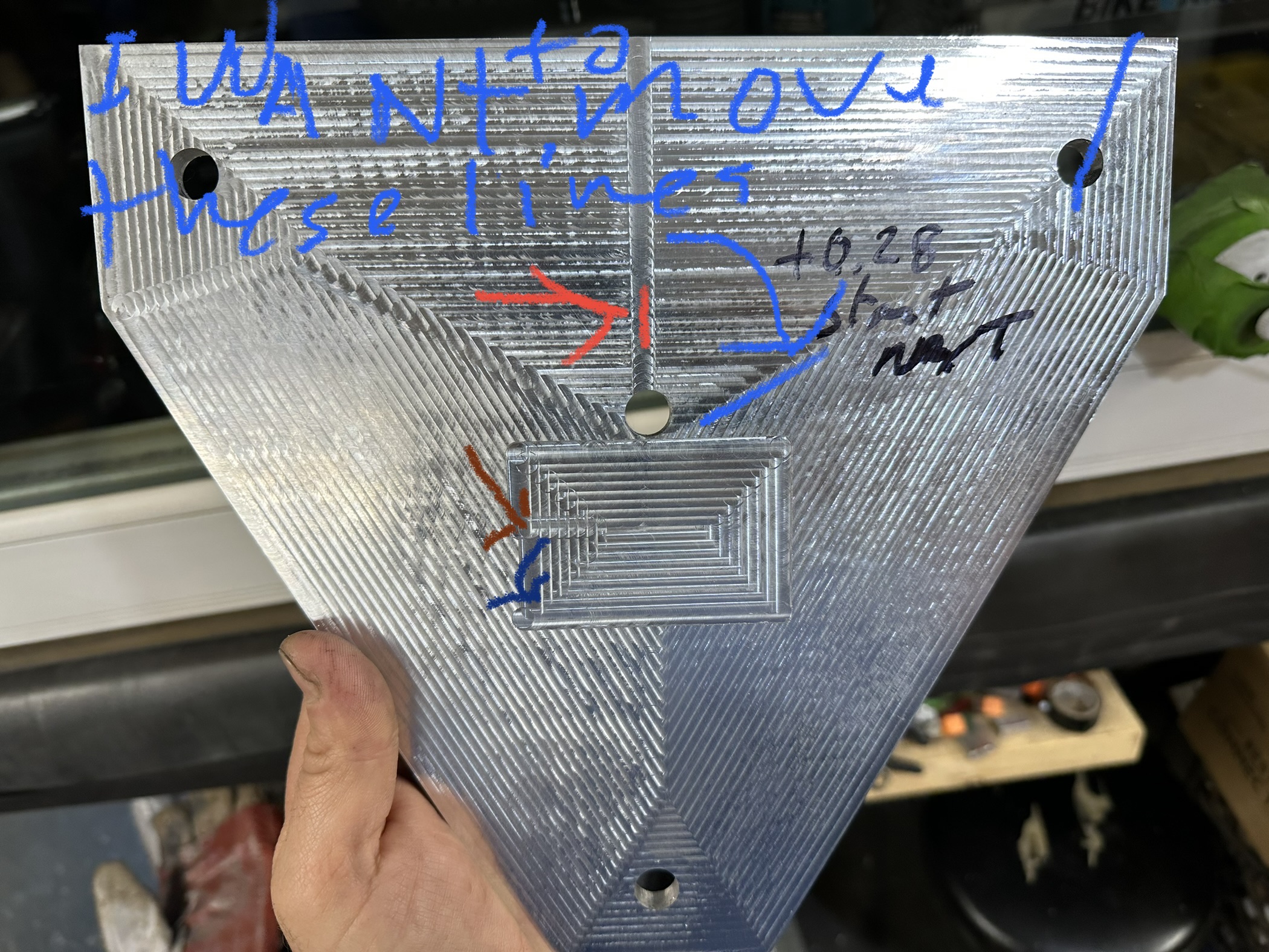

To manage some rough materials we started surfacing i call it our part by running a pocket tool path skimming the surface.

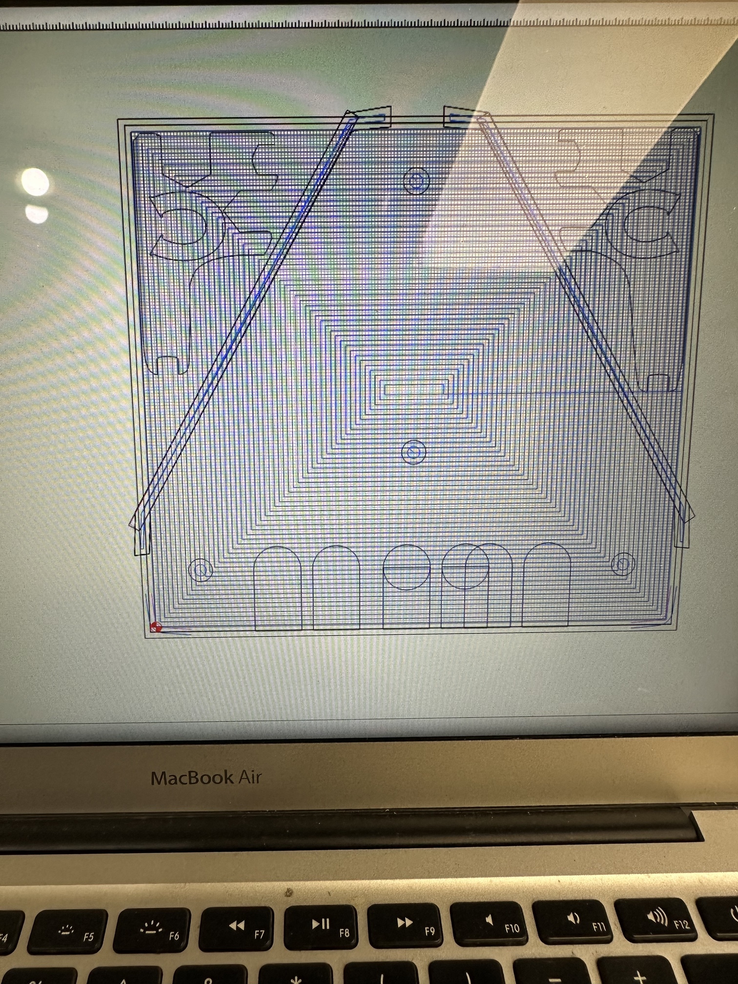

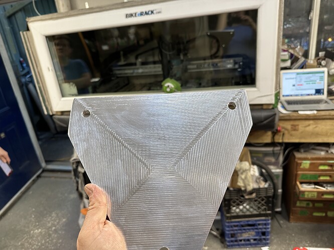

On the standard free 2 d carbide version i got a milling pattern that add the plunge path in the corner matching the pattern.
Now when i load the same program after loading the pro version i get the drop plunge actions shifting in the center or 90 degree if i do square which ruins the look of the part.
Can this be corrected manually in the gcode. Thank you.
Please look at the pics and advise. Customers waiting :pray:t2::rofl:

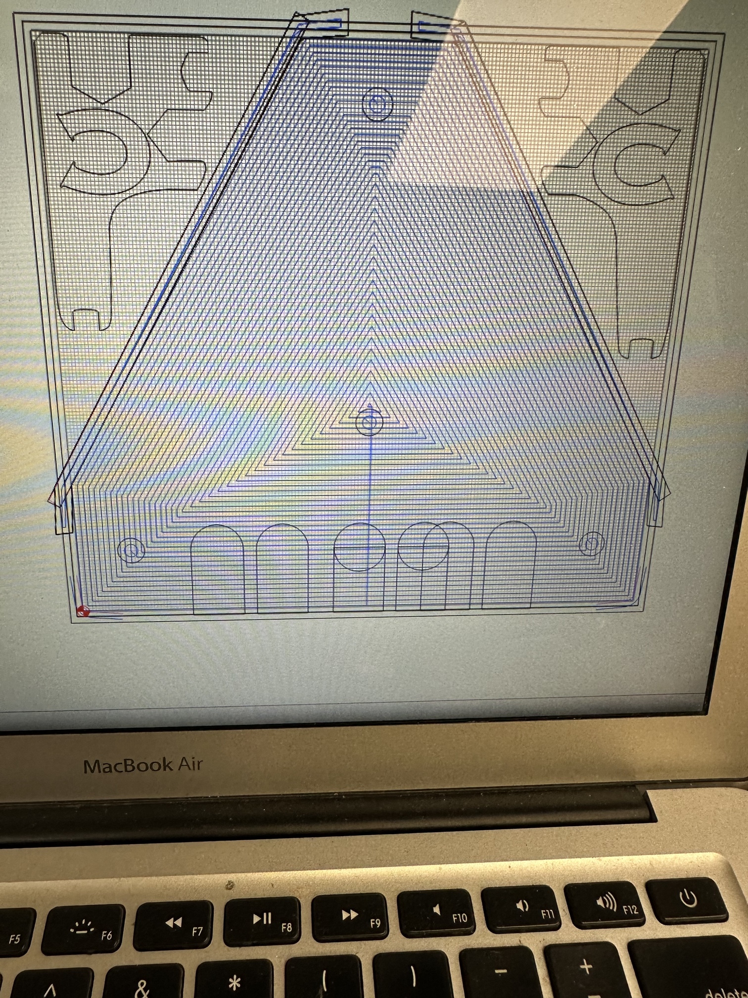

In the first picture you are cutting the shape of the bracket (Trapezoid?), where the 2nd picture you are cutting the entire rectangle. ??

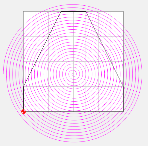

There is no way in CC to choose the starting point of a path. In Contour you can cut the vector so it starts at the start or end of the curve.
If I want a specific path shape, I draw in the toolpath & use a contour path to control it.
Here’s an example of a surfacing path.
cleanup_CC_6x6

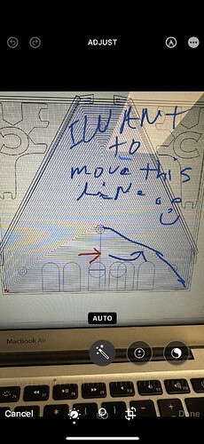

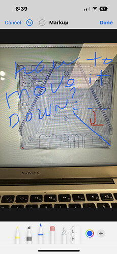

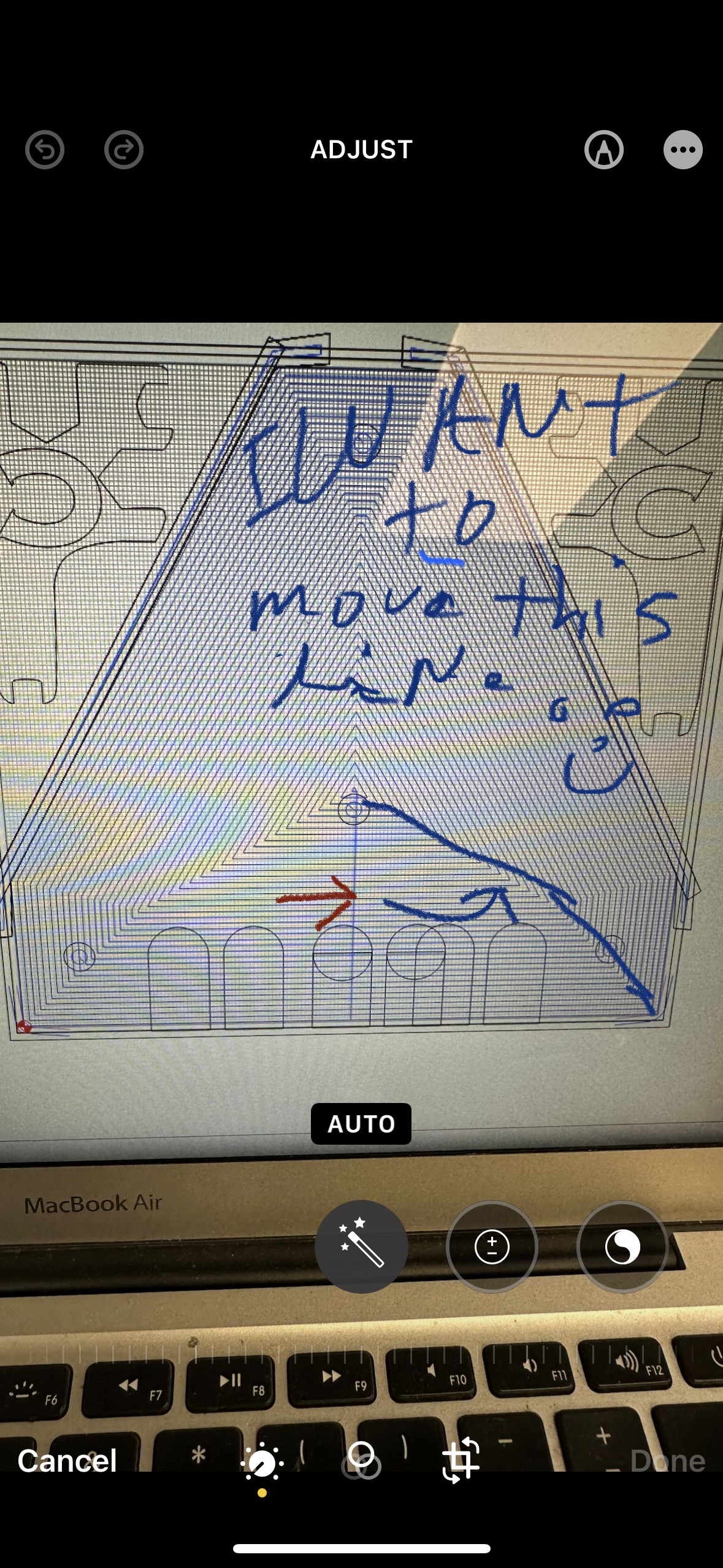

Nevermind the difference in pattern. I need to get the line out of the middle of the pattern on any of the two. I tried the trapezoid one because it save time since its following the actual shape of the part. Other one is generated over the hole stock size son it’s longer.
After i tried the tool path following the part you can see in the center that i tried my original one and it shouted the line 90 degree to the side instead of following the diagonal shifting point like it did with the free version of carbide. This happen after i loaded the pro version as mentioned.
I really need to get this blue line to go back in row :roll_eyes::upside_down_face::slightly_smiling_face: so i can resume production.

Unfortunately, CC is going to choose whatever pocket pattern it wants to.
I think it just offsets the outside shape inward, reverses it, then connects it up.
I might just create a curve like this, and eliminate the lines altogether.

Hi Tod. Thanks again for your inputs! Decided to try reloading the older version 652 and it all came back to normal.
When i find time i may try to make my own with a contour tool path like you mentioned!

I see the difference now. The stepover occurs in a different place. They must have changed the algorithm a bit between versions.
If you want the corners in the path even, then try making the boundary used for cutting even.
It’s just doing an inside offset of your vector, so if the corner on the vector is chamfered equally the pattern will look nicer.
Wow thank you Tod. That is very helpful! This last one you drafted may be perfectly what i need to be able to do the hole part in one go and look great. I could still hang on to it from above in the triangle left untouched. I am trying to press it down so the natural bow in the 3/8 by 10 stock is flattened to get it all in a 0.015 pass. If i don’t sometimes i need to surface a second pas to get it all.
