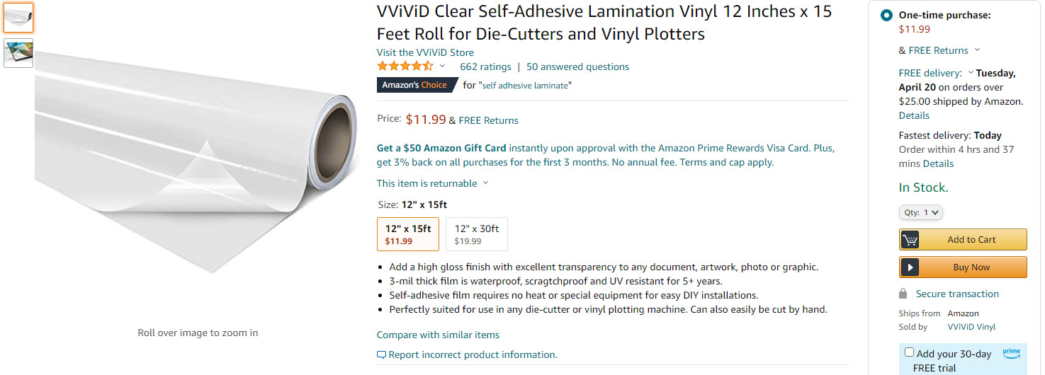

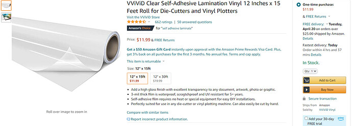

Thought i’de try something different. Bought some of this on amazon and i like it. Adheres well and easy to install and remove. Greatly reduces fuzzies when cutting and when spraying greatly reduces over spray. Think ill switch from using the Tyvek house wrap tape.
