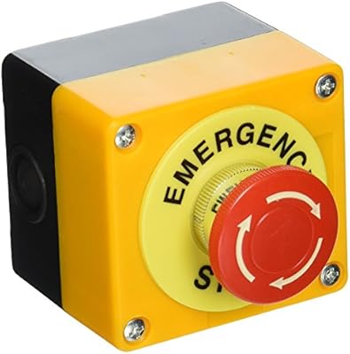

Not really a tool, but an E-Stop switch is a must. This would work well.

I agree. being able to kill power to both the router and CNC at the same time is a must for the safety of you and the machine. It will likely pay for itself the first time you have to hit it.
