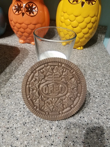

Oreo cookie top made out of Walnut going to use it for a child’s jewelry box. The original idea came from vectrix website.

That looks awesome! What program(s) did you use to model that? I have something similar I want to make. I have vcarve and photo vcarve…was hoping photovcarve would turn my picture into something usable but it looks more like an etching than a relief carving. I’m trying to figure out if I can make a relief carvin without modeling the whole thing from scratch in a 3d modeling program.
I use vcarve Pro (old edition). There is no 3d modelling in that cookie, just a picture from Google that I vectorized in various carve. Then I did a v carving on it.

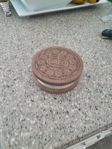

The piece of maple has been milled out for the creme filling.
