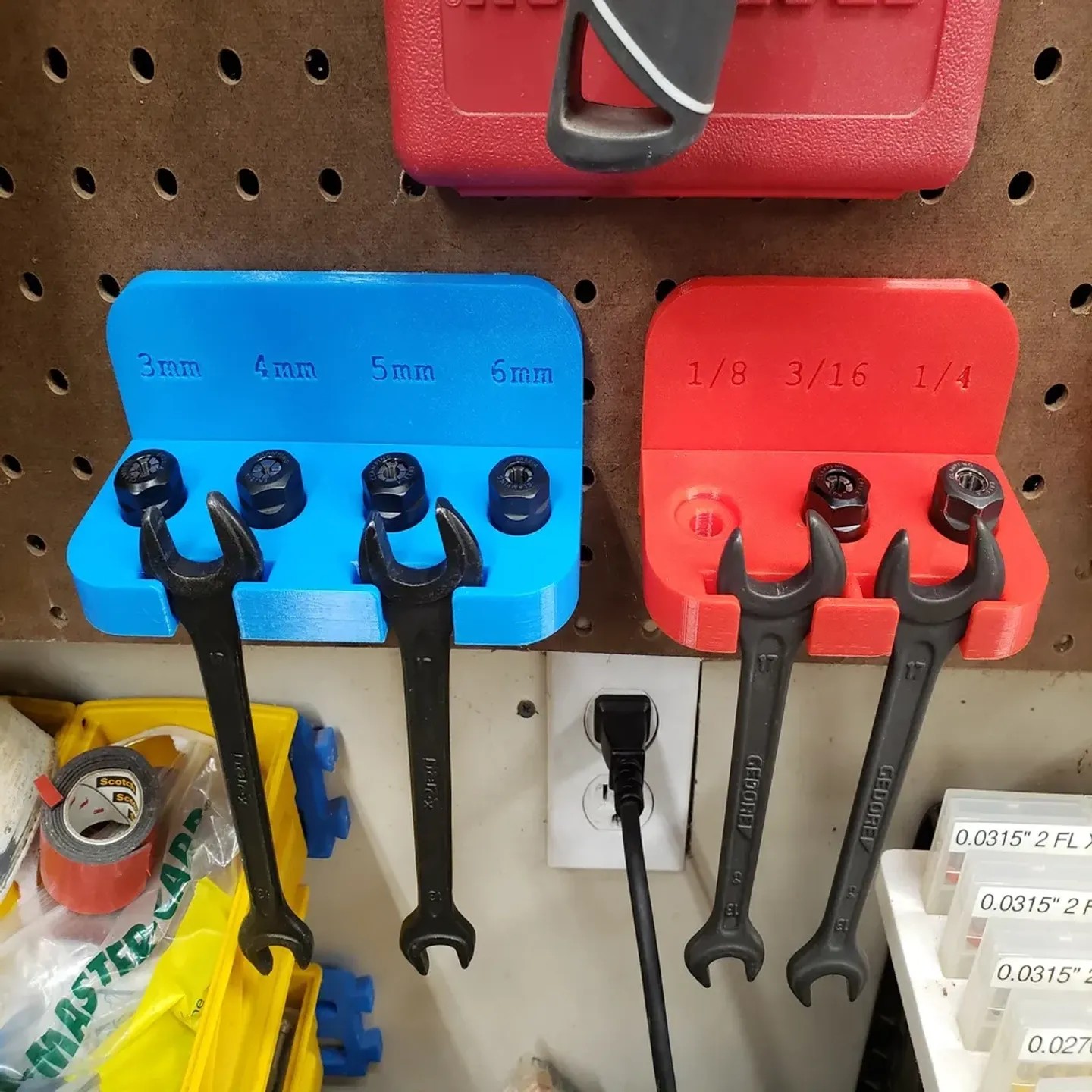

I have a couple of sets of 13mm - 17mm wrenches, and at least one came with my ER-11 spindle, and I just like them. They are not fancy, just grab them and go. Doesn’t matter which one goes in what hand - just turn it around if you have the wrong side out. They are the only wrenches I have that are double-sided open end wrenches, so it is easy to find them if they are not in their holder. (Note: They should never be out of the holder unless they are in my hands.)
Nice setup and racks, I think the 3mm and 4mm collets are swapped! :face_with_monocle:
