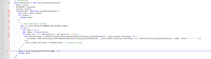

Just to let you know I found that if I leave the console open too long it goes into a stutter as well. Very odd. Closing it resolves it but definitely something someone should be aware of.
Thanks again gibs, I’m using Edge and I didn’t quite find line parity but I just searched down what you were up to and replaced all of the comment M6’s and commentMatcher’s. I’ll give this a test in a bit. Glad that these are pretty straight forward shifts and hopefully they will implement them in their next update.
Made an issue, and pull request as per your guidance. We will see what feedback I get and if there are unit tests to be added somewhere.

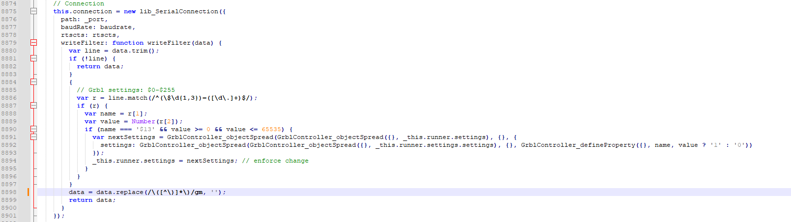

I thought about it some more and a better approach would be to just insert data = data.replace(/\([^\)]*\)/gm, ''); between line 250 and 251 of GrblController.js. By doing it this way, you can still pass variables to the terminal when using macros with inline comments. This will also stop the SO5 from locking up if you were to manually type a inline comment into the console. No other changes are needed with this method. I have tested it on my SO5 and everything seems to be functioning as intended.
Example change done in index.js line 8898 found in C:\Program Files\gSender\resources\app\server for v1.2.2
You could also just replace return data; with return data.replace(/\([^\)]*\)/gm, ''); instead of inserting a new line.
I felt like there would be single point of egress to the controller, but I am not familiar enough with the code base or how you do serial I/O in javascript to have found it. This looks like what I was looking for.
FYI to all - I forked the gSender repository and added in the discussed change. I also added the SO5’s product ID to the recognized device list. It will now show up as recognized when connecting.
You can find a patched build of v1.2.2 for windows here:
Thanks Tanner. Appreciate the time and work you have put into this.
I’ll retract my PR for gsender. Please add your own so that they might adopt the changes in mainline.

FYI to anyone interested, thanks to @Gibs efforts, the 1.41 version of GSender should not send the inline comments and better work with the S5.
Giving it a whirl this afternoon. Appreciate everyone coming together to troubleshoot and showcase their strengths. Thought I was an edge case and finding it both effected more of us and finding a patch, and contributing a solve, AND for it to get rolled in. Hells yea. Owe ya’ll a beer. :beers:
