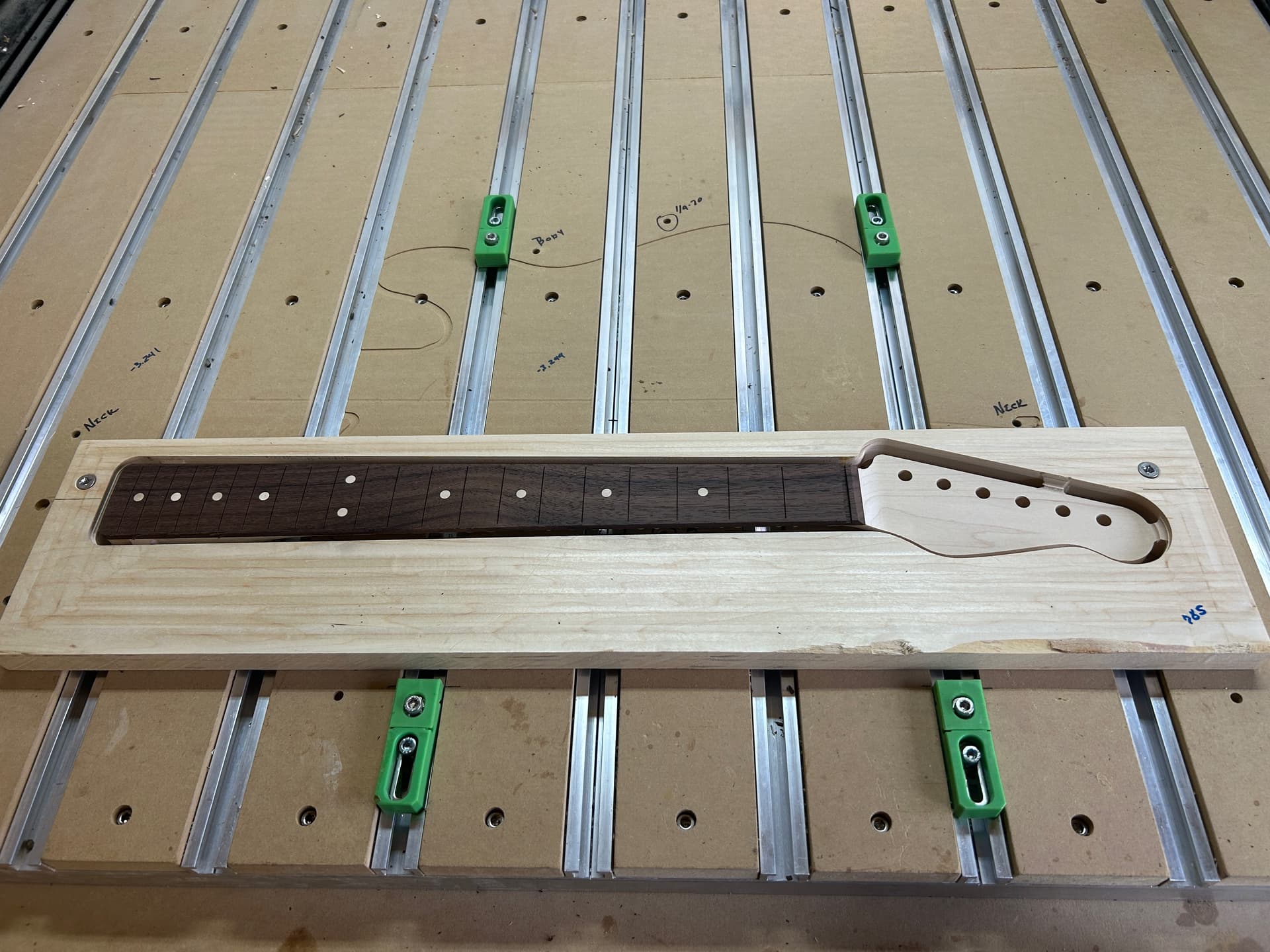

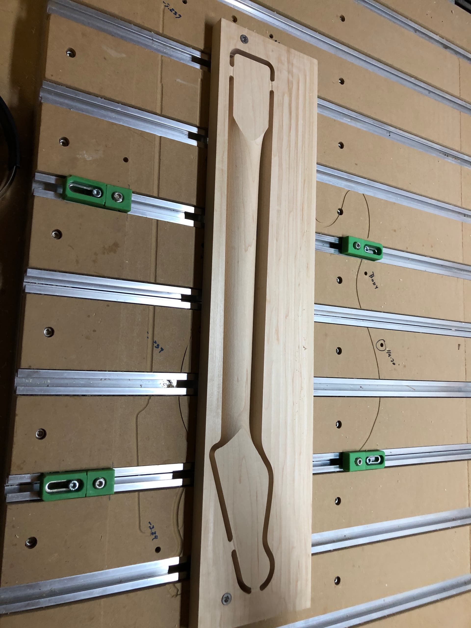

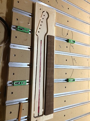

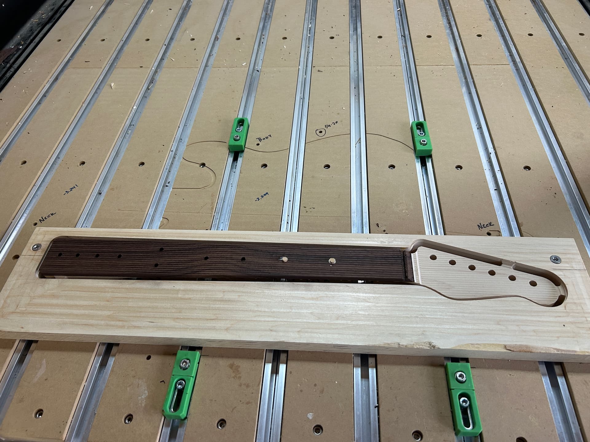

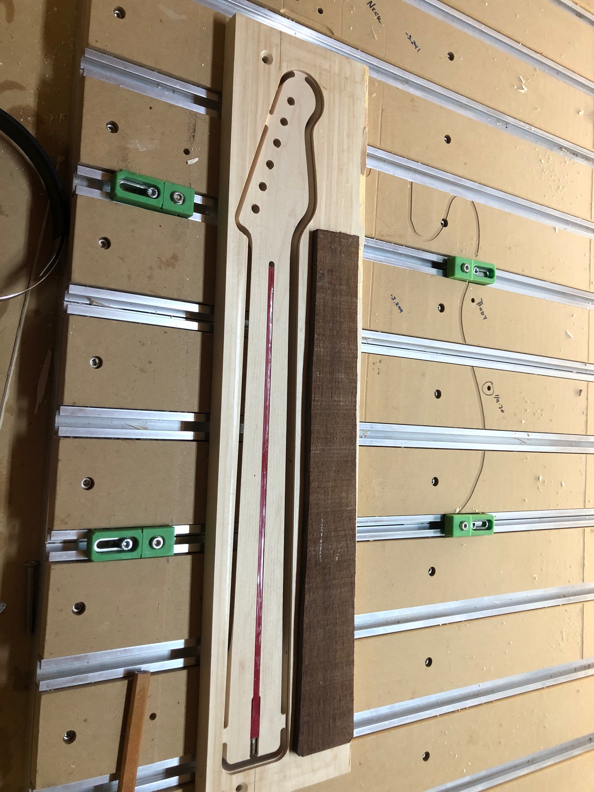

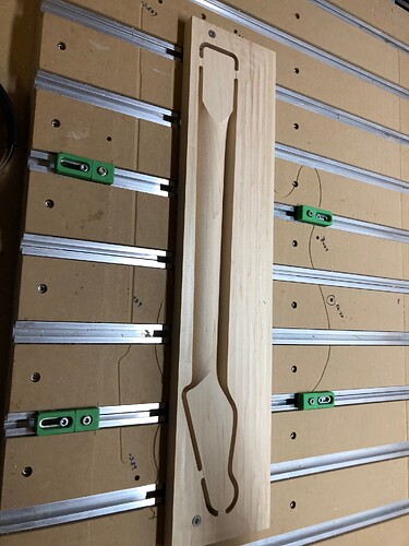

I use CC Pro, building fender type necks for now.
  1. surface both sides of the stock so they’re flat and parallel.
  2. Contour, rough and finish pass the bottom.
  3. Flip the stock, RESET XY!, pocket the body to .75, install the truss rod and glue the fingerboard on.
  4. Reset the stock thickness to account for the fingerboard, run the rough pass and pocket the dots, glue in the dowels.
  5. Finally run the finish pass and fret bit.
That’s the easy part, the rest is all hand work.
You can download my .C2D and STL for a tele neck modeled close to my '63 tele here: tele 60.zip (1.7 MB)
CC won’t save the STL in the file so you’ll have to import it for the top and bottom.
Have fun and practice on scrap. My wife said I should build a sculpture out of my practice runs…
