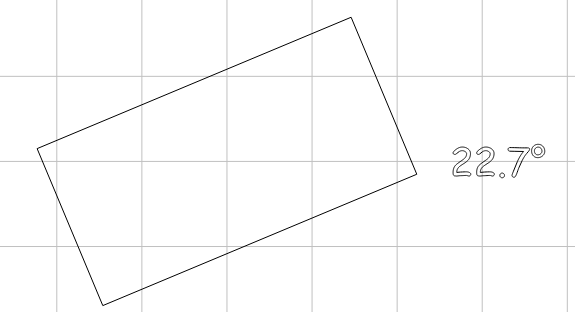

Easy way to document odd angles…
Rotate is goofy. 1) If you use the handles to rotate the object to line it up with existing geometry, it doesn’t tell you the angle. 2) If you hit enter when typing in an angle, it rotates, then when you hit OK it rotates again. ???

Annotating the diagram works to a degree, but it’s fundamentally wrong. I could rotate it more than once and then have to do the math and change the annotation, etc. It’s just something Rube Goldberg would love (for you young’uns, Google him).
The other thing that drives me a little nuts is that it’s not always easy to know which way things are rotating…Positive numbers rotate counter-clockwise…which is counter-intuitive, to my mind. I end up sticking a tail on my objects before I rotate them, so I can see which way it’s going - particularly in my current situation where the difference between width and height is 7/100ths of an inch and not easily discernable by eye. Then I delete the tail afterwards.
