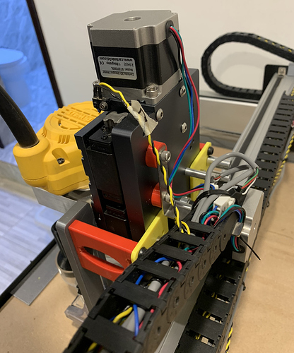

1- NEVER add the suckit boots without sending the Configuration in latest CM software to reduce the X travels , this is very important before installation .

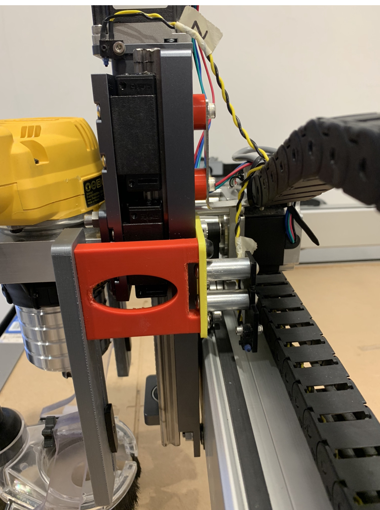

2- add or print spacers and install them to X-Axis Drag Chain Bracket that will keep good space between the limit switch screw and the dragchain for smoother move .

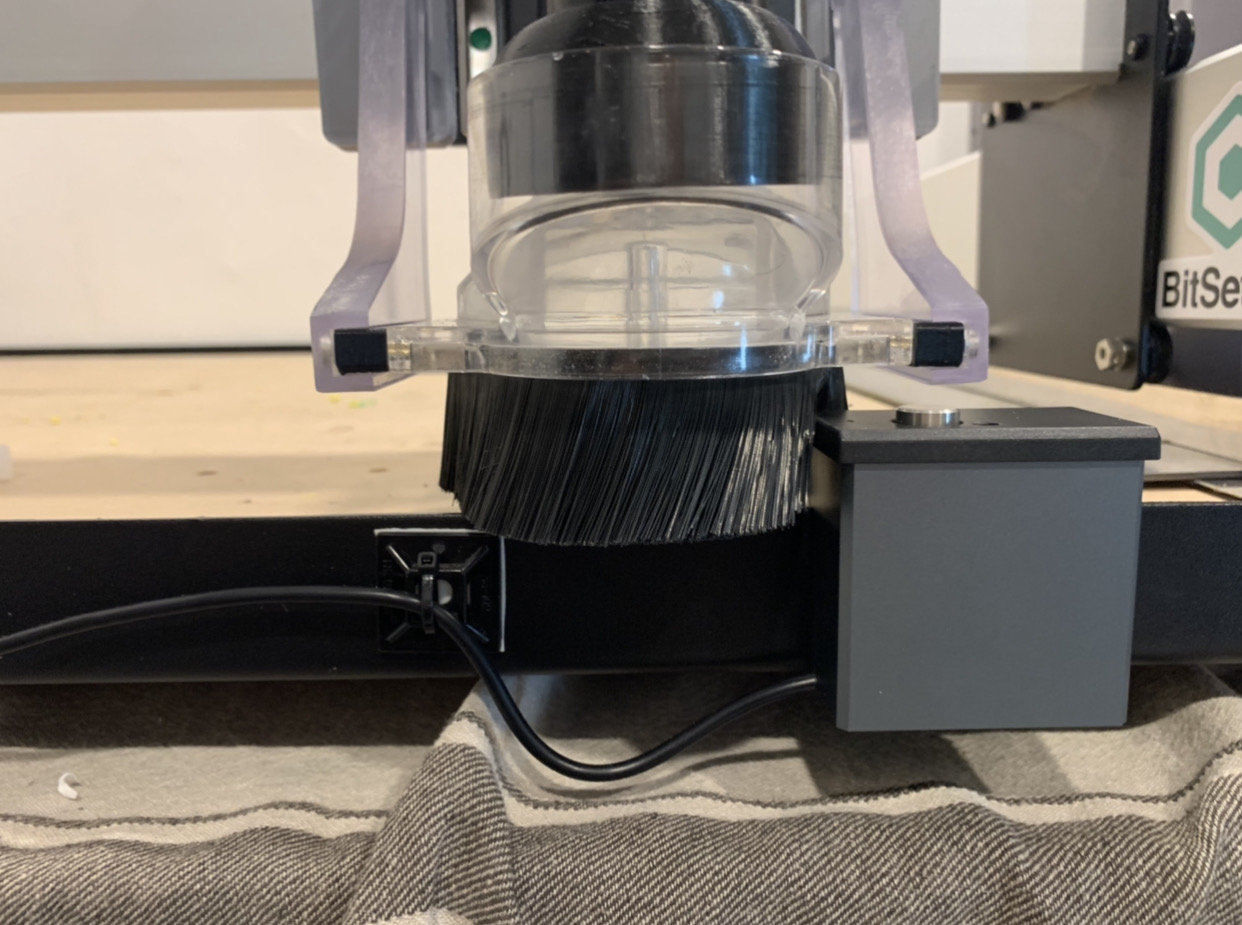

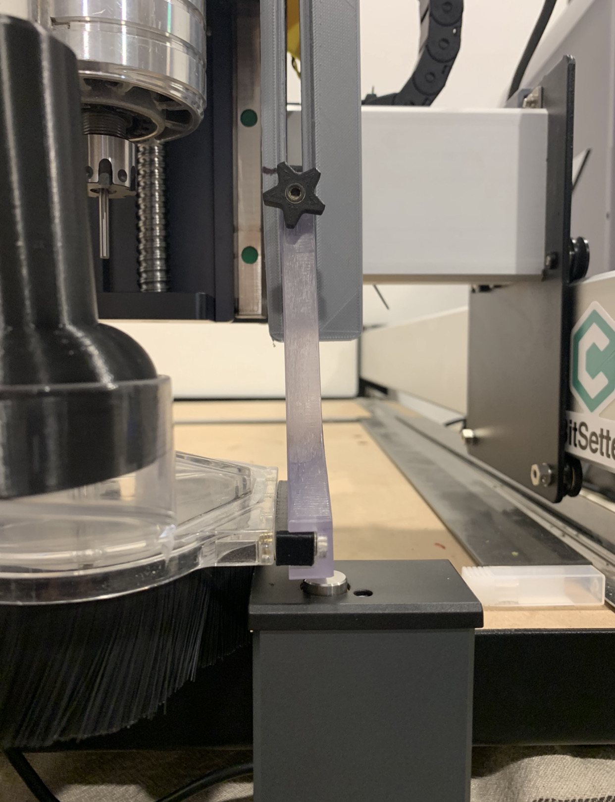

3- mark the suckit boot adjusment bracket to insure that this is the end reach so we not touch the Bitsitter .

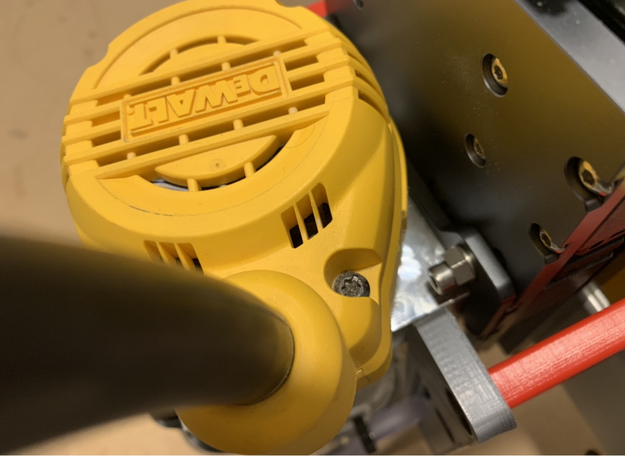

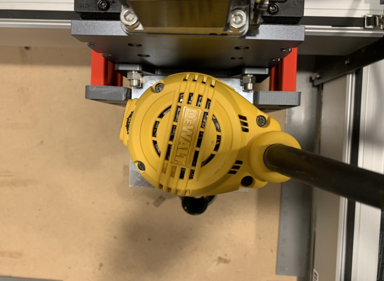

5- Install your router , For Dewalt users be carful and twist the router from the wire curve on top to avoid that Dewalt crash the bracket while Z travel .
6- I always Keep Calibration Bit after updated to latest CM that keeps me with the software orders with the bitsetter option .

here is some pictures for my setup :
