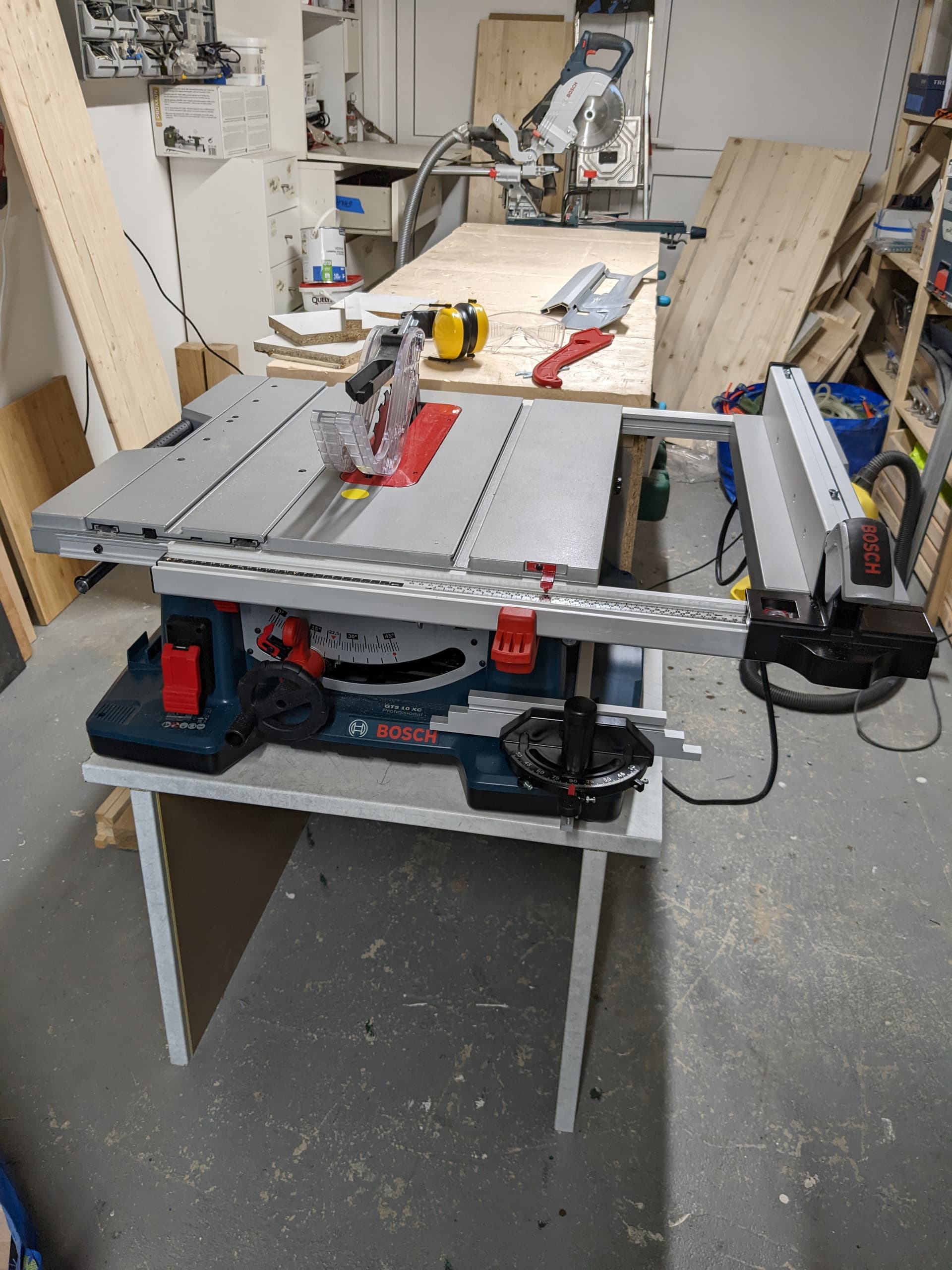

Since this thread has been documenting my journey to getting woodworking tools (based on the fantastic advice from everyone) I figured I would post the latest addition : a table saw, at long last.
I’m team Blue all the way now, apparently.
I have been very happy with the Bosch Pro track saw I got last year, and to be honest I have been postponing getting a table saw because it looks so freaking dangerous, but I guess I’m ready now and I’m still counting my 10 fingers before I use any of these tools, so I hope that me being very risk-aware will help me keep all of my fingers.
It cuts beautifully (after spending the best of an afternoon tuning everything), and I just found out that the extension on the right which normally serves the purpose of cutting larger pieces, can also be used to accomodate a router table insert, so I know what my next project will be.

Ah nice, better choice than the GTS10J IMHO too (I bought the 10J).
I’ve not put the top guard back on the blade on mine since making the sleds, I occasionally think “great, I’ve got a cut I can use the blade guard on” and then have to take it off again for the next cut. Obviously the riving knife stays on, always.
I picked up a nice 80T blade from a local tool supplier and the cuts are good. You may find that the T slots are Bosch sized not normal sized so when you buy a set of feather boards (well worth it) you won’t be able to use their standard fixing hardware, I ended up printing a new set of T slot inserts, which are the full length of the feather boards and easier to use anyway.
If you’ve not made your crosscut sled yet, the five cuts to square method helps preseve sanity https://www.youtube.com/results?search_query=five+cuts+to+square
Also,
It’s worth checking out which local tool shop has a competent blade sharpening service, the more expensive blades last much longer if you clean them and sharpen them and the cut quality is way better with clean sharp teeth.
I use this to get the resiny goop off the blades (and CNC cutters and garden tools and everything else) https://www.amazon.co.uk/Trend-CLEAN-500-Cleaner-532ml/dp/B003OC35MQ
Thanks for the tips @LiamN. A crosscut sled is definitely on my todo list also.
I agree on the benefit of using blade cleaners, I’m not sure what kind of nasties are in there but just soaking my blades a few minutes and then using a toothbrush them makes all the resiny goop magically dissolve/disappear. I still need to find a place to have them re-sharpened though.

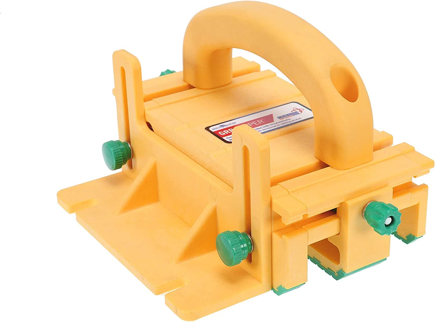

Julien,
I use the MicroJig Gripper almost every time I use my table saw. What I like is your hand is far above the blade. The Gripper lets you control both sides of the board when cutting small boards.
Just a regular push stick is required to keep your delicate and vulnerable hands/fingers away from the spinning blade.
Most people wind up taking the guards off in the long run. You certainly do not have to but you will find them cumbersome and annoying. You have to remove the guards if you are not doing any not through cuts like grooves and dados.
My next most used accessory is a good blade. On benchtop saws you generally use the thin kerf blades but the tooth count is important. A 60 tooth for fine cross cuts. A 40 tooth combination blade for most cuts. Some use 24 tooth blades for construction ripping but I just use my 40 tooth blade for most things unless I need really fine cutting and I put the 60 tooth blade on.
I am glad you said you spent time lining up your saw because one of the most dangerous things on a tablesaw is when it is not lined up properly. The constant on a table saw is the miter slot. You use the miter slot to reference to line up the blade and the fence. There are lots of methods for lining up your saw on youtube so I will not go into that but line up the blade to the miter gauge and then the fence to the miter slot. Then occasionally moe the fence over miter gauge slot and see if it is still lined up visually and with your finger. If the fence is not lined up fix it. An out of alignment fence can lead to kick backs and burning on your wood.
If you use feather boards always use them before the blade and never against or after the blade.
Besure to calibrate your scale on the fence. Having that scale calibrated saves a lot of time over putting a tape measure or ruler on the saw every time you make a cut. However you have to trust that fence scale so at first check with a ruler until yoi are confident the reading is repeatable.
Last piece of advise is about blade height when cutting. The best cuts are when the blade is cranked up high. However that is the most dangerous position for the blade. You want at least a single tooth height above your cutting surface. The reason is exposure. With the blade up as high as it will go you are more vulnerable to injury if you make a mistake simply because so much blade is exposed. With the blade higher also increases the risk of kickback because again the amount of blade spinning exposed and physics of the spinning blade.
So give a quick check of alignment and blade height and proper safety equipment before every use and specifically after a period of time not using the tablesaw.
