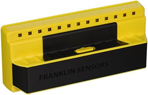

I purchased the Franklin Sensors Prosensor 710 earlier last year and it works soo much better then my previous stud finder. Easily one the best tool splurges I have done. My house is built out of drywall and wooden studs and this works great. It does not detect wiring, only studs.
