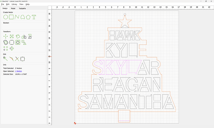

I want to produce a small Christmas Tree ornament with names. Each time I think I have the correct position or bit (.050 ball nose) it still comes out with chips or the lettering is too small. Such as the E where the middle part will break or be too small. What type of wood should I use, and what bit would be best?

A good way to start would be to offset to the outside by endmill diameter plus 10%, but the geometry needs to be edited:
or instead, use Trim Vectors:
OK
Select all the open geometry:
Join it using Join Vectors:
Yes
To this same sort of editing for any unjoined geometry:
Then use Trim Vectors:
Delete the added geometry:
Join Vectors
Yes
Select everything and offset to the outside by endmill diameter plus 10%:
Deselect the outer geometry:
and delete the small interiors:

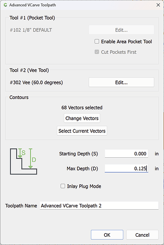

Then assign an Advanced V carving toolpath:

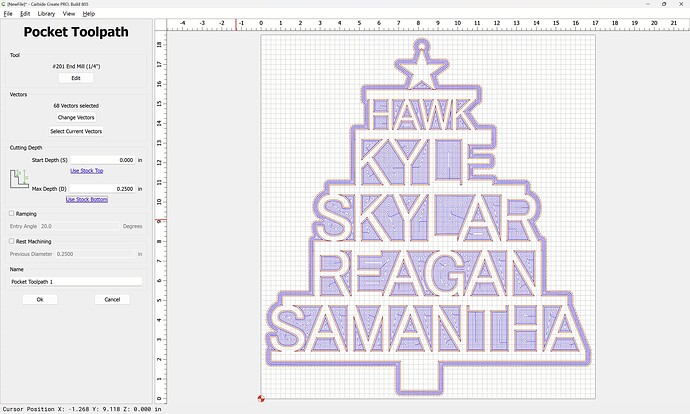

Then assign a pocket toolpath to remove what is not wanted:
You will need to use a workholding technique which keeps the parts in place, or you will need to reduce the depth for the pocket and add tabs and then finish with an outside Contour.
