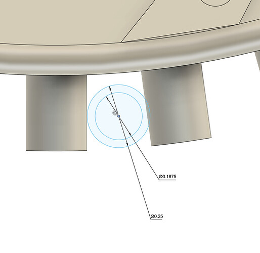

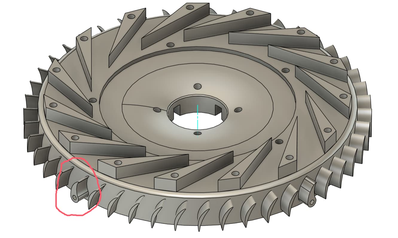

I am working on another jet engine part called a diffuser.
It has a feature that I can not reach with the bits I have.

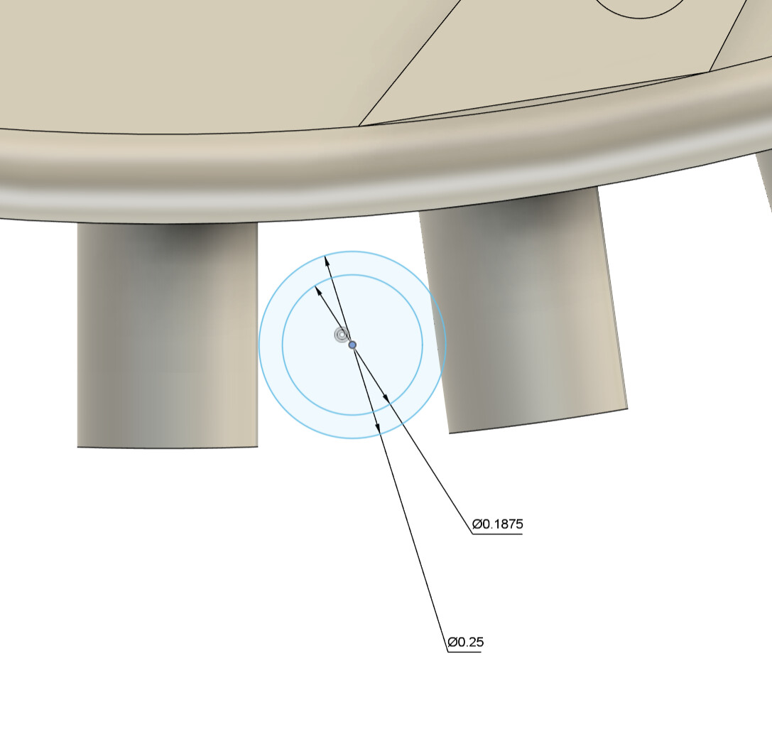

Here is the profile I am having a problem with.
It’s pretty tight between the features.
This is a sketch looking down on the blades to see what fits.

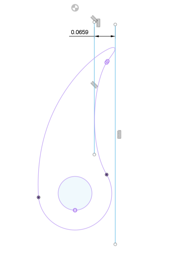

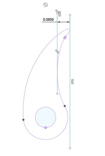

I was thinking a 1/4" round end mill on a 1/8" shank. That would give me .062" of the .0659 I need to cut, but I have not found one. I think that would just fit.
Suggestions ?
EDIT: I guess I am looking for an Under cutting end mill. Not cheap for a science experiment.

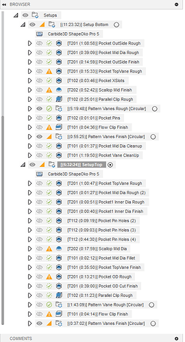

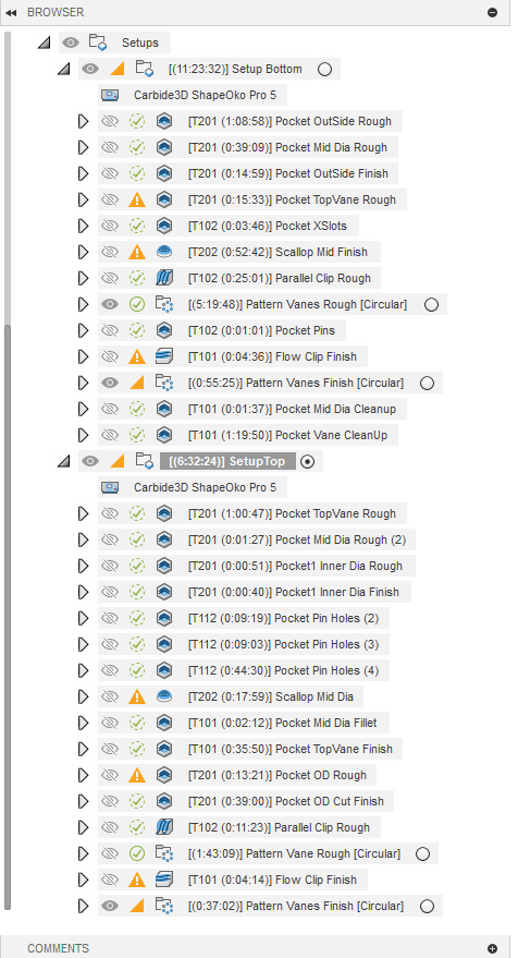

Here is the operations list. I had to learn to use Patterns of operations to make this happen in theory,

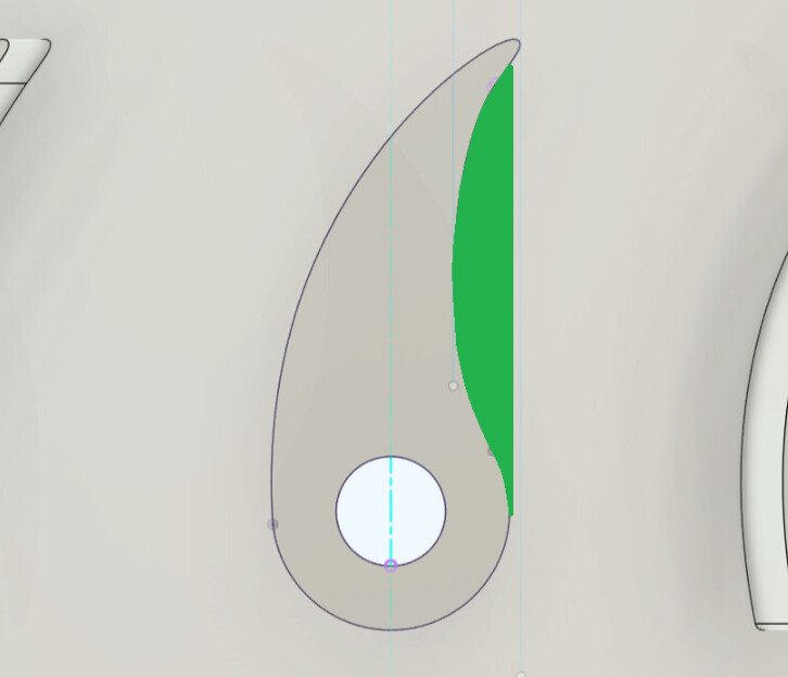

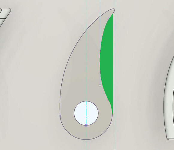

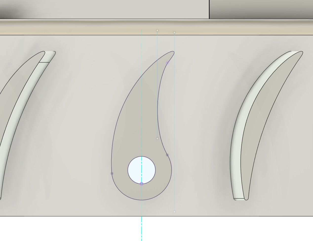

Jim, I’d tend to do the part straight two-sided, then hand-machine (multi-axis compliant biometric feedback-controlled mechanism…) the shadowed part (green here) of the teardrop fins with a rotary hand tool (Proxxon or such)
At the Reynolds number your wooden mockup is likely to operate at, I don’t think it would make a huge difference… :slight_smile:
Since there is a hole for registering that, why not make a fixture to hold the part at the front of the machine in the overhang cutting area, then rotate it to make each cut, using the hole to register/lock the part in place for that cut.
Putting in those radial holes themselves is a whole 'nuther aspect. I think an auxiliary fixture will be needed just to machine them, if only something to guide the hand tool. From the oblique view, it looks like there are five of the “teardrop” fins? If so, they will coordinate with every third “wedge” on the upper surface, which could be used as an indexing feature.
Spot the holes using a lollipop cutter?
There are holes on the top surface (not enough) which could be used to register.
It the shadowed areas of the teardrop blades were machined with a lollipop cutter, there would be huge fillets at their base which would need to be cleaned up by hand anyway…

Yes, the radial hole in the teardrop blade looks almost exactly coordinated with the axial hole in the adjacent “wedge” on the top surface so that would be convenient.
