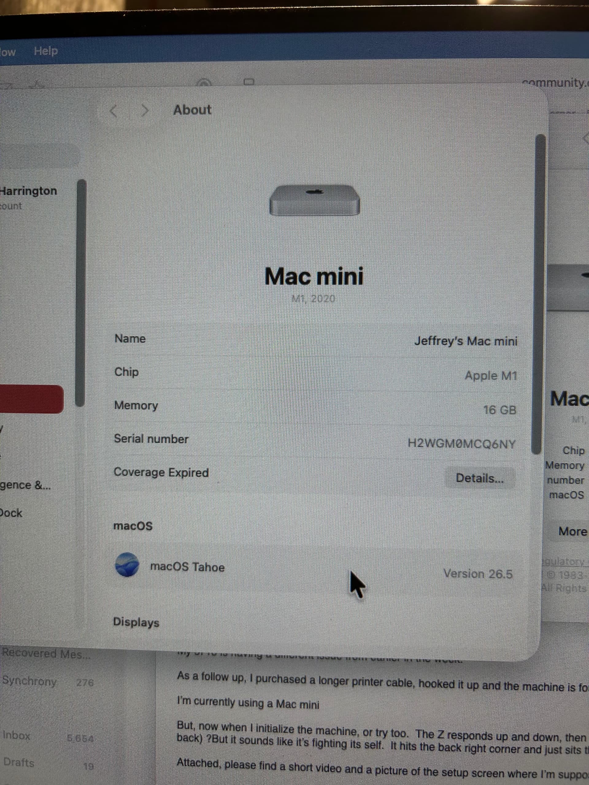

I’m currently using a Mac mini V - Tahoe 26.5
Motion 656. I’ve tried several difference builds, just incase that was the issue.
Note: I had the latest beta installed when this issue presented itself.

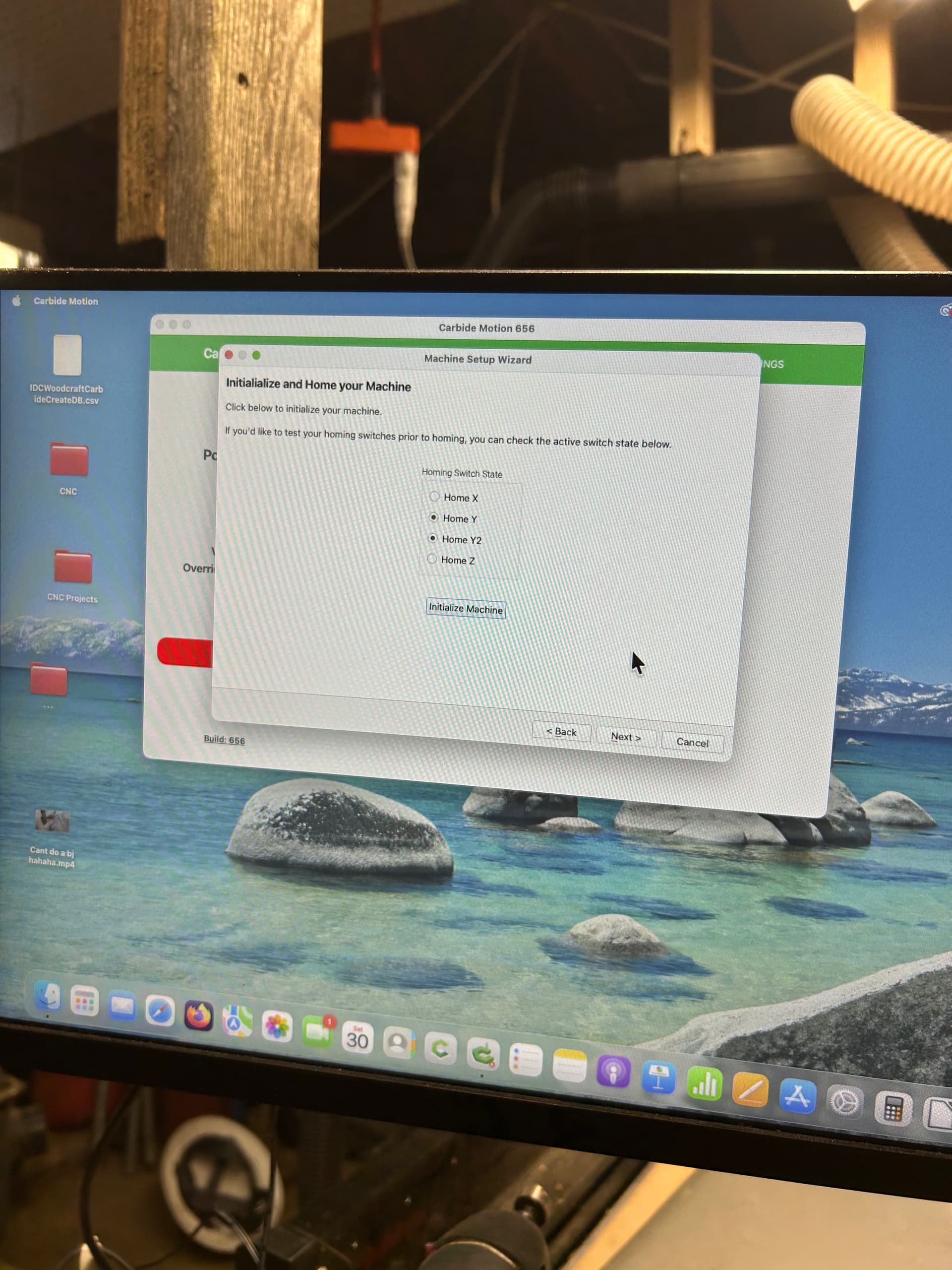

Attached, please find a short video and a picture of the setup screen where I’m supposed to test the step motors before initializing the machine.
I have unplugged and replugged each connector at the black control box, as well as the individual wires at the stepper motors on the right side.

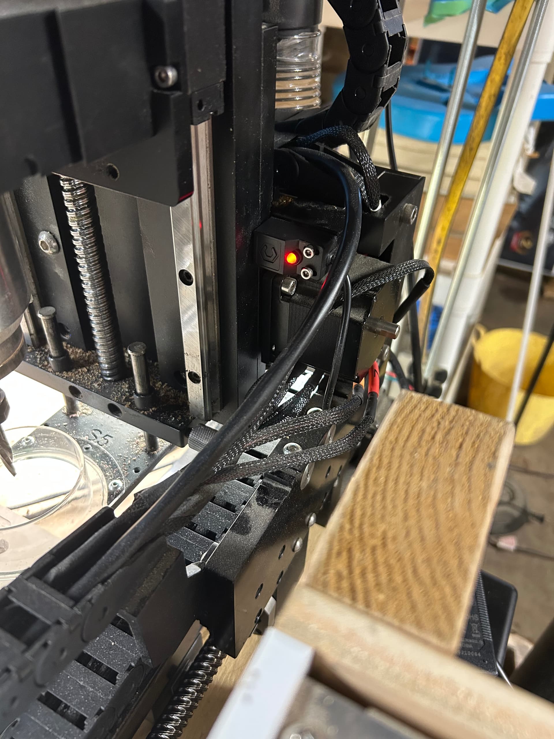

I just realized there is a red light on on the right side of the gantry, pic attached.
I was thinking the limiter switch for the Y right is malfunctioning thenI got the Error Meg below.

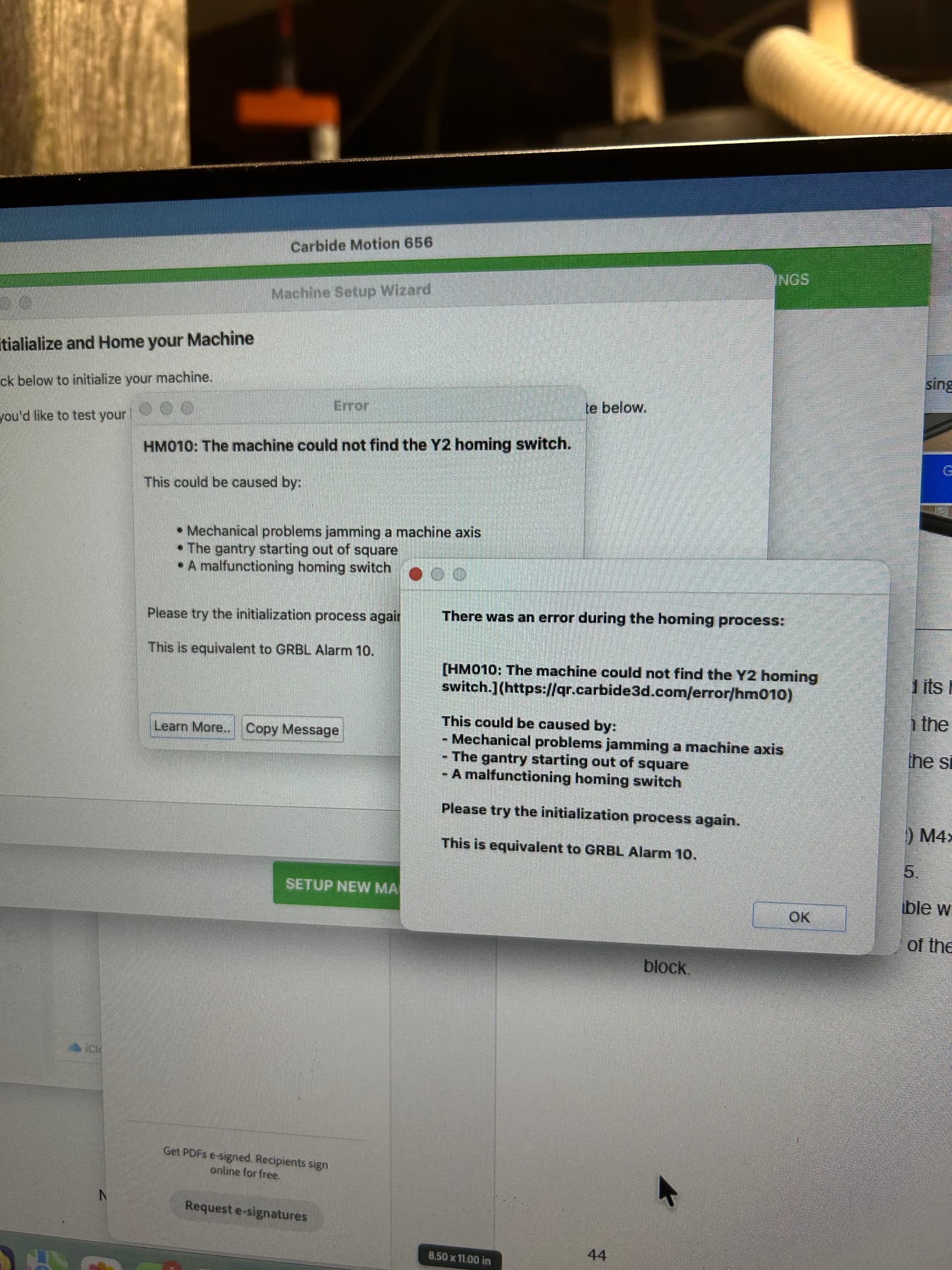

Error msg: after manually moving the gantry forward and the spindle down.
I initialized the machine and it made the humming sound then stopped and popped this error.
HM010: The machine could not find the Y2 homing switch.
This could be caused by:
  • Mechanical problems jamming a machine axis
  • The gantry starting out of square
  • A malfunctioning homing switch
Please try the initialization process again.

When homed correctly you should see 3 red LED’s, X1 (in your photo), Y1 (right rear rail from front of machine) and Y2 (left rear rail from front). Y1/Y2 are on the very rear of the rails. All of them should be on when homed. On the Wizard setup screen is where you can check the switches to function correctly. With the machine down powered, move the X axis slowly to the mid point of the Y rails (slowly), then move the Z axis to the mid point of the Y rails. At this point the spindle should be roughly centered over the spoil board. Power up machine, do not initialize yet. Enter the setup wizard again for the homing switches, you can then hold a metal hex wrench or the collet wrench next to the homing switches and the red led shoukd illuminate and it will indicate in the setup wizard as your photos shows for the Y and Y2. One of my switches was bad and had the change and all was well.
Thank you very much for the instruction.
The problem was the x limiter was lighting up but the computer wasn’t registering the condition.
Problem solved with the assistance of Oscar and the spare limiter that came with the machine.
