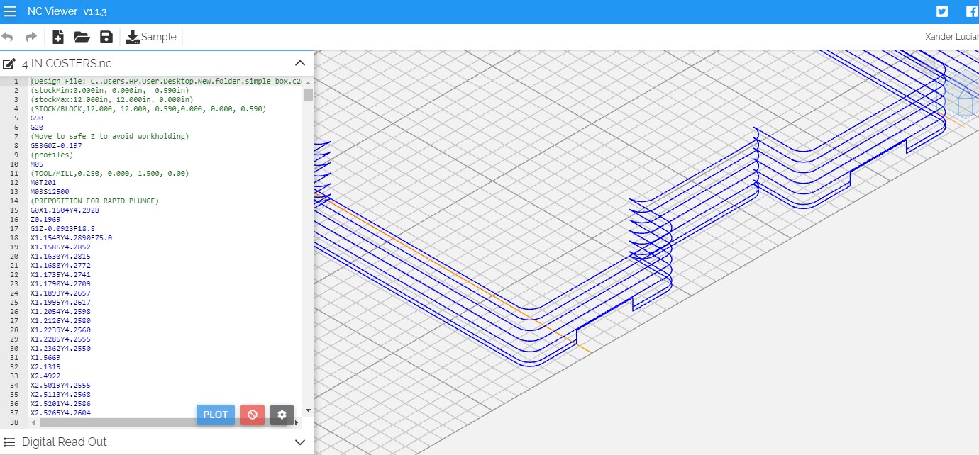

You can use the NCViewer site NCViewer to visually see your gcode output. In this case, it does look like there are tabs at least in some places.
So, I would just try a trial run with Z set rather high (so no cutting is done and watch what happens.) According to NCViewer you should see the router pop up on the sixth pass where tabs are located. No need to turn on the router or dust collection for the trial.
NC Viewer is what I looked at and the tabs look to be there. I’d go back and verify the thickness of your stock in the initial setup screen, use calipers on the stock itself to ensure the proper thickness, as well as the tool depth in the program toolpath.
