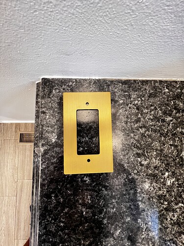

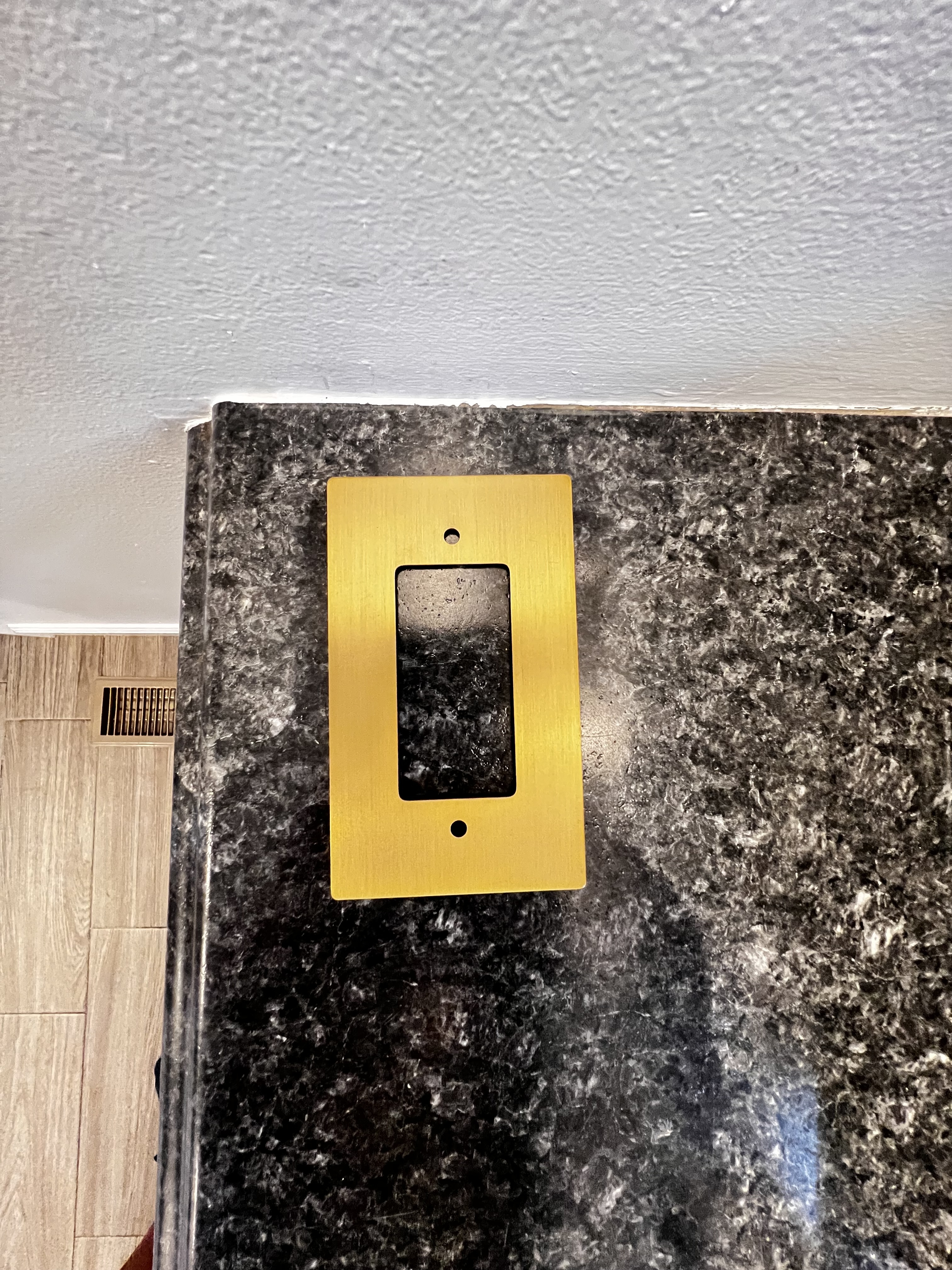

I am using a shapeoko 5 with a vfd spindle and carbide create. I am going to be cutting approx 300 wall switch cover plates using brass if I get this figured out. Approx thickness is 1.5 - 2 mm thick. Unless I am wrong I think c360 might be best. Does anyone have experience cutting these. My first attempt at metal. Bit choice, speeds n feeds? Thanks for any advice. I’ve attached an example.

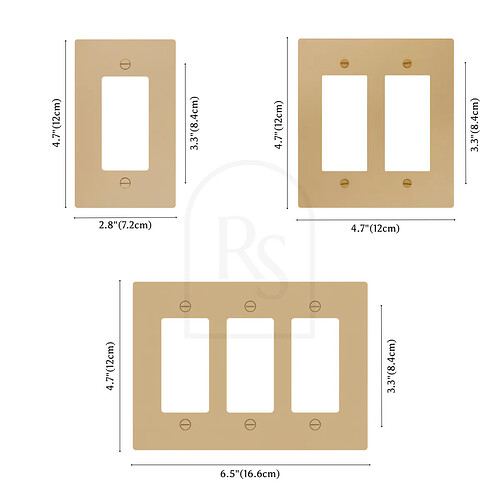

@mountroop10 what are the hole sizes for those screws and do they need to be countersunk at all :thinking:
Screw shaft 3mm. Heads are 6mm. Might consider counter sync
Just a tiny bit off subject: If you look at pretty much every light plate at your local big box store you will find the back of the plate is hollow as if it was an unbacked STL. This isn’t because they are cheap with material. It is to accomodate varying switch depths and the boxes which were installed decades ago…sometimes by unskilled non-electritians. (me). A flat backed plate will sometimes dissapoint in the final installation process as the switch body bulges out. My experience caused me to pocket from the back and leave the front alone, save a little touchup for the screws to fit flush. I see you are doing Decora, that’s probably better. I have always lived in old houses.

being new to brass cutting I am wondering which brass composition will cut the cleanest. From what i have read, c360 is best for free machining, however I cant seem to find larger sheets? Is c260 acceptable. My client is looking for a brushed brass look like the picture I posted in my initial thread.

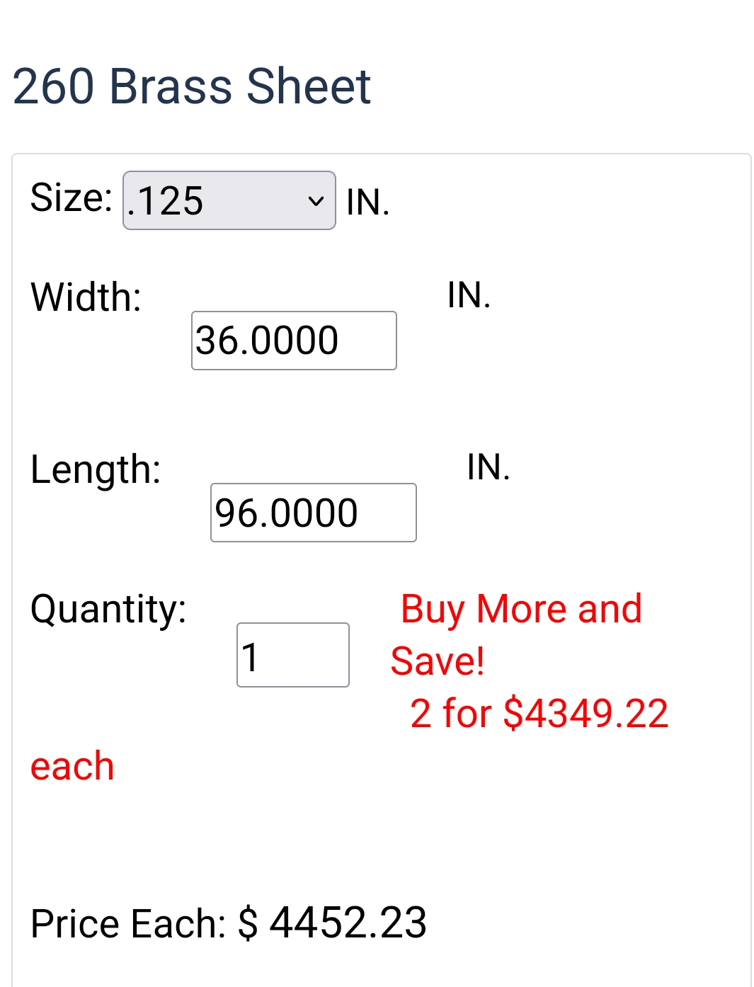

Midwest Steel and Aluminum has 36" x 96" x 0.125" C260 sheets.
https://www.midweststeelsupply.com/store/260brasssheet

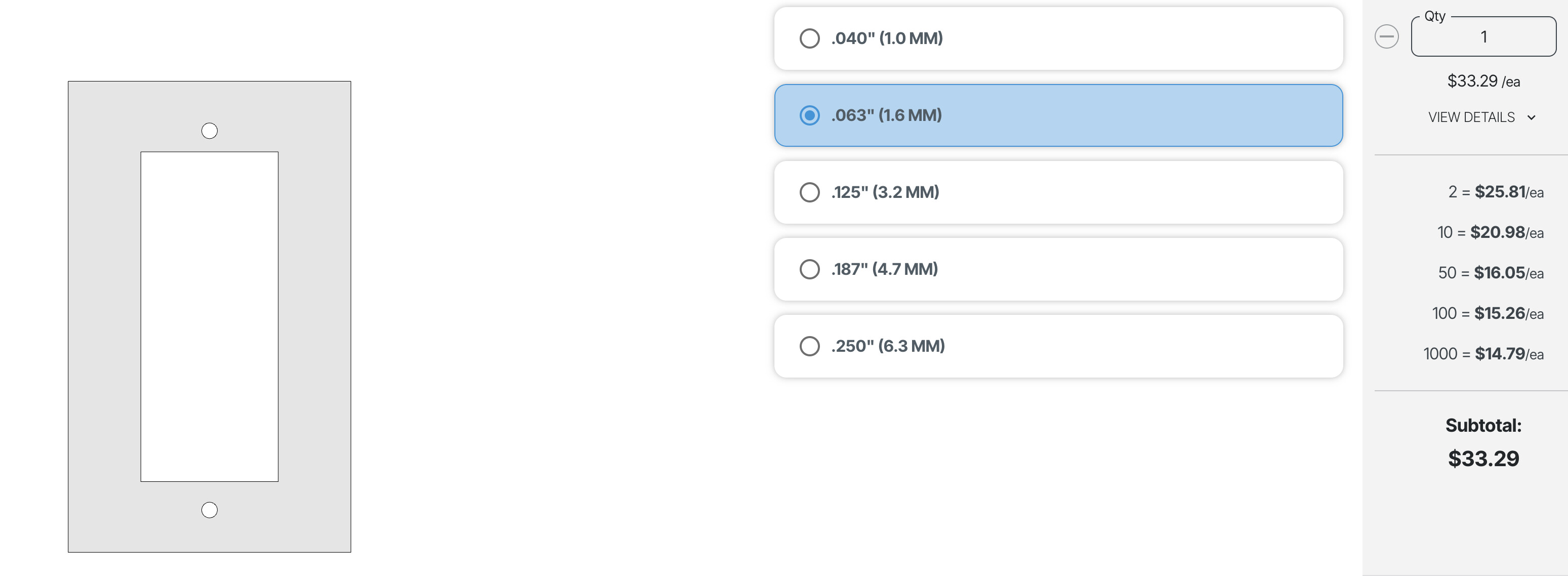

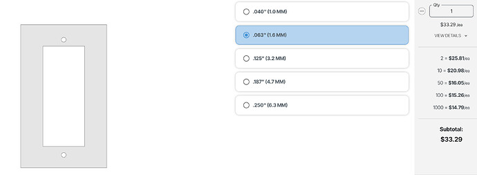

Just as a sanity check, prices from sendcutsend for 0.063 260 brass:
