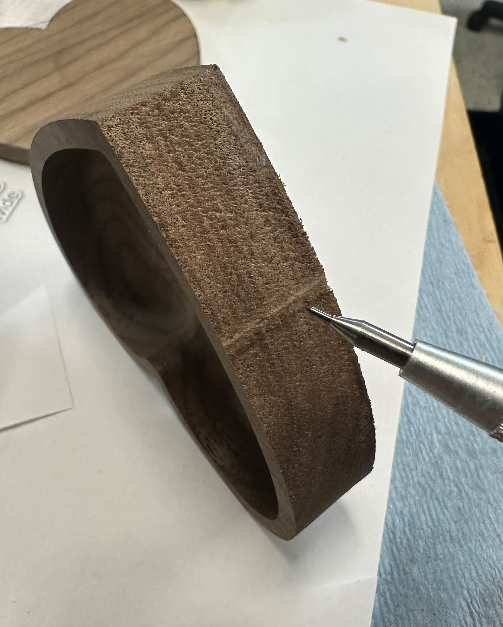

Help with bump in contour toolpath
I hope someone can help me understand and solve this issue with this toolpath. This is an outside contour being cut with a 1/8-inch down-cut bit. It always leaves this “bump” right where the toolpath starts and stops. It’s almost like the path starts and stops as soon as the bit reaches the starting point (touches the start point) leaving an amount uncut equal to the 1/4 the radius of the bit (1/64th).
Is this type of bump common and is there a way to solve this issue?
Thanks!
Mark
Leave a roughing clearance and take a finishing pass.
It’s quite possible that the bump is the only ‘accurate’ spot on the profile, and the rest of the path is deflecting & digging in, particularly if you are ‘slotting’ (cutting a 1/4" slot with a 1/4" tool).
I would offset my heart shape by 1/2 the tool dia. (0.125"), and edit the ends so the tool starts off the part.
Use a contour toolpath, with “No Offset”. Analyze the toolpath to see where it starts, and which direction it is travelling. In my case, this one started at the lower left point, and travelled around the heart in a CCW direction. I selected the offset vector and “Mirrored” it left to right. Now the path starts at the lower right point & travels CW (Climb cutting).
Tod was right about the bump being the only ‘accurate’ spot. Although I was not taking very much on each pass, it was enough to cause the 1/8 bit to ‘dig’ into the contour causing some inward deflection. When the motion stopped to plunge, the bit would settle into its correct alignment.
I solved the issue by redesigning the geometry to do all of the cutouts with a 1/4-inch bit. Much less deflection and a near-perfect profile on the wood once fully cut out.
