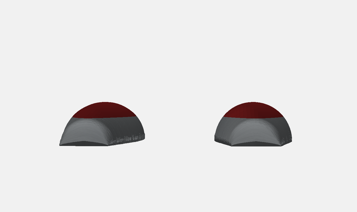

I am trying to make a tool handle by carving 2 halves of a sort of cylinder that I can epoxy together. Please ignore the red/flat spots on top of the pieces - I am using MDF as test material that is half as thick as the wood I will use for the final product. I cannot figure out how to get the round component correct to make the sides round. Can someone please help me understand why I am getting this result where there is about 1/4 inch on the sides that is flat? Any suggestions for better designing principles?

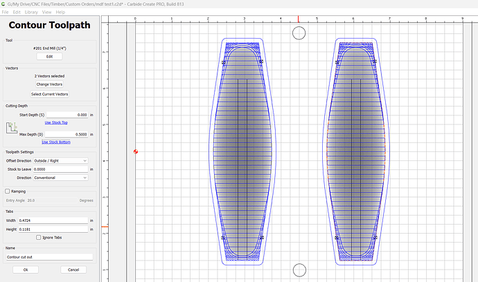

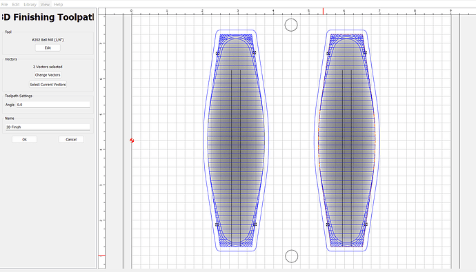

@katiecoloney, the 3D toolpath is not taking the cutter centerline past the part outline. and to finish to the part edge the .250 diameter cutter would need to go .125" past the part outline (i.e. all the way out to where the contour toolpath is).

Hi Will, that’s clear and I am using thinner stock as test material. My question is about the flat sides (circled in the photo of the finished result) and how to model something with round sides all the way down to the bottom of the stock.

Hi @Randy thanks for your response! If I redraw the shape with an offset to account for the tool diameter, that will cause the 3d toolpath to cut all the way down to the bottom of the stock? Will I also need to adjust the contour toolpath to avoid the flat sides?

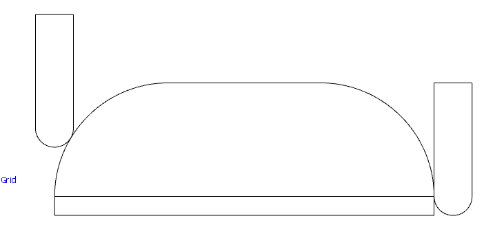

As mentioned, the tool tip (center of tool) is stopping above your boundary, which is likely the edge of the 3D shape. Offset by the radius of the tool to allow the tool to completely cut the shape.
Note it will still stop at the bottom of stock & leave a radius, so you’ll want to add a base and increase the stock thickness by the radius of the tool. Also note that now it will cut the radius of the tool below the part, and into the spoilboard so using a secondary dispensable spoilboard is advised.
Thank you so much, this is graphic is super helpful!!
