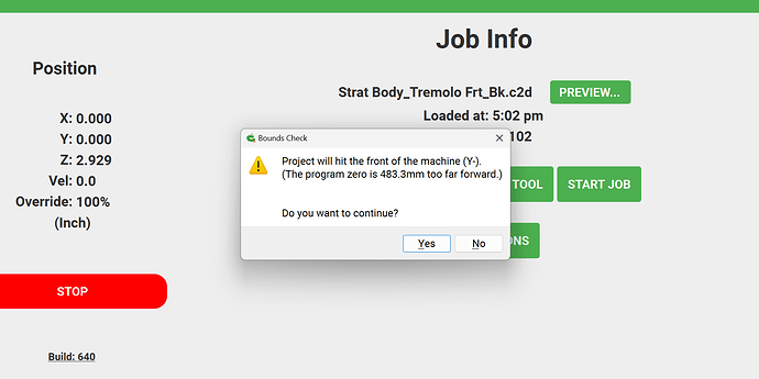

Help! Zeroing is "too far forward"?
I’m trying to run a project and I’m getting the error message below. I’ve reinitialized, moved my drawing around and reset the bitsetter, and it still is appearing. Doesn’t make sense to me as everything is positioned well on the machine (SP Pro XL) to cut in the designated area.
Thoughts on how to resolve this?
Usually this is caused by a disconnect between how the origin is set in the file:
and how it is set relative to the stock:
If you still have difficulties, upload your file and let us know step-by-step how you are securing your stock and setting zero relative to it and managing all tool changes and upload a photo showing your machine at the zero relative to the stock (or a specified offset from that position).
Ok, I think I figured it out. For some reason my XY origin on the file was top-right as opposed to bottom-right, which is strange because I don’t recall changing it. Thanks!
