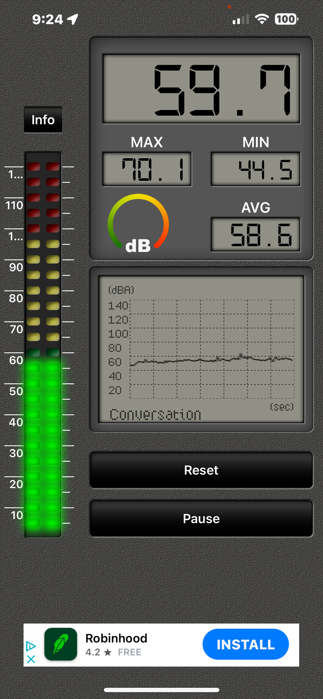

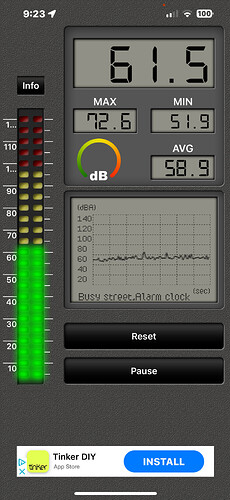

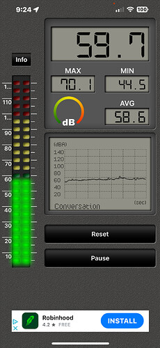

This was just a quick dB reading with an iPhone app. The picture that shows a 70.1 max reading was 11’ away from the HF Dust Collector (where I normally operate from). The picture that shows 72.6 was taken 1’ above the motor at the junction of the pipe going into the bags.
