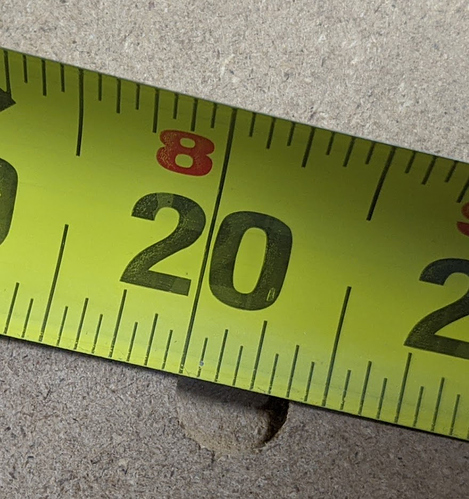

Recently purchased an XXL to augment my woodworking/engraving business.
Trying to make an MDF waste board with 0.26" holes spaced about 2 3/8" apart.
I laid out the board in CAD, exported DXF, imported to carbide create, and everything looked good. Radius of holes shows as 0.13" in carbide create.
For the toolpath, I chose standard 1/8" endmill, set the depth per pass of tool to 0.1", set offset direction to pocket with a max depth of 0.1".
My expectation was that the 1/8" end mill would move to location, plunge 0.1", pocket 0.01" and retract.
Instead I am getting holes that are right on the 2 3/8" center, but are .375" in diameter, not 0.25" The holes are round, evenly spaced, but too big.
Any idea what I’m doing wrong? Pretty dejected that I can’t even make a waste board to actually start trying to do more accurate stuff at this point!

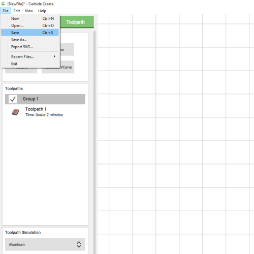

save as .c2d file like this:
save-file
Then:
upload
Just “Reply” and you have to have at least 20 characters then just drag the files you want into the window and they will upload, then hit Reply.
Thank you all for the help. The winner winner chicken dinner of the night is Andy. As it turns out, I’m really a much bigger n00b than even I realized!
It was, in fact, me telling CarbideMotion that I had a .125" end mill in the machine, while the router was happily cutting away with a 0.25" end mill installed! Sorry for the fire alarm. Seems like in addition to a big learning curve, I’ll need to also work on my observation skills!
Thanks so much for the help. Waste board complete! Now on to more trouble! :slight_smile:
