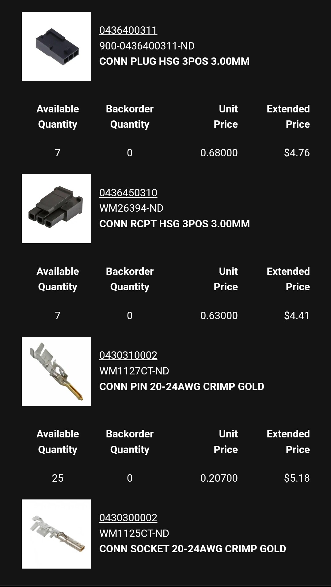

Currently, I have a bad Z-axis homing switch, and support is sending me a new one; however, the machine comes with a spare, the only problem is the machine arrived with the 2 X-axis limit switch wires pulled out from their pins, so I had to use the spare to set up the machine and I don’t have the spare anymore.
Patience has never been my strongest attribute lol, so while I’m waiting for C3d to send me a new switch, I figured I could re-pin the spare I have. (I figure it’s good to have a spare anyway.) I ordered what I thought was the right pin size for the connector from Amazon, but it’s not correct. Can anyone tell me, or point me to a thread with the pin and connector size for the S05 homing switches?
Thanks in advance for any help yall can provide!
The SO5 uses Micro-Fit connectors.
Not sure if anyone has been re-wiring them since they require expensive tools to both unmake and make.
@WillAdams - is that the micro fit 3.0? I have a crimper and removal tool. Just need to make sure I’m buying the right connect and pins.
You can get via DigiKey
I like the gold plated pins & sockets.
Thanks for the insight, Joel!
