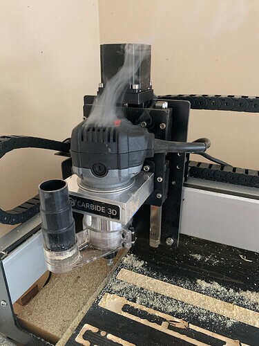

I have the shapeoko router and it’s relatively new. got the machine (4x) about 5 months ago. recently the router is getting real hot and making squealing sounds. I changed the brushes but that didn’t help. So I need to get a new router or is there something I can do to fix it.

If it’s under warranty, let us know at support@carbide3d.com and we’ll work out how to handle it, otherwise, most folks just replace it, or upgrade to a VFD spindle.
Unfortunately a hot router & squealing means the main bearing is shot - continued use can result in the router shaft totally siezing up &/or the motor windings burning out.
Your best option is to get it replaced via C3D if it’s still under warranty.
Having a spare C3D or Makita router on hand when one goes bad is pretty much a necessity. Also applies to the VFD’s - doesn’t hurt to have a fallback option when you just need to get something completed.

Did it quit working after you let the magic smoke out?
Another reason to not run unattended.
yes. Lots of funny noises and then dead.
Carbide replaced it right away as it was still under warranty. Great customer service!
Also never go higher than speed 4
