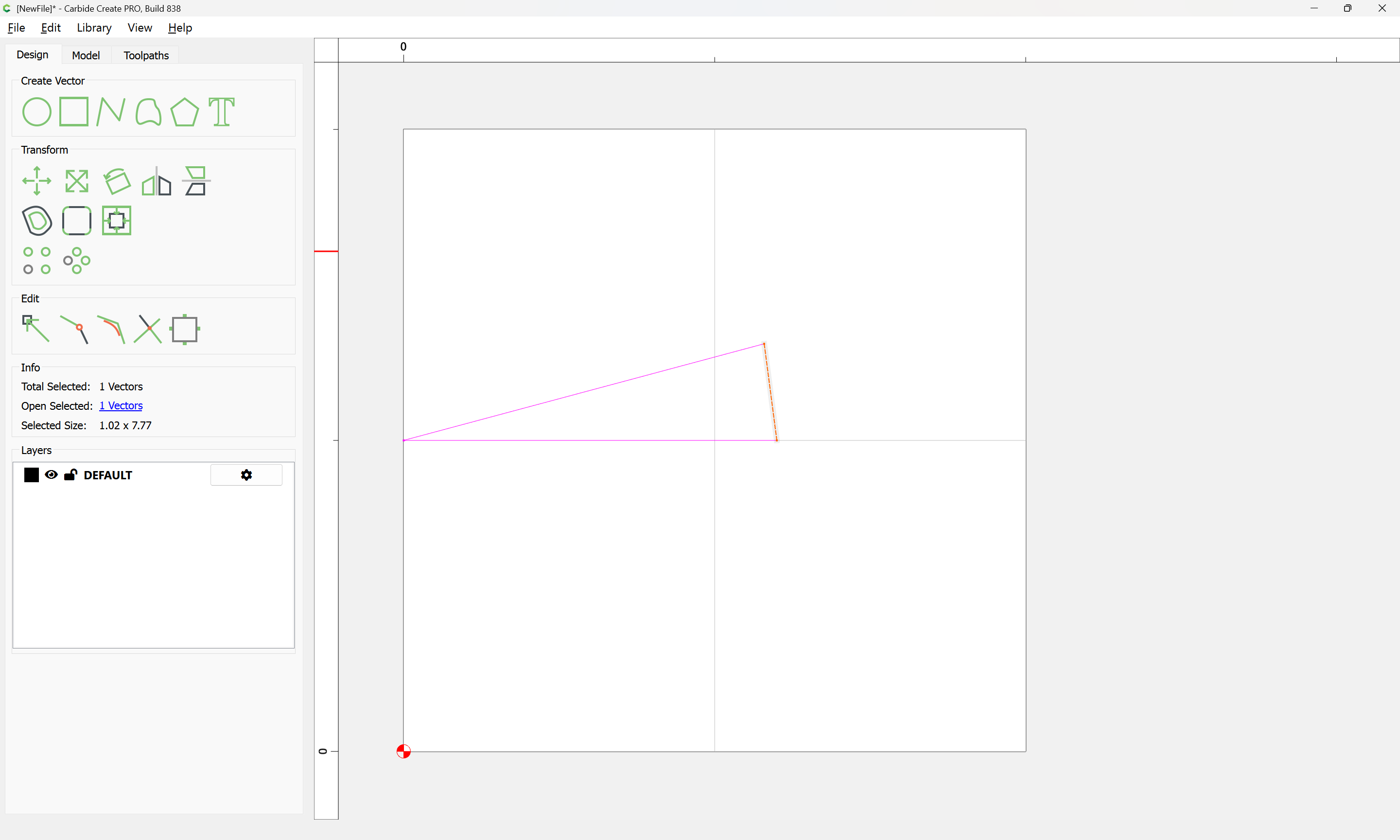

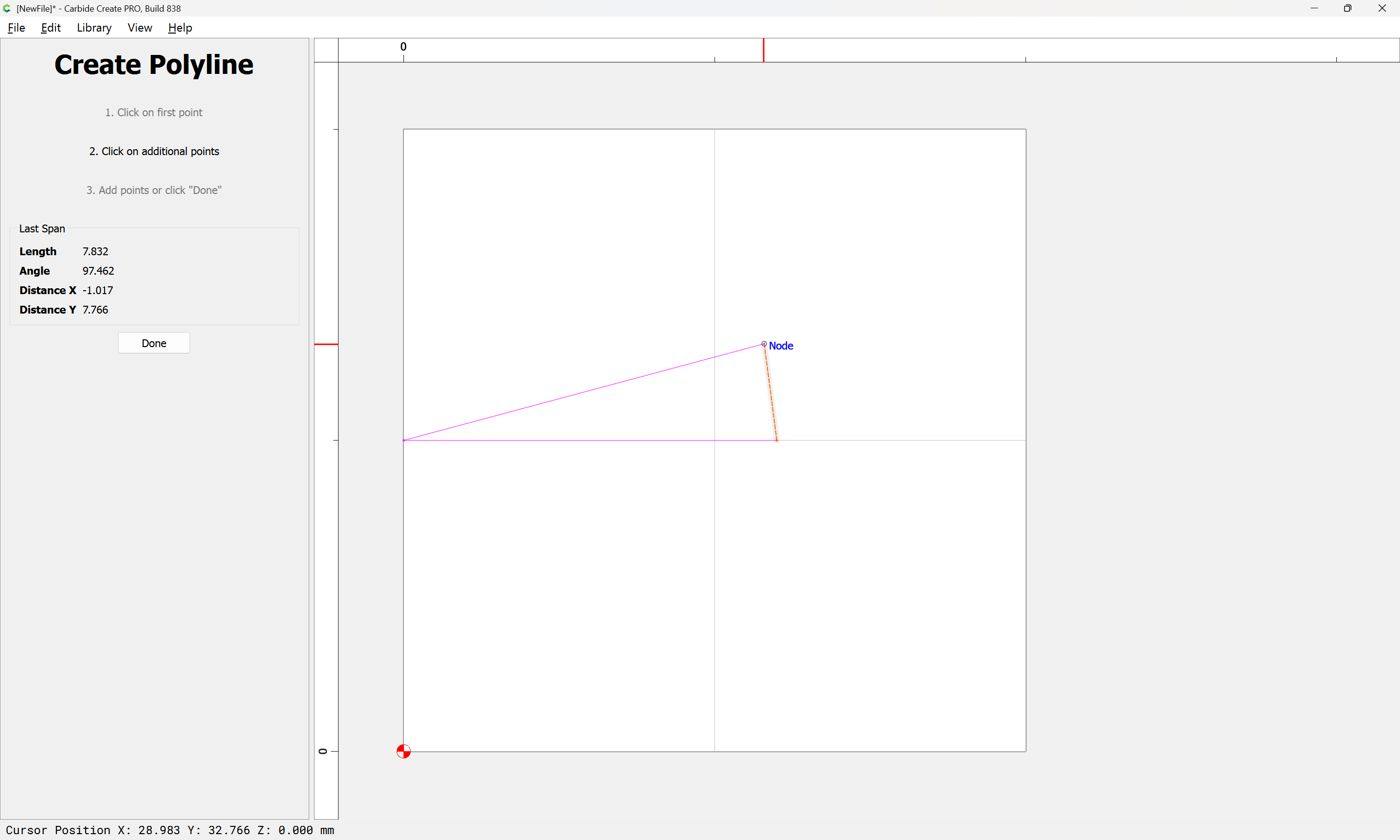

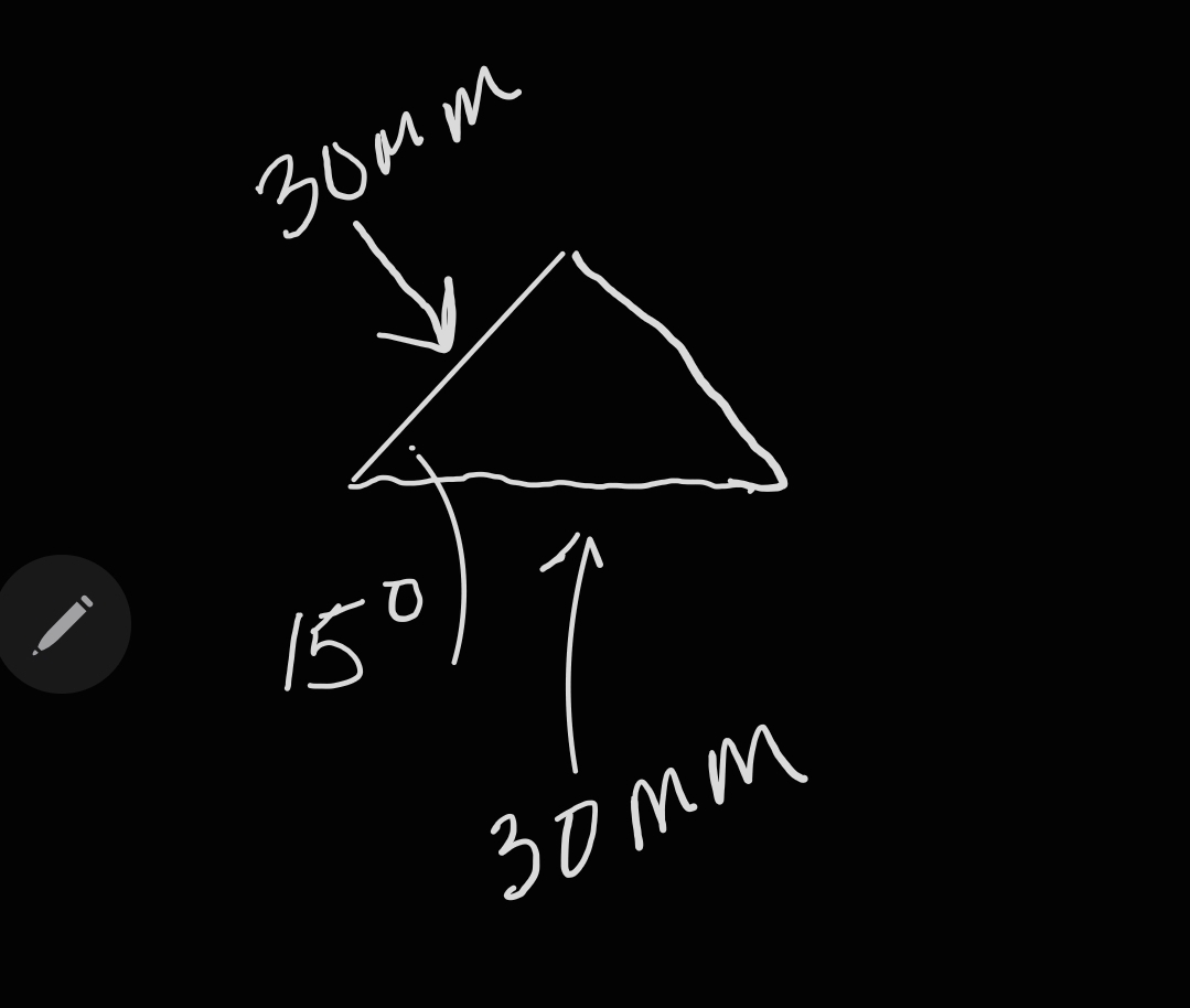

How can I do this triangle?
Using Carbide Create how do I draw a triangle that has 2 sides 30mm long, 1 side 7.83mm long with an angle of 15 degrees between the 2 30mm legs?
I drew 3 rectangles. 2-30mm x1 1-7.83mmx1
rotated one of the 30mm 15 degrees.
placed the in the triangle. Then traced with the line
function.
30 mm triangle.c2d (44 KB)

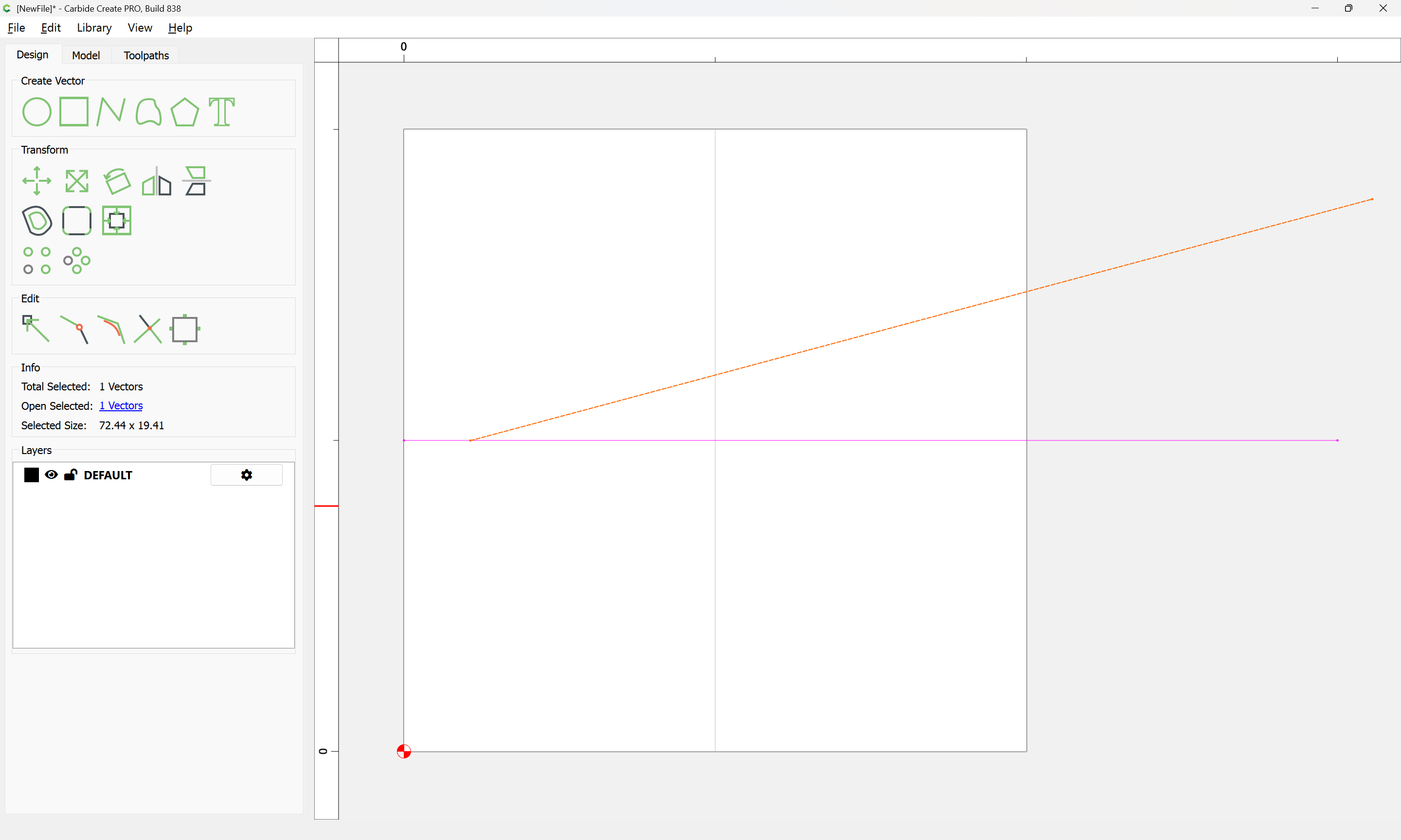

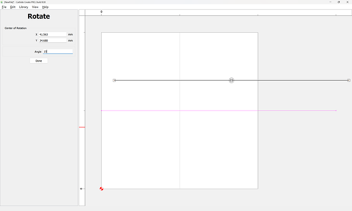

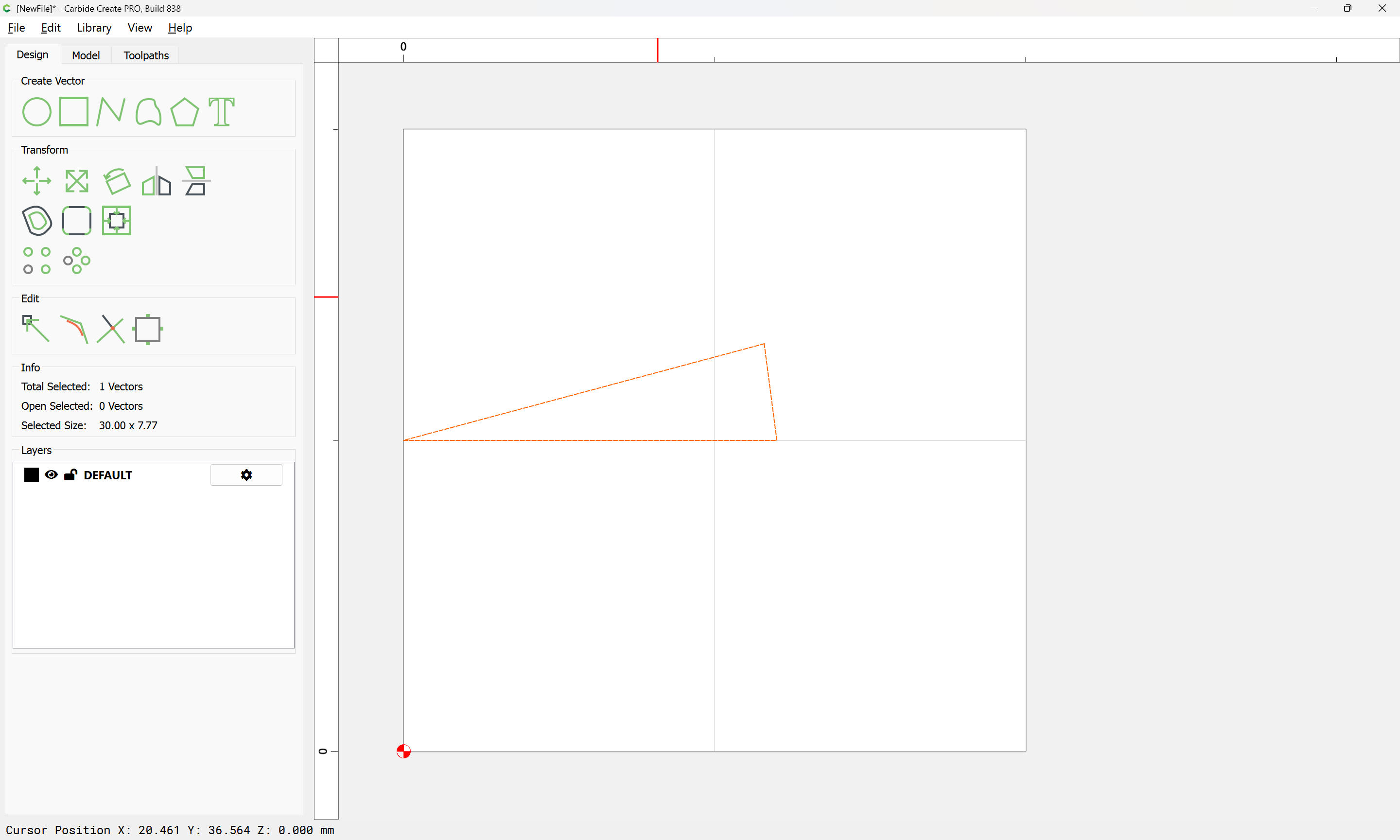

One way to do this would be in Carbide Create:

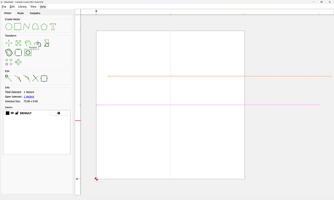

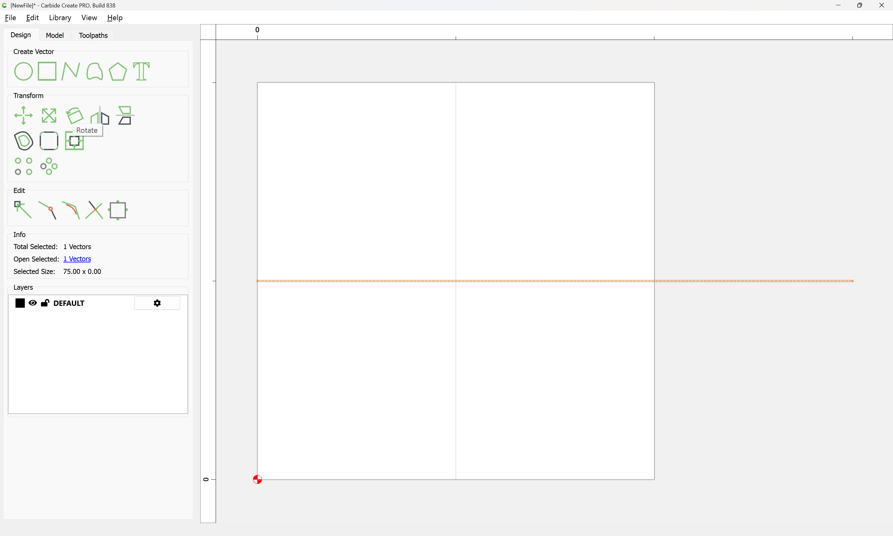

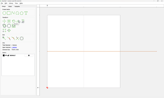

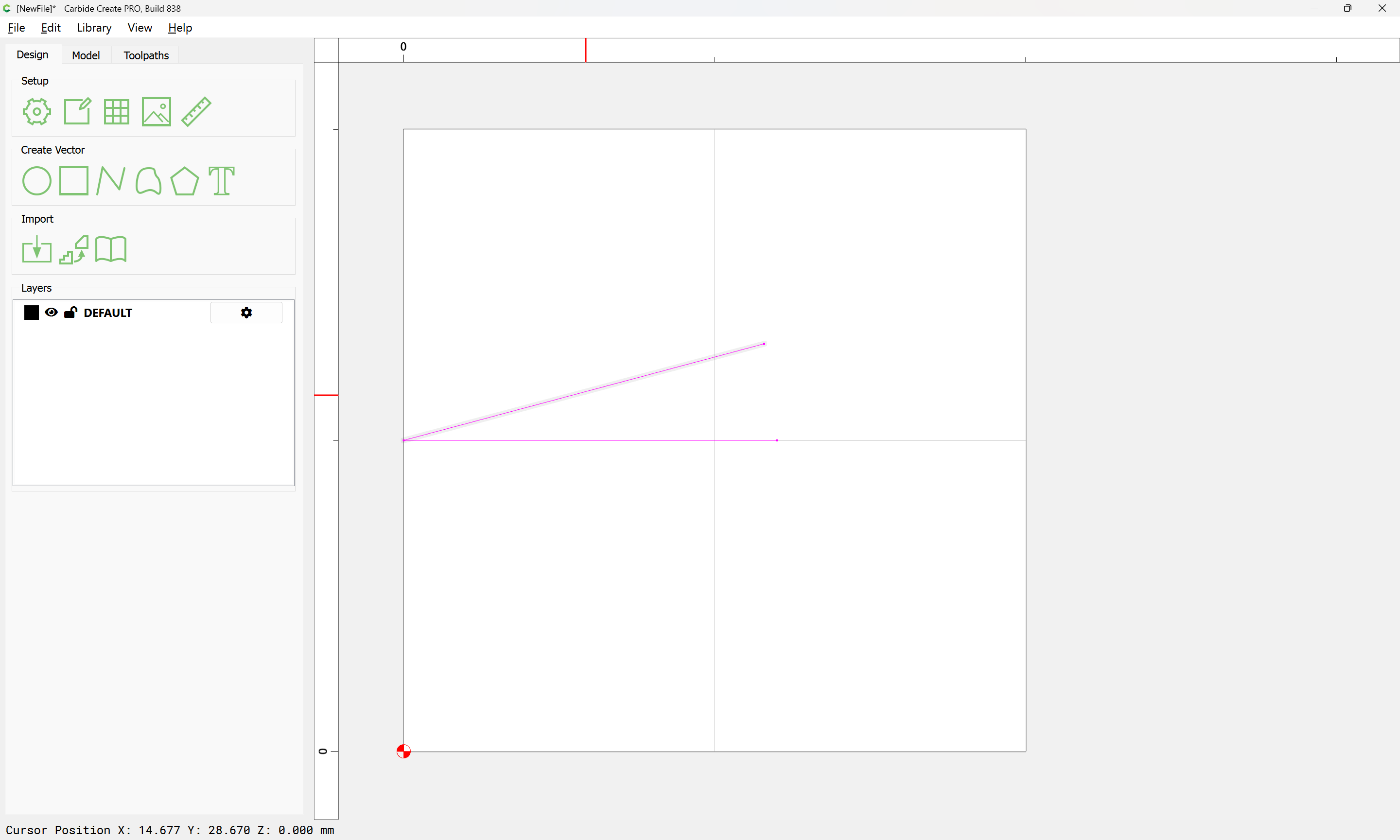

Draw a line:
copy-paste the line:

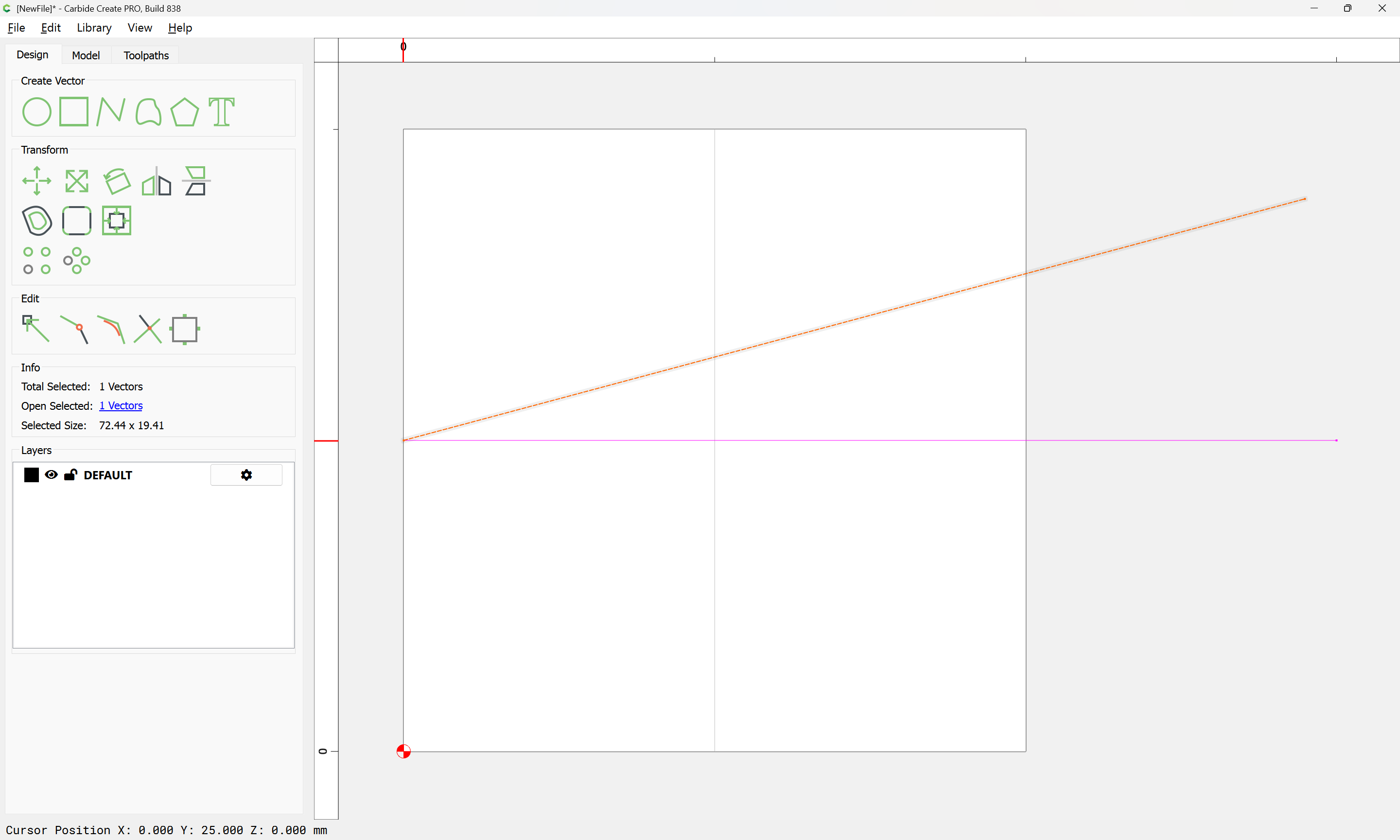

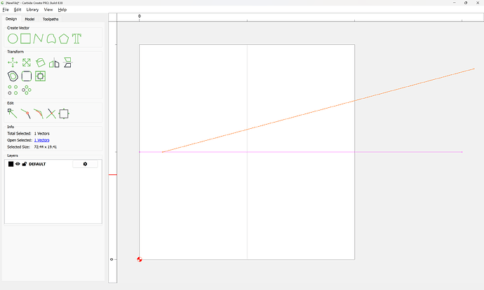

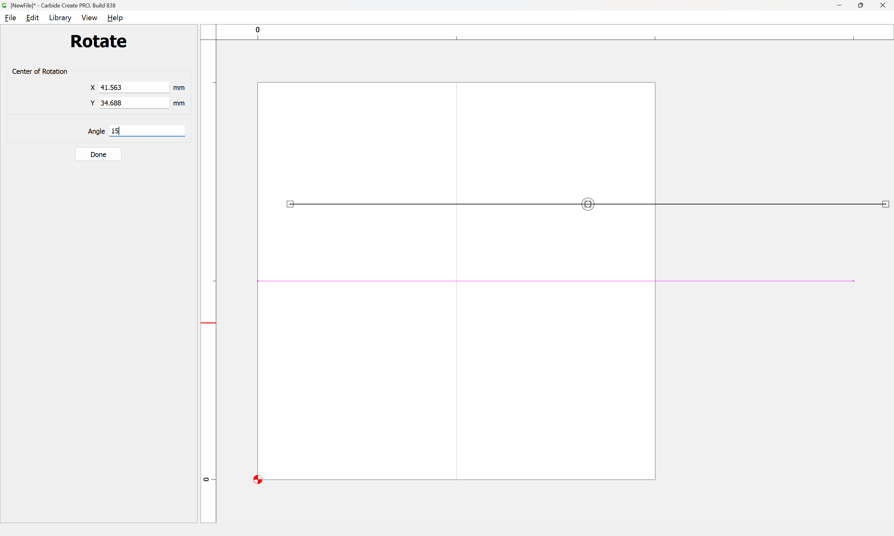

Rotate it 15 degrees:
Done
Drag it into alignment with the original:

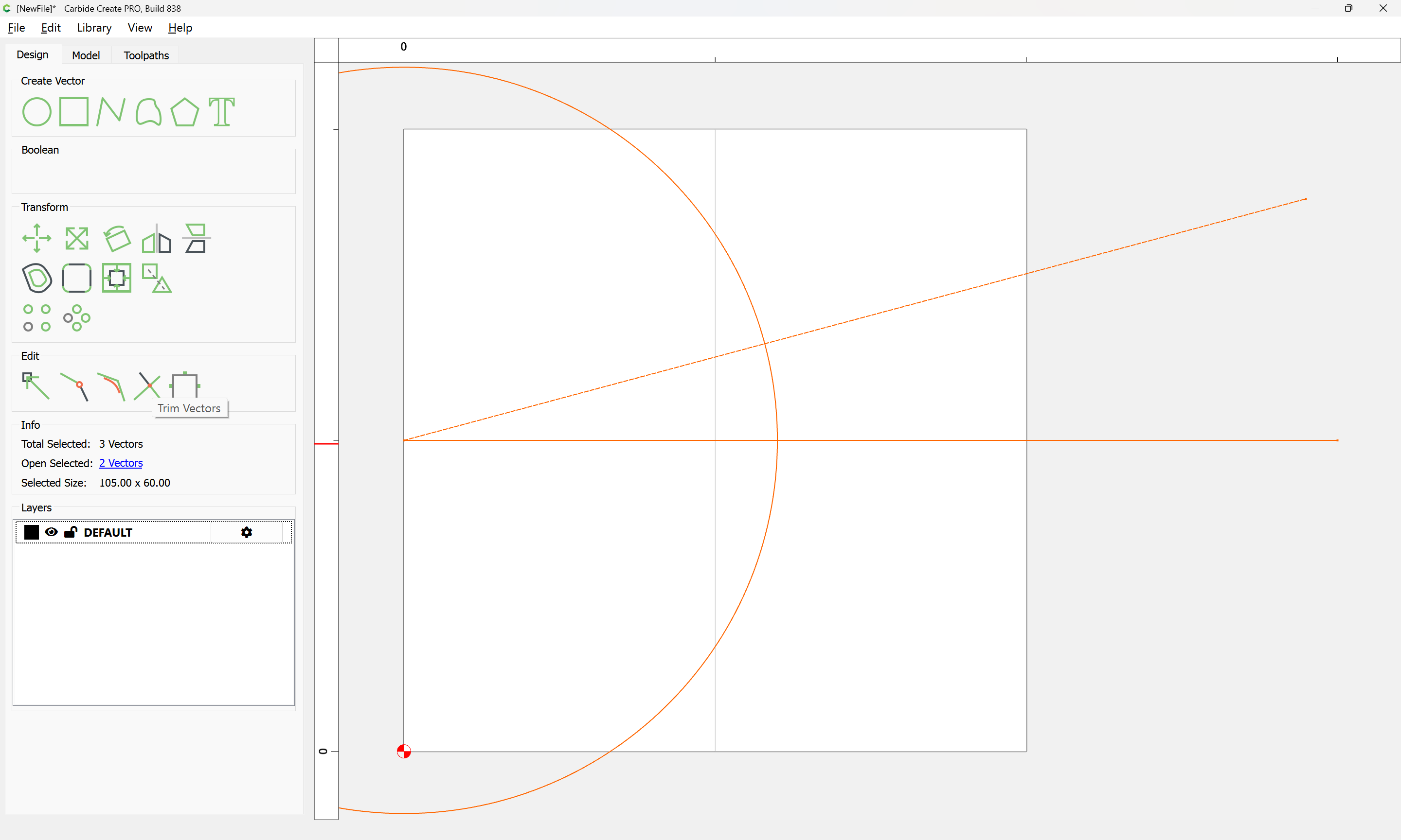

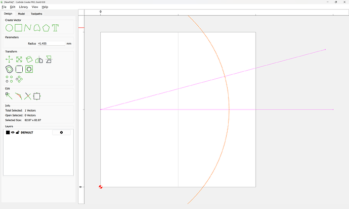

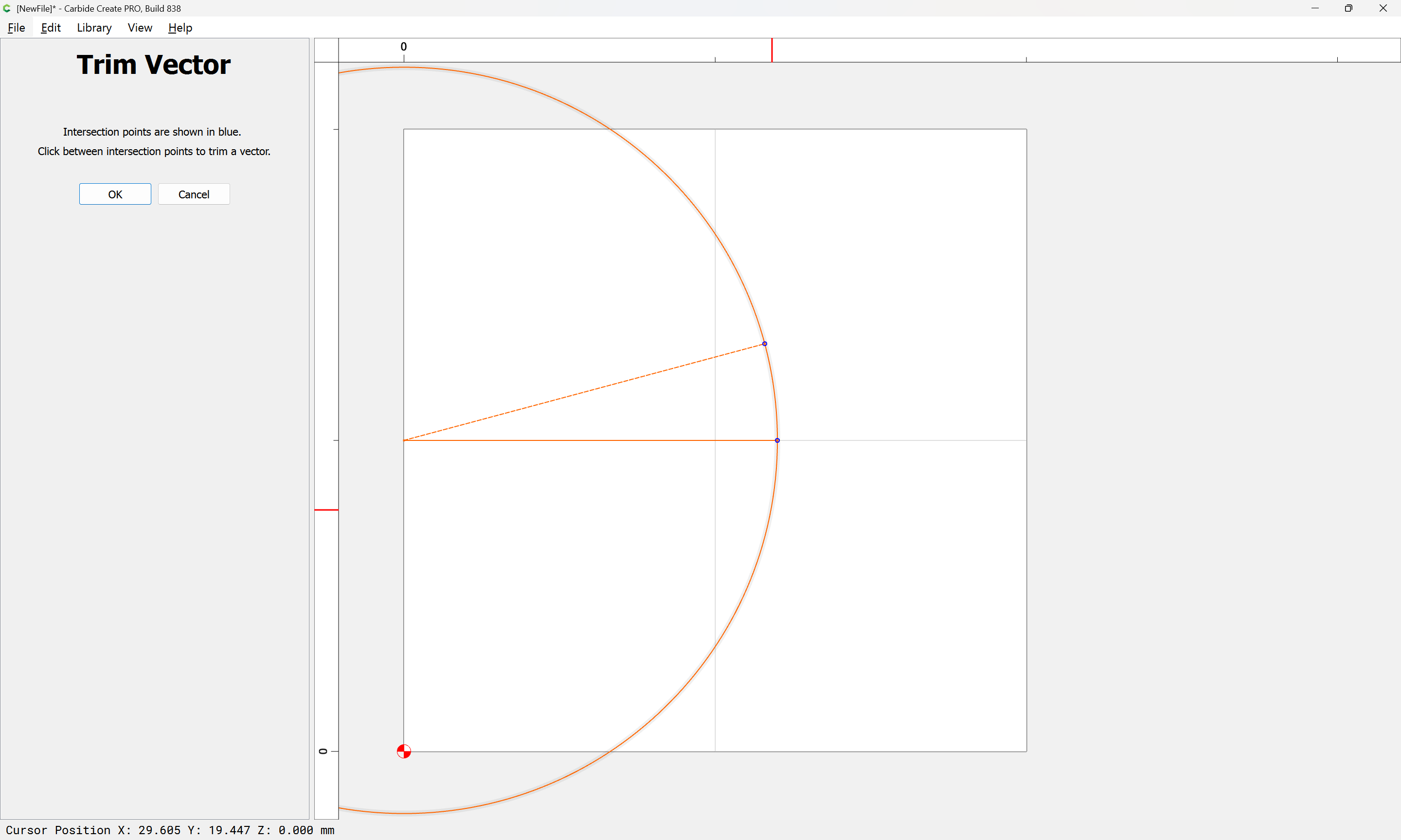

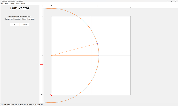

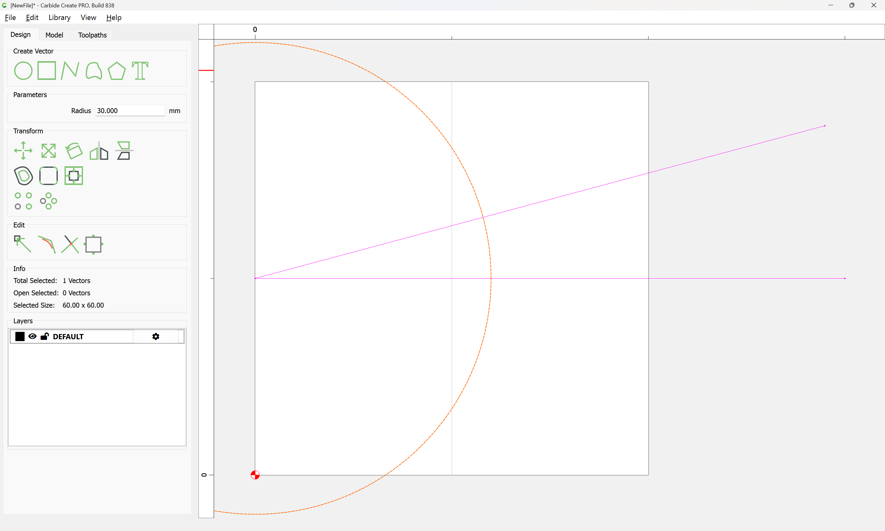

Draw in a circle with the center at the vertex:
Then set the radius to the desired distance:

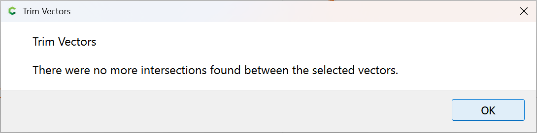

Select everything:

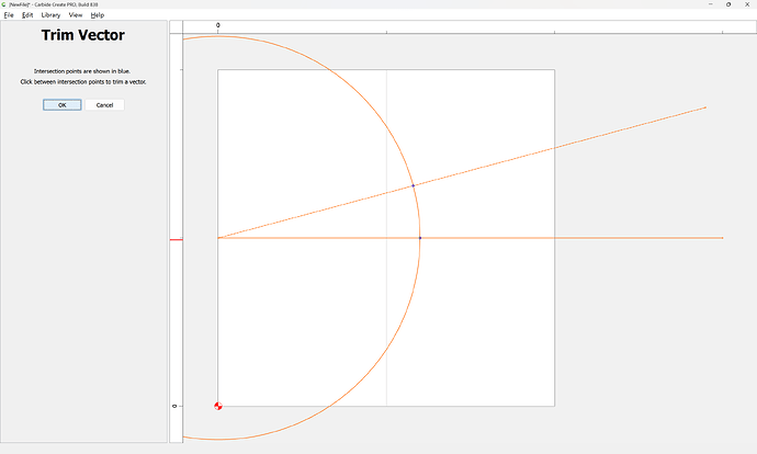

and use Trim Vectors:
then remove what is not wanted:
until one arrives at:

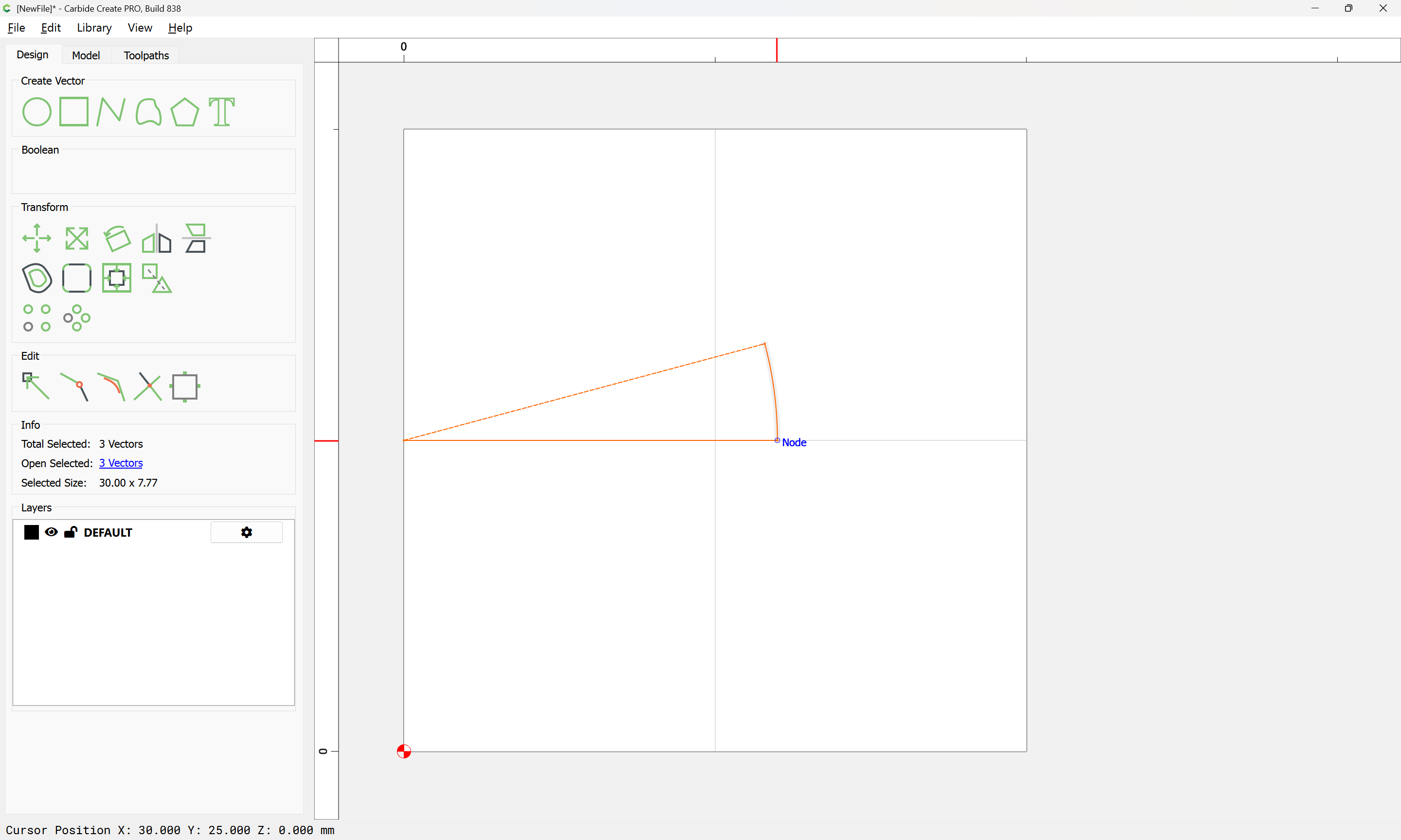

OK

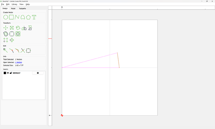

Deselect the two lines:

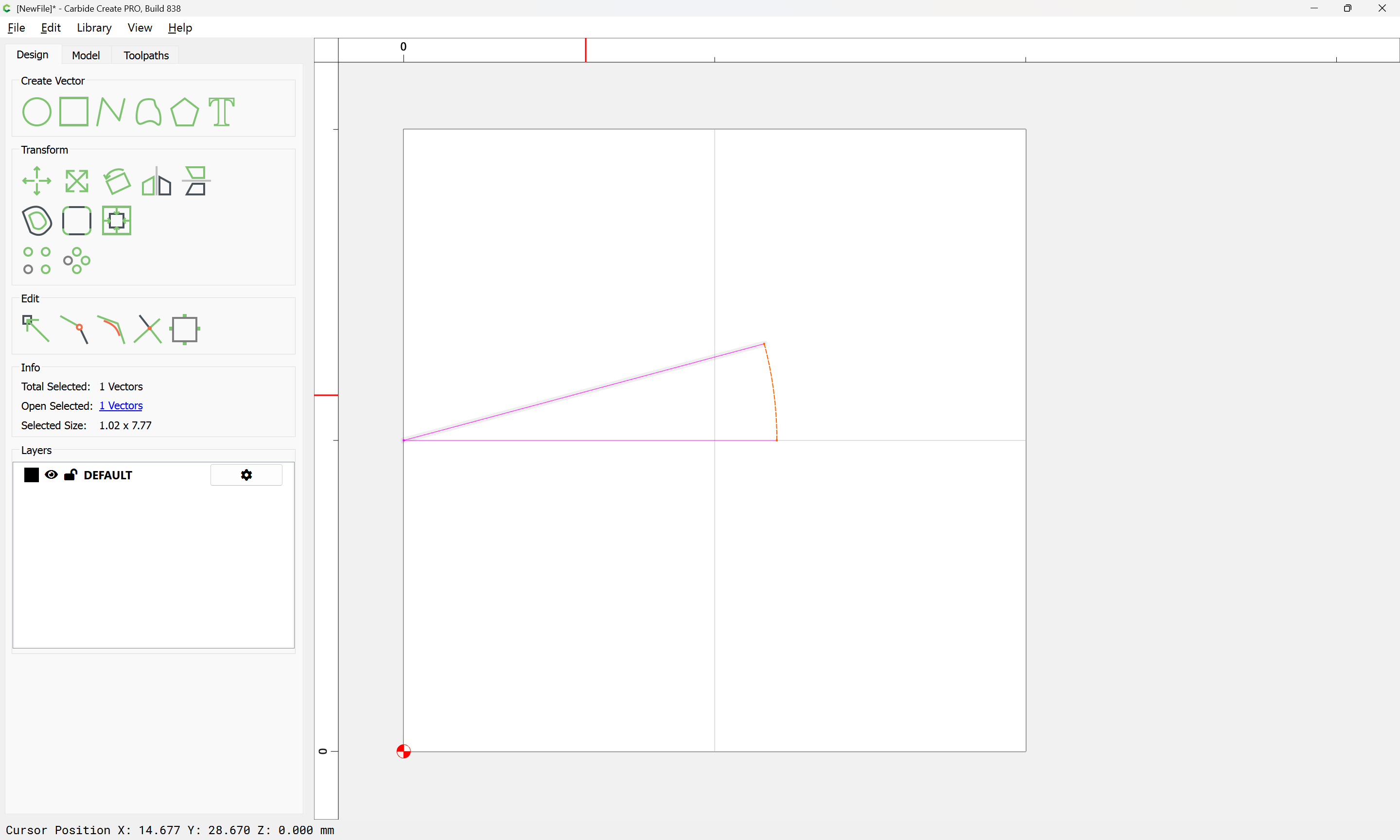

and delete the remaining arc:

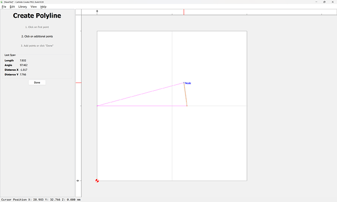

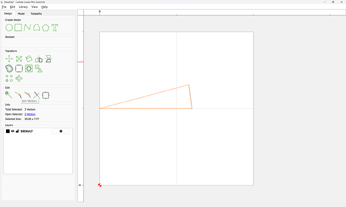

Then draw a line to compleat the triangle:
Done

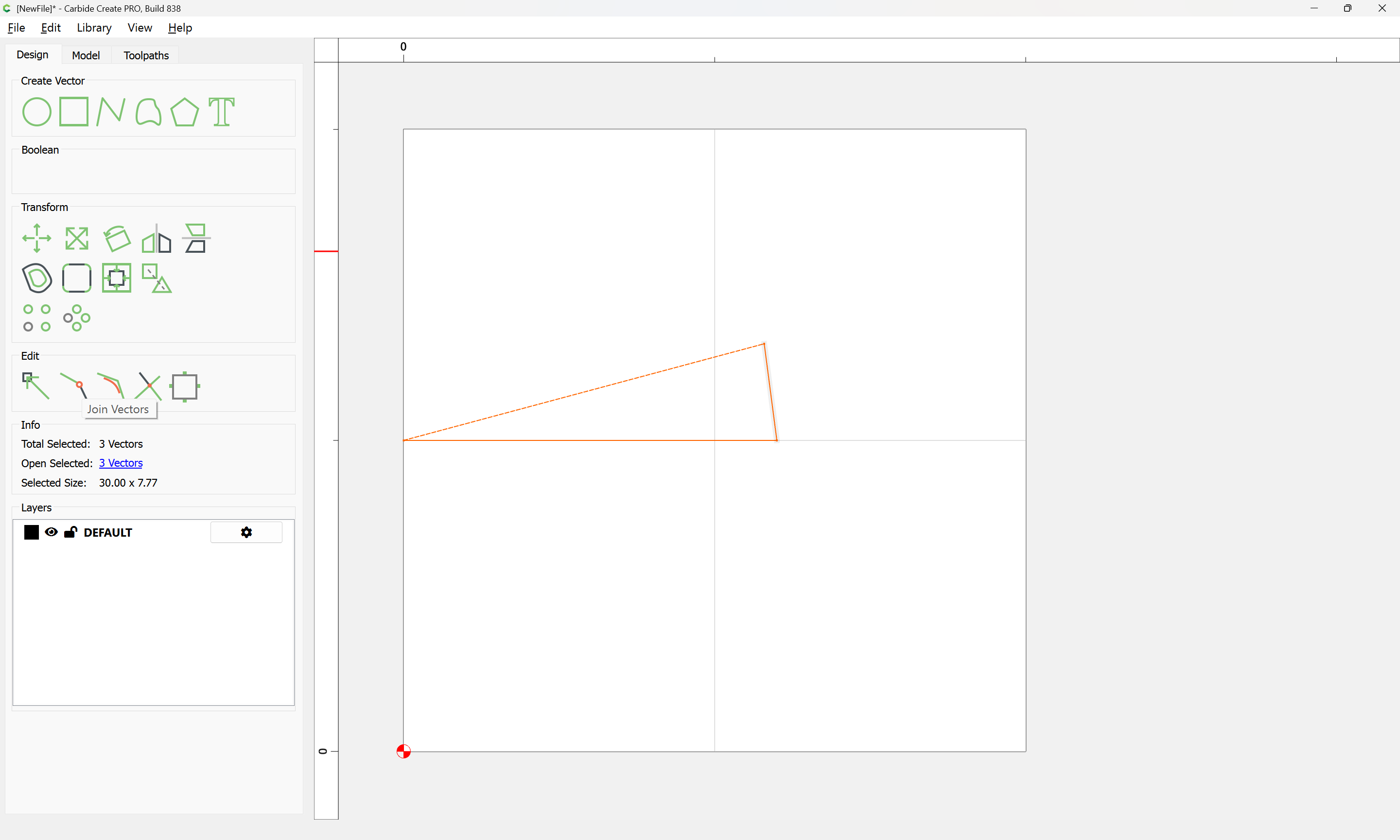

Select everything:
Join Vectors
Attached as a v8 file:
triangle_30degree_v8.c2d (44 KB)
