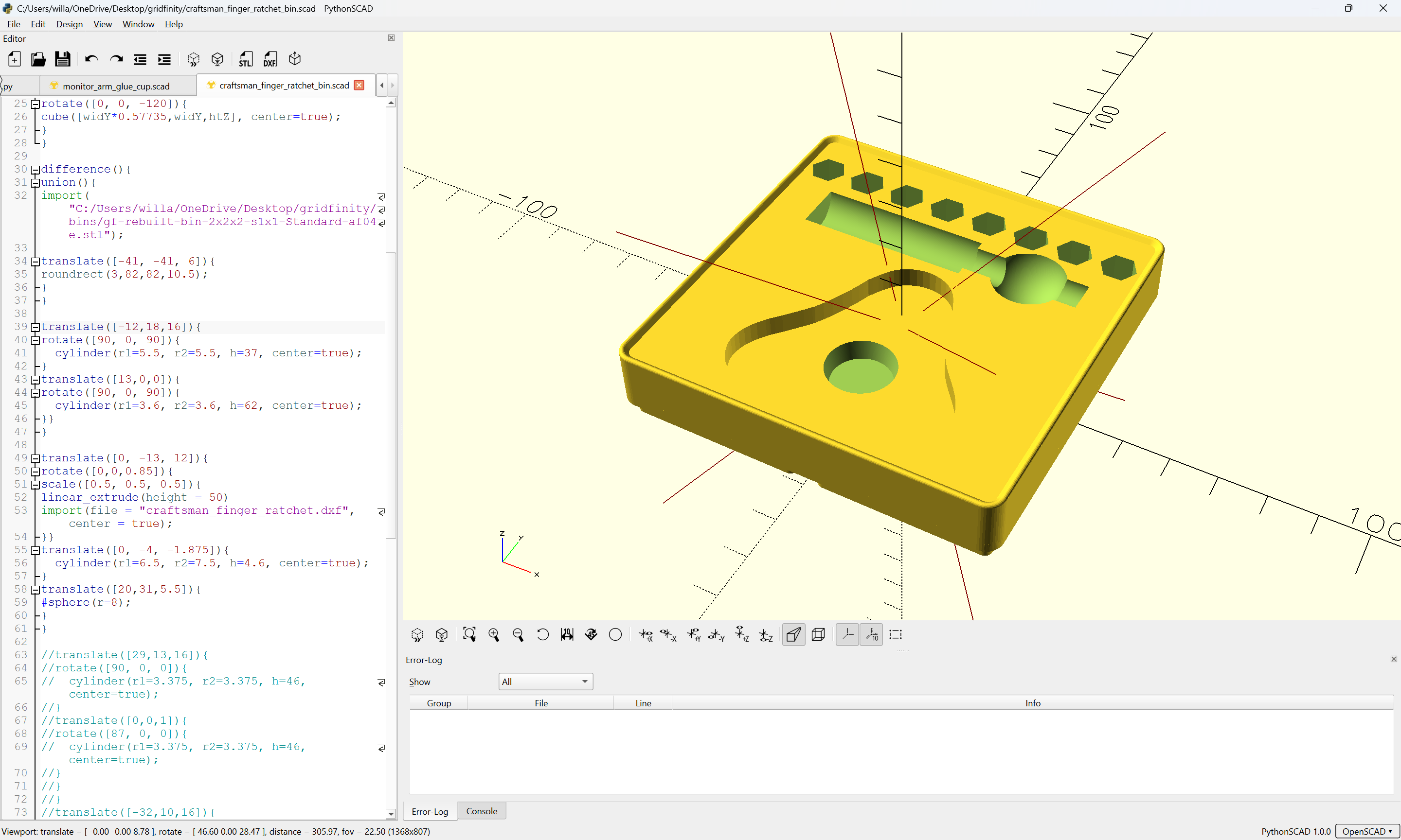

craftsman_finger_ratchet_bin.stl (1.7 MB)
Note that the above STL is untested/not-yet printed, please check dimensions and adjust as necessary.

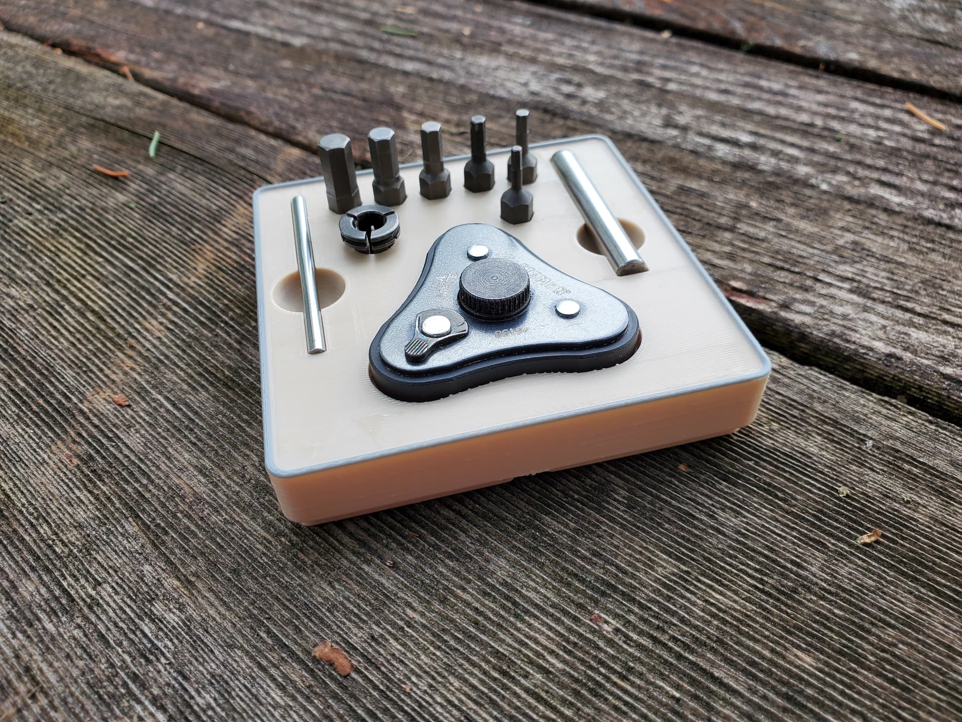

The test print of the version I worked up which instead holds a collet and two probing pins worked well:
C3D_craftsman_finger_ratchet_bin.stl (3.5 MB)
(though the 1/8" pin is a bit tight)

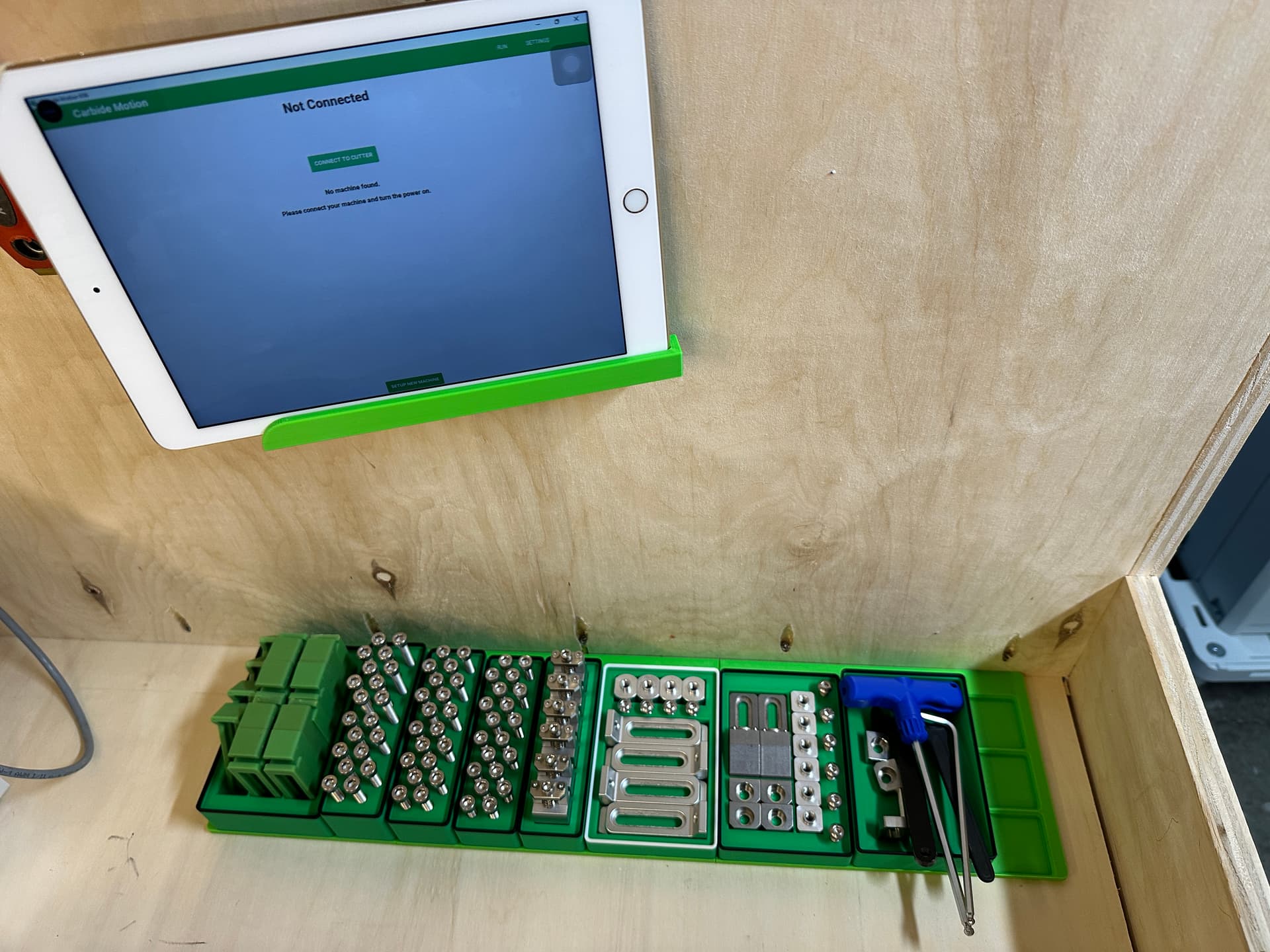

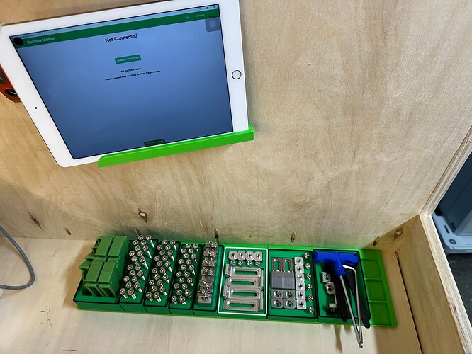

Created a project as I am learning to use my 3D printer and enter the world of 3D design software. Made some organizers for clamp supplies. (the white trim was a mess up, not a design feature, lol)
This replaces the upcycling of some glued up mdf that came in a shipping package

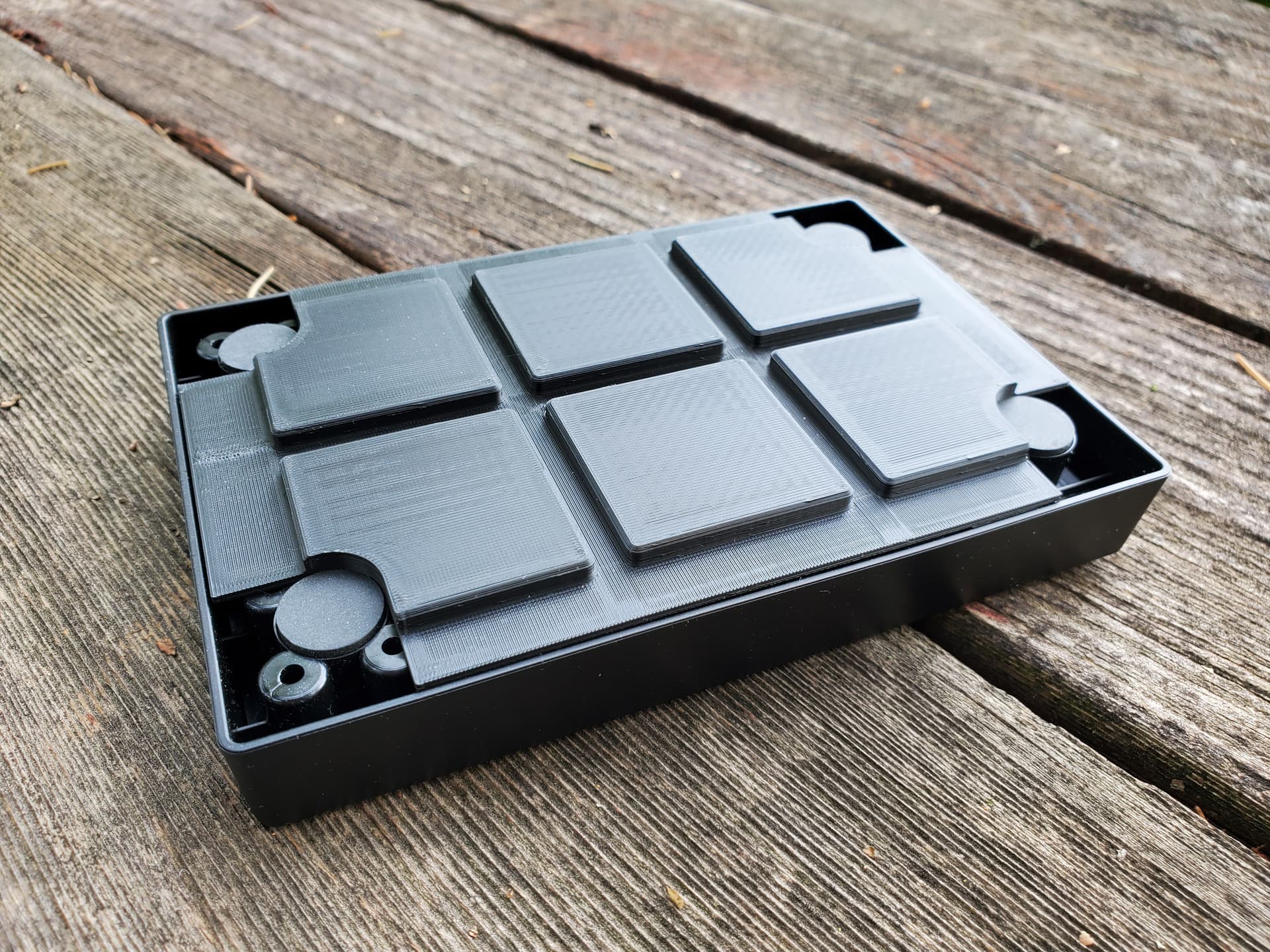

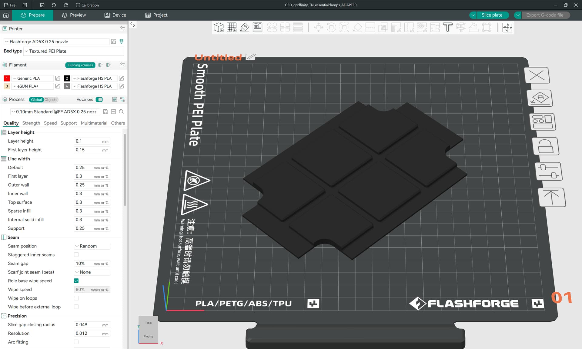

I’m actually printing an adapter to fit the plastic tray from:
to Gridfinity.
Even if it’s not a perfect fit, a quick pass w/ a file should work:
C3D_gridfinity_TN_essentialclamps_ADAPTER.stl (294.5 KB)
(and if it’s not perfect, I’ll fix the file and re-upload)
Fit seems pretty good:
but note that this wants a ~8mm (5/16") thick spacer under one side and some suitable adhesive to make up for the thinness of the connection.

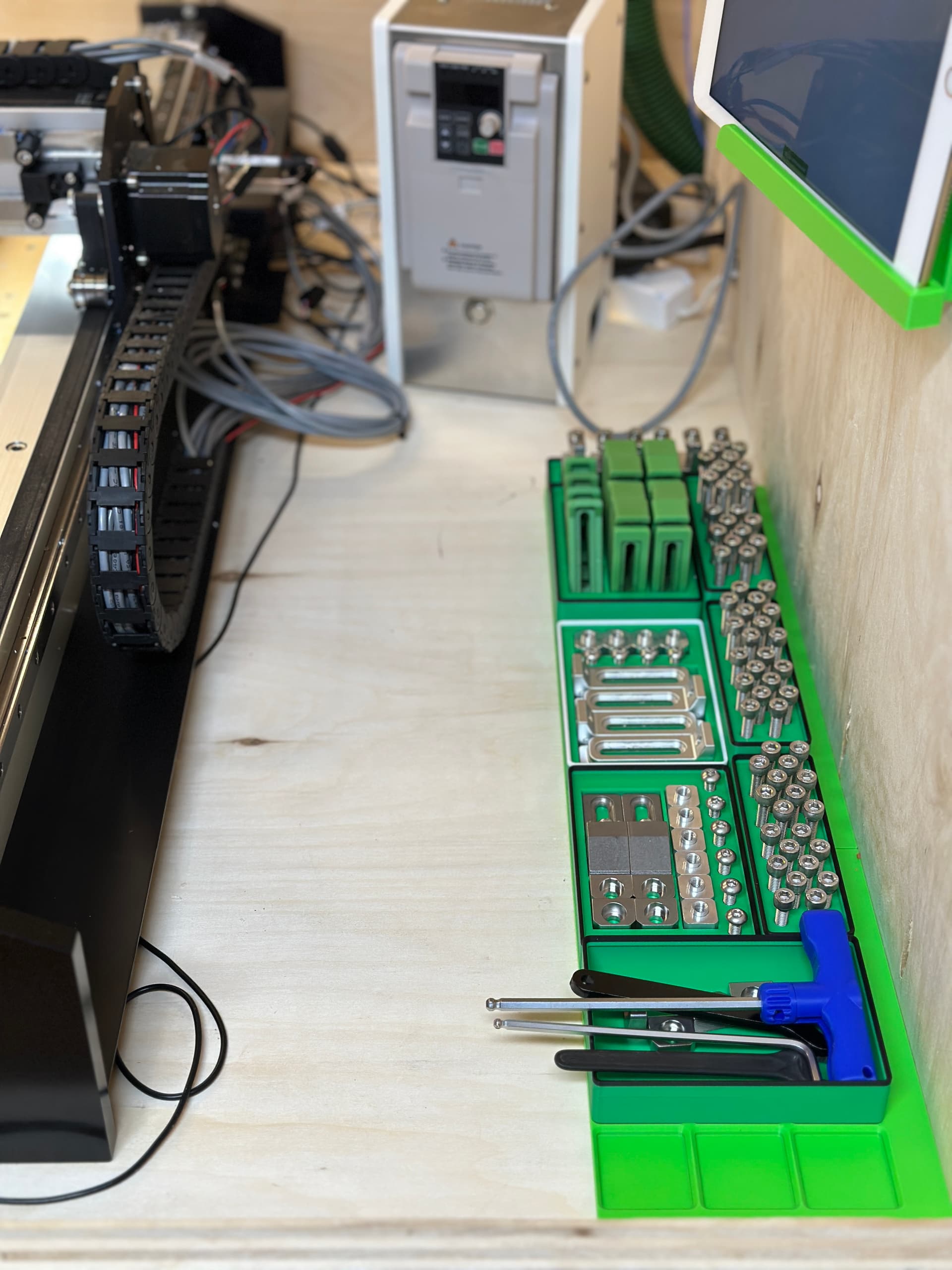

With this done, all that is wanting is a Gridfinity plate to put all this stuff on.

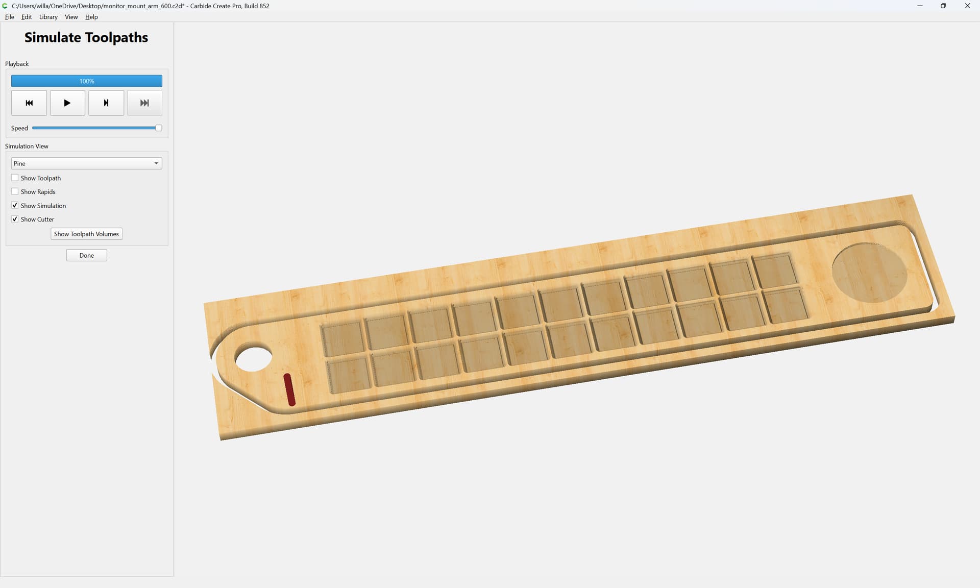

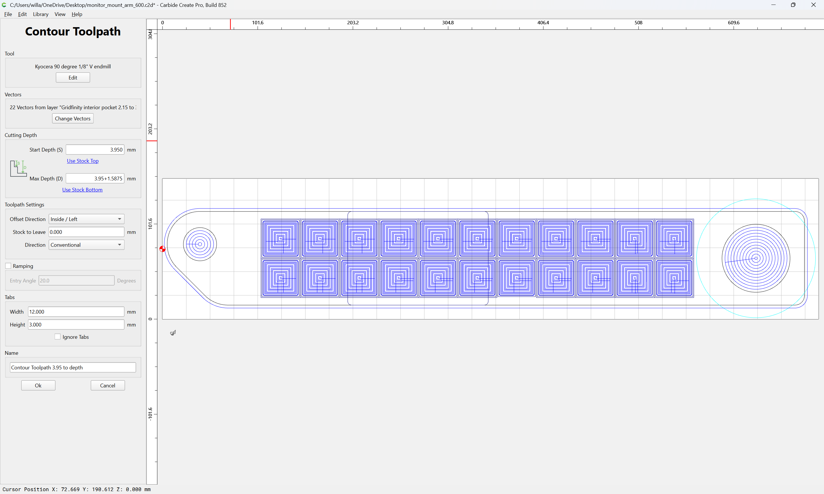

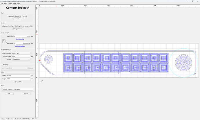

The tricky thing about cutting a Gridfinity baseplate, as opposed to 3D printing is the matter of the quite shallow 90 degree perimeter at the bottom — unless someone knows of a source for a 1.4mm diameter 90 degree V tool — probably it could be dispensed with, but instead, it looks to be viable to use an inside contour with the narrowest 90 degree V tool which one can source (I used a 1/8" diameter Kyocera):
Not quite 1.4 but darn close:
Maybe worth a shot :man_shrugging:
Maybe, but I’d have to get more dimensions or a DXF of the profile to ensure that it won’t run into the vertical portion of the cut.
@TDA Could you provide a dimensioned drawing of the profile of this tool? Also, typo in the page title, Evgraving vice Engraving.
Well, it worked after a fashion:
Obviously should have used a 2x4 Gridfinity base as a starting point rather than the 2x3 — the above adapter makes it take up 5 grids across when it could have been only 4…
I believe I can make up for this w/ a pair of custom 3D printed organizers to fill in around it…
As for cutting the Gridfinity baseplate, that worked okay, but there were a lot of fuzzies, so look for a tutorial on that presently…

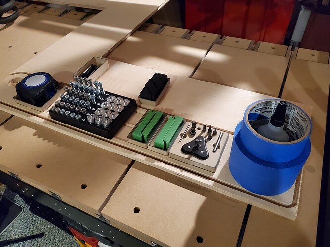

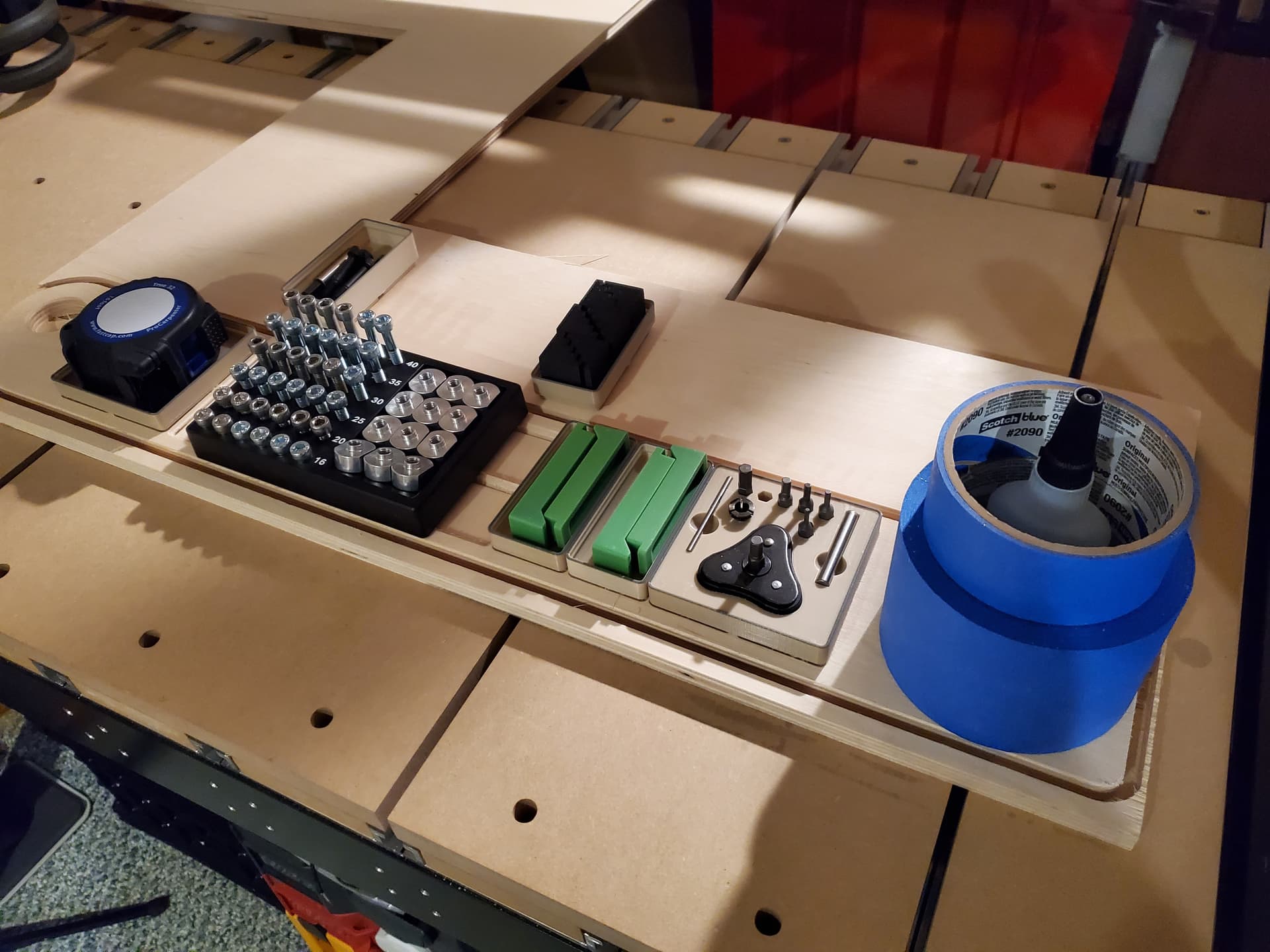

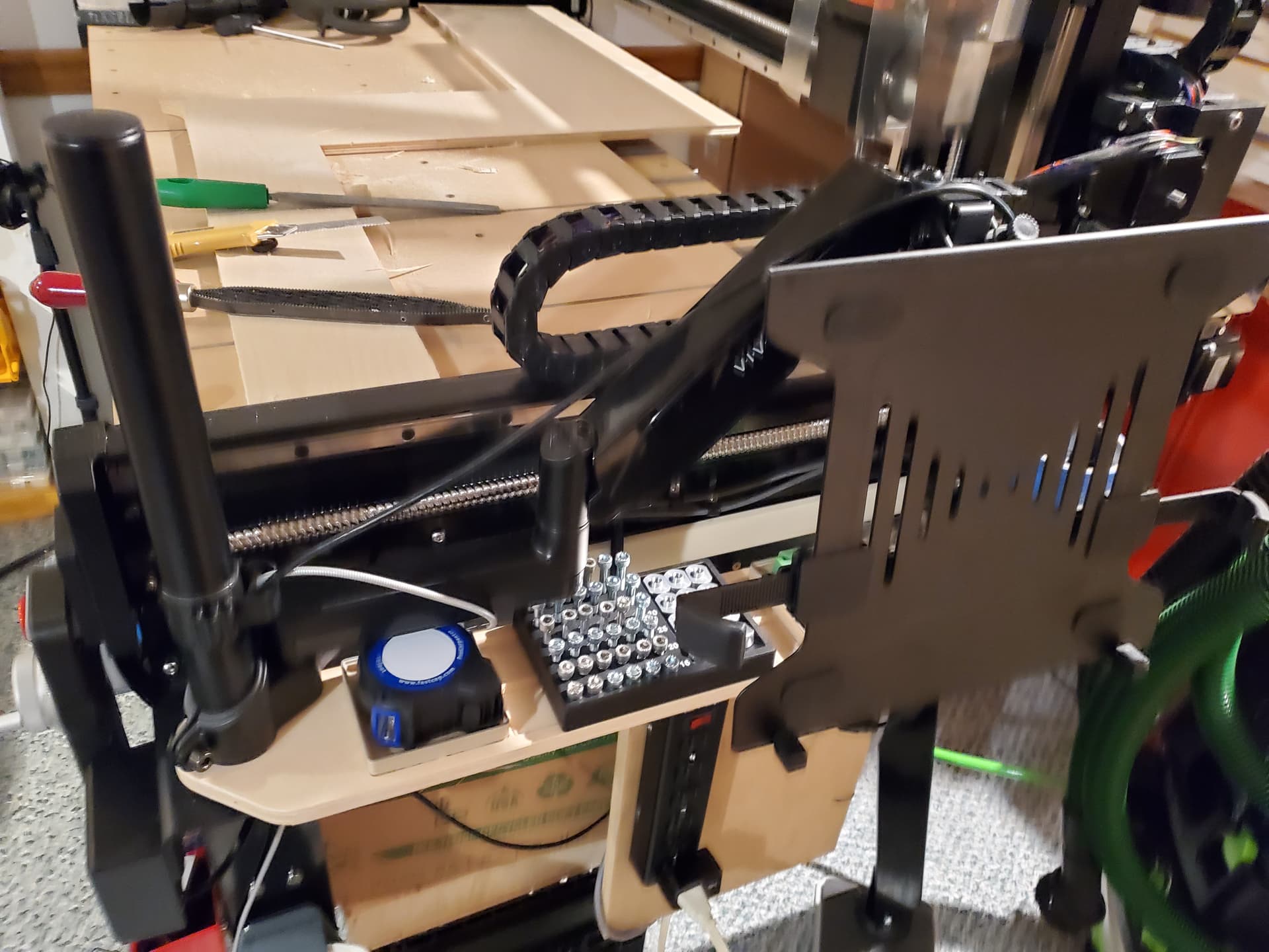

It stows:
and deploys as well.
I suppose eventually I’ll need to either fabricate some sort of support/truss or make a replacement out of something more rigid than 12mm Baltic Birch…
