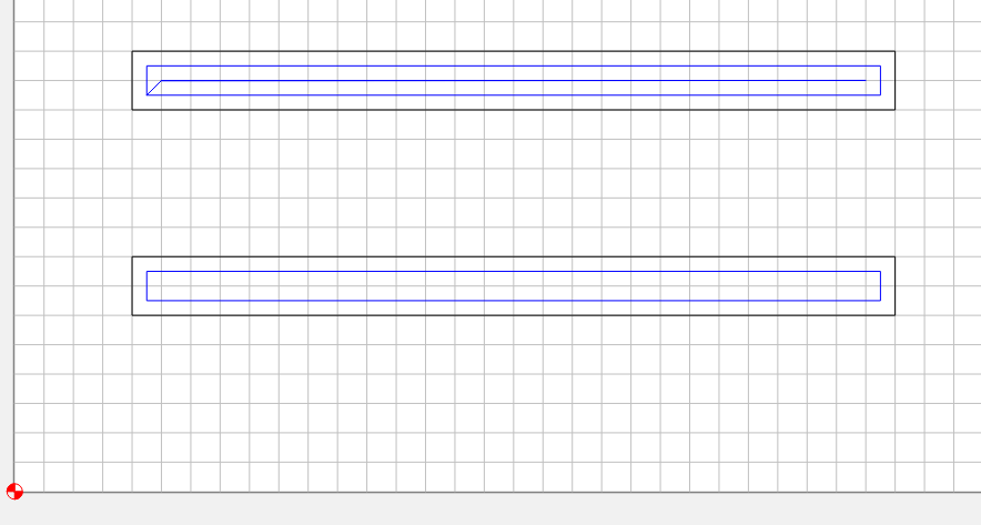

This was frustrating until I figured it out. Apparently ‘stepover’ does not work exactly like I thought it would.
Look at the attached file. Same 1/2" wide rectangle both use a 0.25" endmill. One with a 0.125" stepover and the other uses a 0.124" stepover. When stepover is set to 0.125" it looks like the machine assumes everything is perfect and ‘stepover’ as I would define it is zero. The half inch wide path is done with two passes of a 0.25" endmill.
The fix is to change the stepover to just 0.001" less than half the diameter and then the tool path will include a run down the middle that will clean up the fuzz you are seeing.
stepover_test02.c2d (10.5 KB)
This is one thing that always confuses me. In the tool setup it says my step over is 15% This produces a 50% step over. If I have a 1/4" bit and a 15% step over the step over on the other screen it has 0.125". That is a 50% step over, not 15%. What I do is 1/8*0.4 = 0.01". Confusing.
