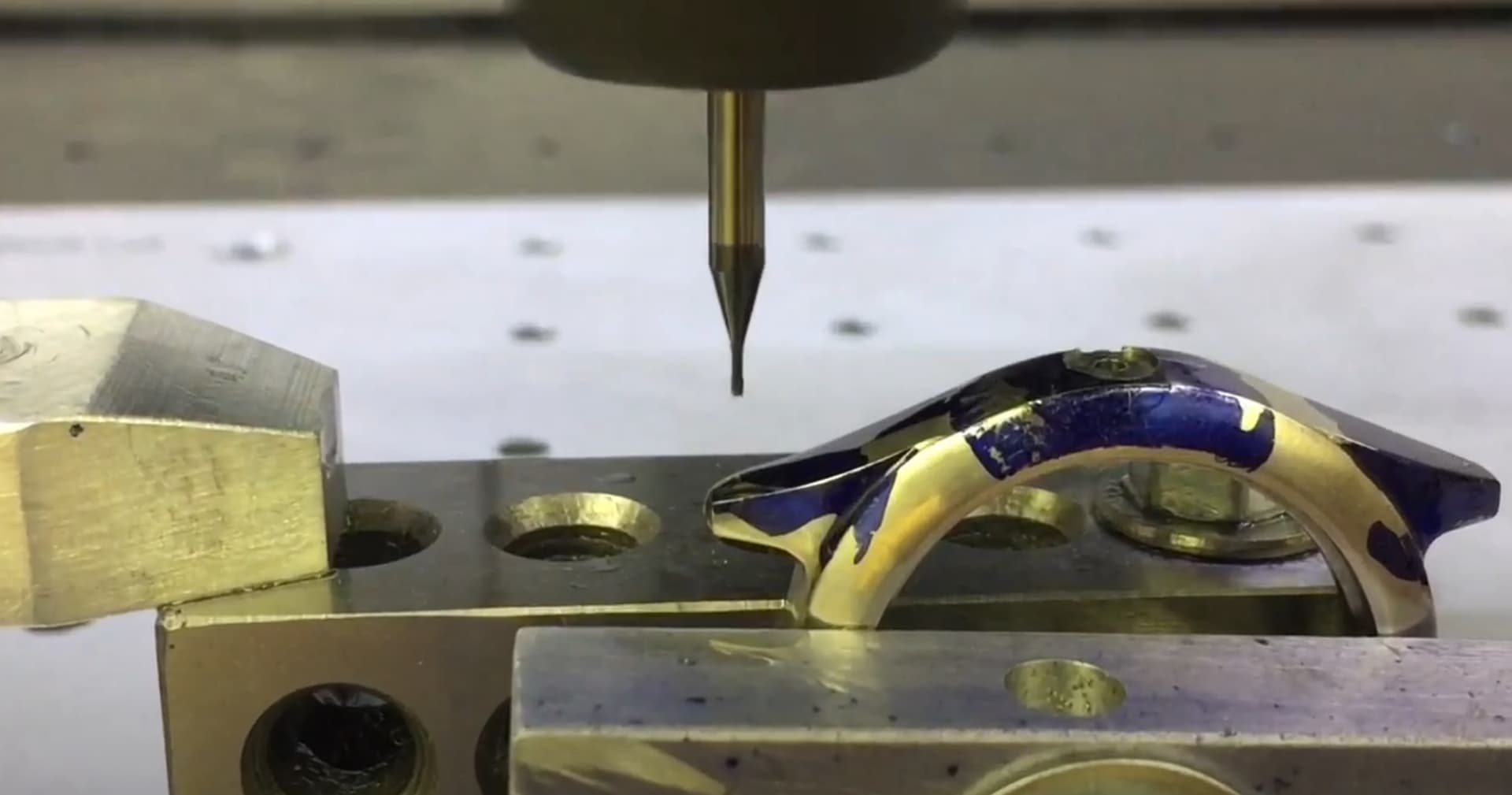

How do I use a 1/32 in bit?
How do I use a 1/32 in bit? Pro XXL
There are feeds and speeds for a #122 endmill in all the materials Carbide Create supports in the current version:
https://carbide3d.com/carbidecreate/download/
Thank you so much. It’s been downloaded and ready to go.
Carefully!

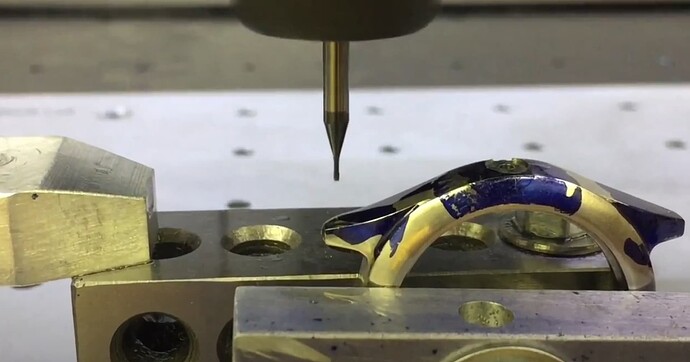

Here I am cutting some 303 stainless steel. Cutter survived. As Will said, ALWAYS obey the proper SFM (Speeds/Feeds/Cutter load).
