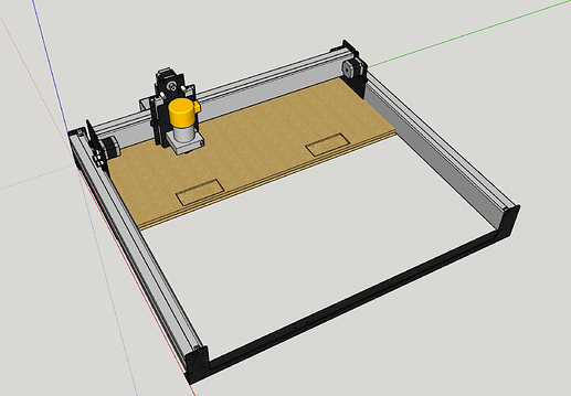

Bear with me… I’m trying to make my XXL a little easier to carry around. The idea is to pocket out 1/2" deep recesses in the underside of the stock spoil board so that I can install these:
https://amzn.to/2CRCFdS
Yesterday I discovered the Z Axis issues when trying to go >100mm in the -Z direction. So I suppose I could do this pretty easily with a trim router BUT the other idea would be to remove 1 half of the stock spoilboard and put it on top of the other side and use the Shapeoko to create the recess zeroed in the SE corner. Then rinse and repeat for the other side in the SW corner.

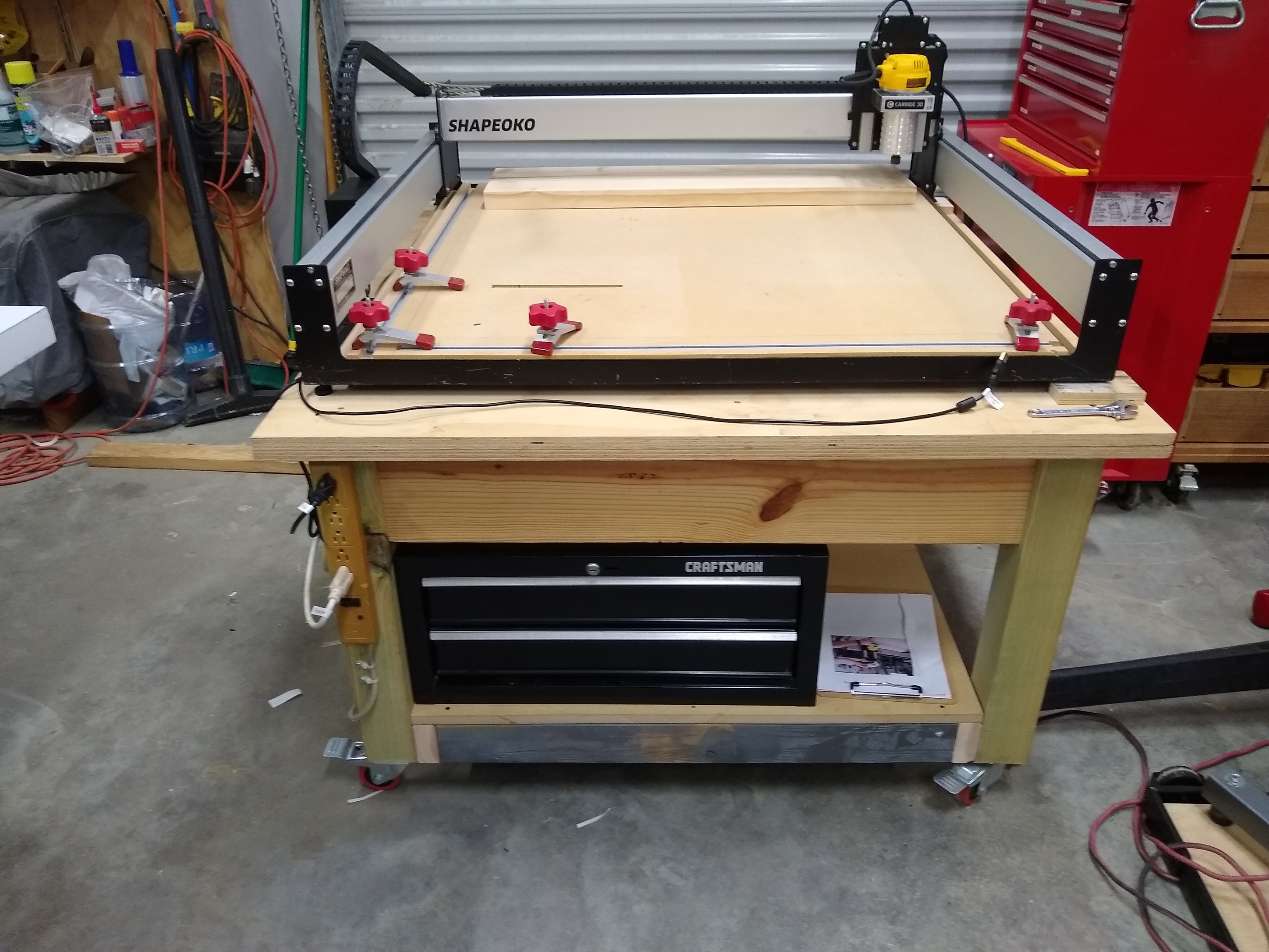

An XXL is quite large but moving it around is not a good idea. If you are limited in space look around on the forum and people have all kinds of work arounds. You could put the XXL on a platform that you could lift up above your work area. You could make a rolling table so when done with the machine you can put it in another part of the shop.
If you decide to lift it make a torsion box for the machine to sit on and hoist it up on the air. Just dont try to move it around the results will not be good.

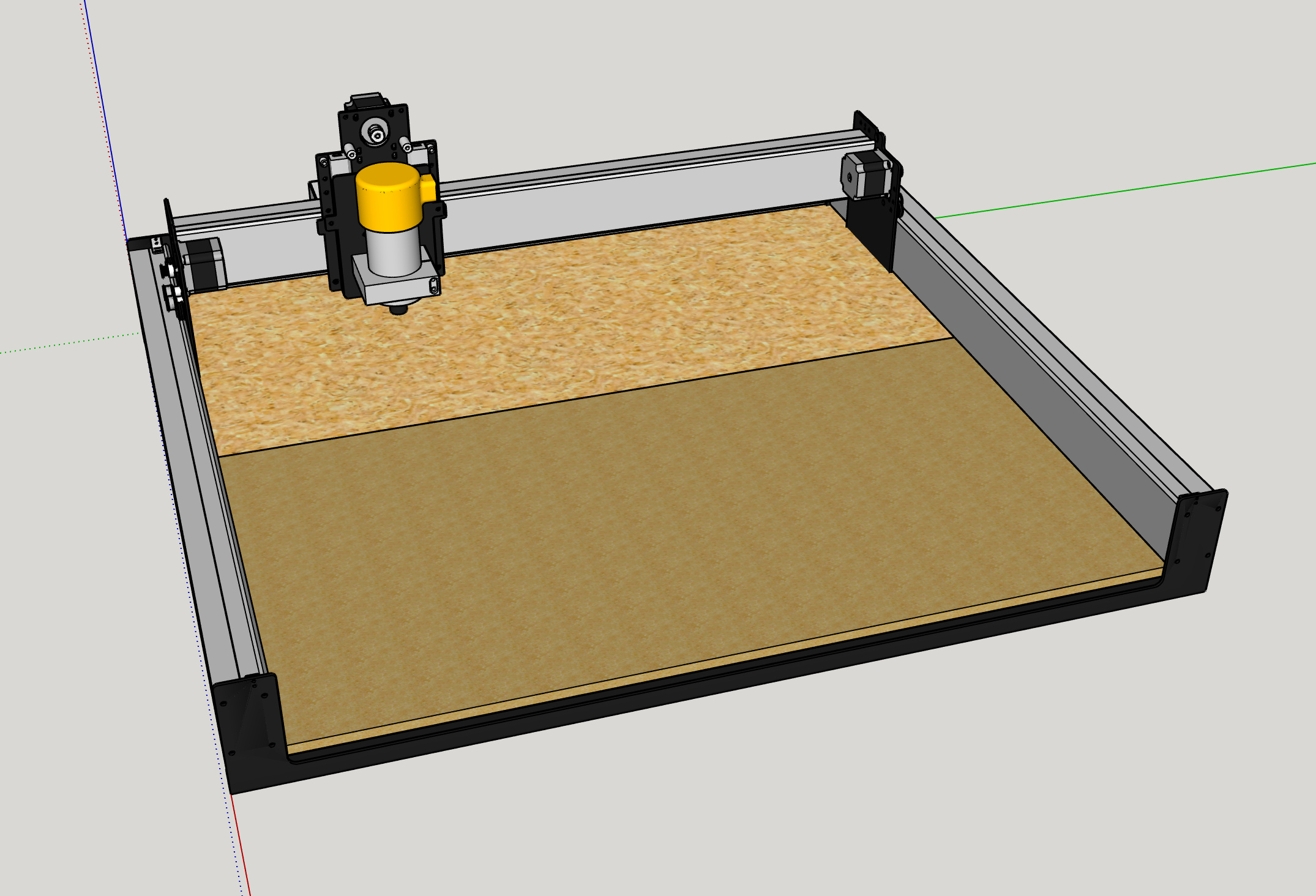

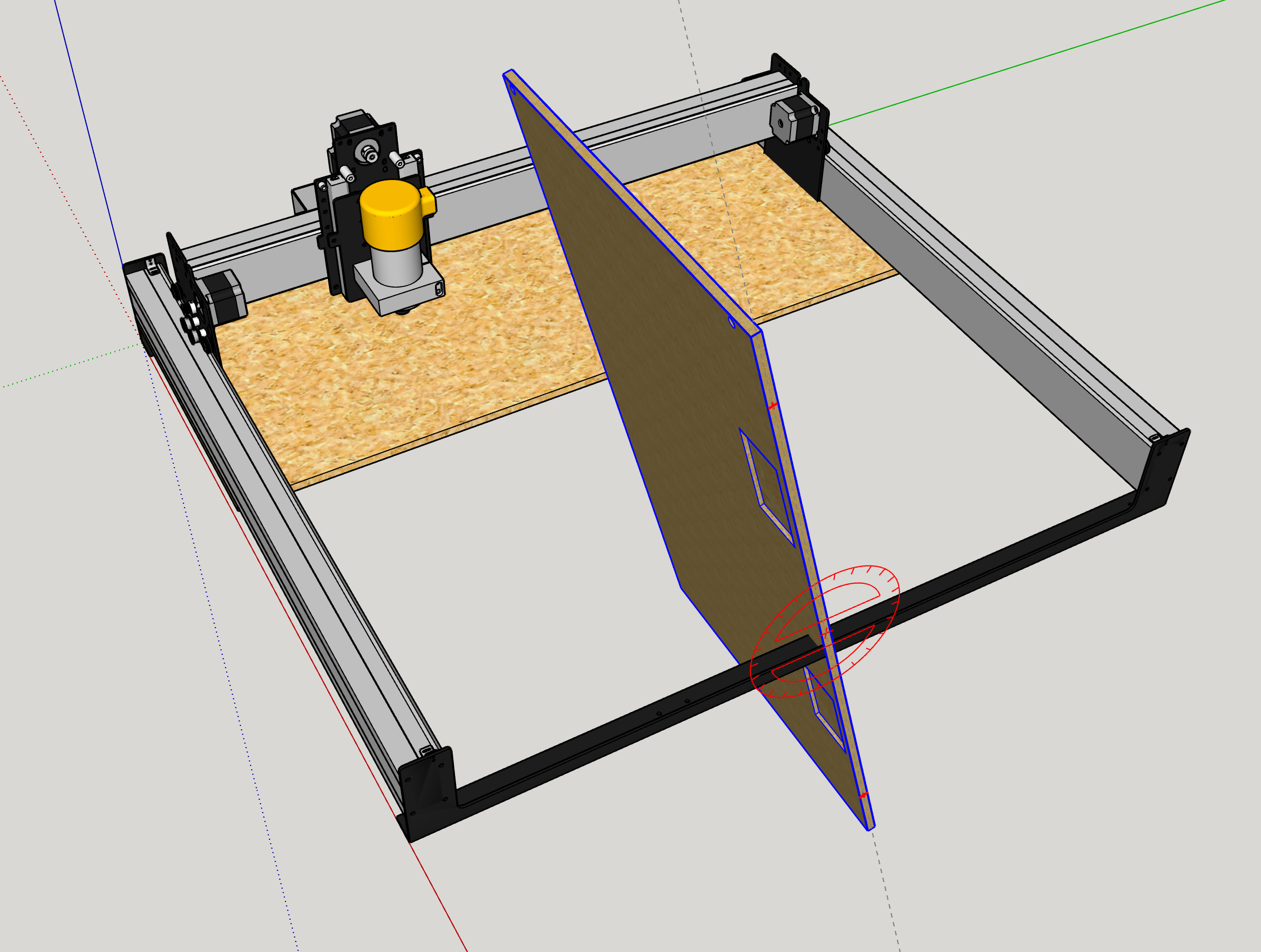

Perhaps I did a poor job explaining myself… Heres an illustration, I’ve colored the 2 XXL wasteboard half different colors so you can keep track. I’m asking the question of… can the Shapeoko XXL run with half of it’s washboard installed… so that I can modify the other half the wasteboard?
Does that make sense now?

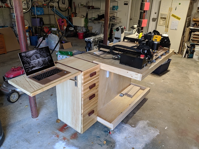

Maybe you should consider something like this support an X_Carve owner built to save room. It could be modified to further reduce the footprint and take the whole thing on wheels.
It would be much safer. It is not a question of losing a bit of accuracy but creating issues that would make your Shapeoko unreliable.

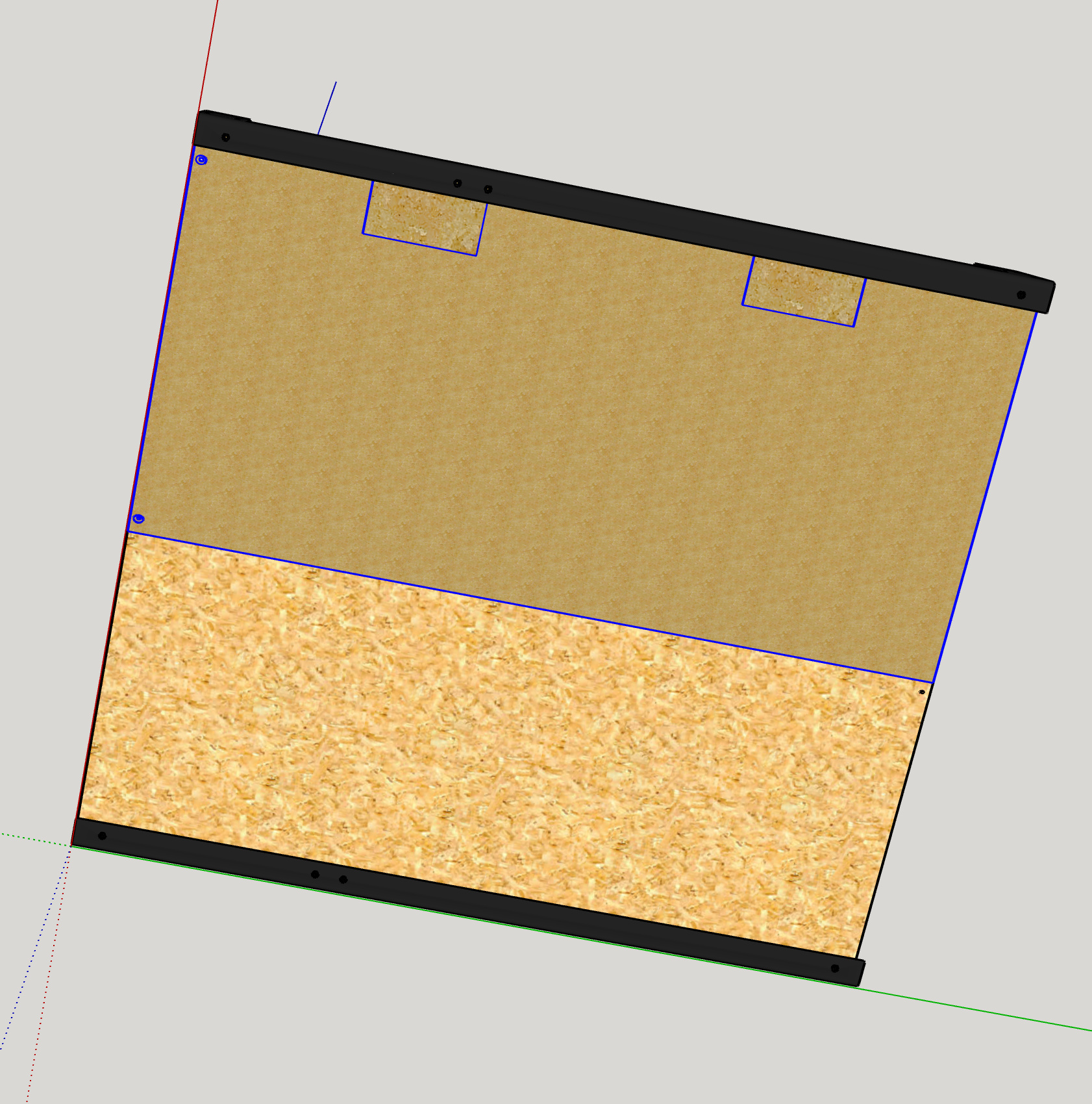

We are still mis-communicating… All I want to do is install some handles on the underside of my XXL so that I can move it FULLY assembled more easily. My only question is… do you think I can recess out the holes using the shapeoko and not a trim router workflow that I pictured safely and with more accuracy then a trim router?
Step 1: Remove half of stock wasteboard
Step 2: Flip removed stock wasteboard 180 degrees so it is upside down
Step 3: Place removed washboard on top of other half that is still installed
Step 4: Recess holes for handles
Step 5: Reinstall removed half
Step 6: Install handles into recesses
Step 7: Move more easily

The machine can readily make the pockets for handles using the process you describe. (step 3 and 4) That’s the sort of work it’s intended for, and really good at.
Lol okay thanks; I was just concerned that running the pocketing operations with only 1/2 of the wasteboard on the machine would cause problems.
PS I never suggesting moving it with the wasteboard off; that’d be silly and way too much of a pain in the ass. I’m planning to add a supplementary wasteboard so it’s only going to get heavier. Need the handles to make it less awkward that’s all.
