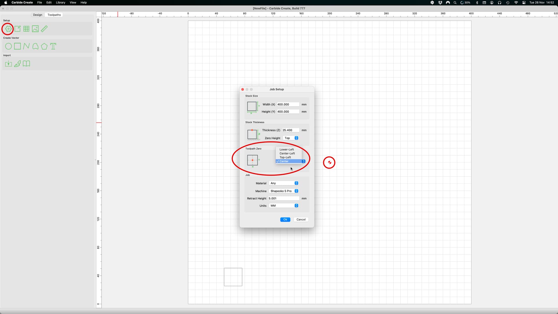

You can set that point when you select your job setup. In the first image, you can see the job setup cog. Select this and the dialogue box presents you with options. I have entered the size of my work area as 400 x 400mm for X & Y and a thickness of 25mm. I am also measuring the zero height, where the cutter will begin its work at the top of the stock. The highlighted area is the toolpath zero and I have selected center. The smaller highlight shows a red and white quartered circle at the centre of my 400 x 400 area. This is exactly where the tool will measure the workpiece dimensions from and should start at that point, depending on the type of cut. The retract height and the units are important. I have mine set to mm and a retract height of 5mm. that is when the cutter has stopped cutting and must move to another point on the workpiece, it will be raised by 5mm so that it does not cut anything you wish to keep intact. Enter your machine in the drop down menu here too. Material may not make much difference to where you are cutting.

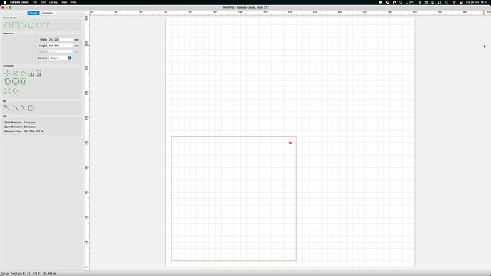

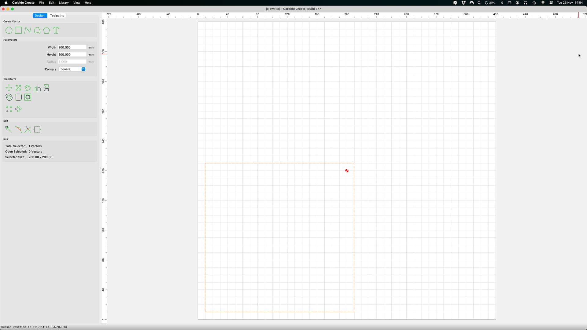

It is your choice as to where you want the workpiece on your overall work area, depending on workholding constraints. Where you place the staring point is also up to you. The next illustration shows a 200 x 200mm square. I have placed the startpoint at the top right of the square and the square at the bottom left of my total available work area. The red and white quartered circle indicates where the cutting work should start from.

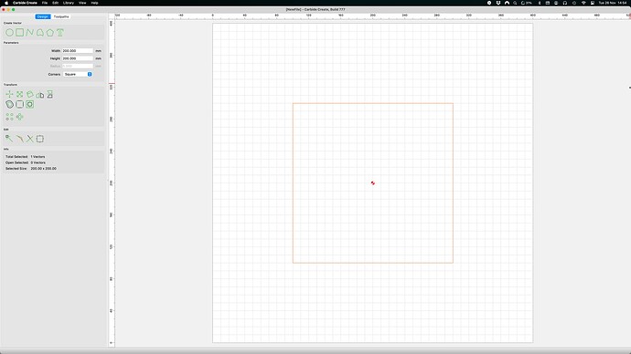

The next illustration shows the 200 x 200mm square in the center of the work area. It shows that the start point is also placed at the center of the square.

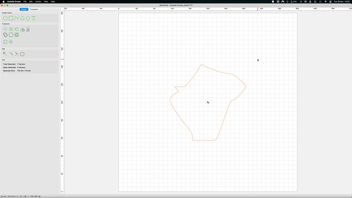

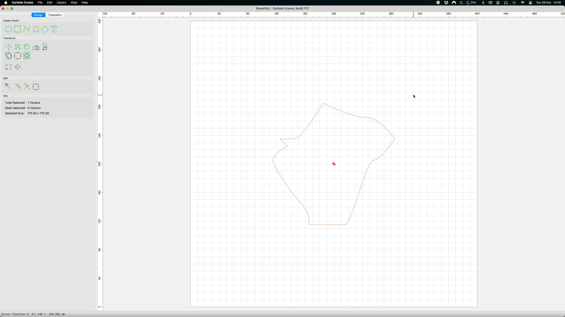

Finally, if you have an irregular shape, you can still start the cutter in the centre of it. Use the centering tools and then you will find that the cutter will start where you expect it to.
