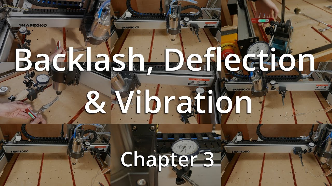

The movements you’re looking for are the Z nod and Z rock movements in the diagrams
drop the Z until the spindle is close to the spoilboard, leave the machine on with the motors holding position
Measuring Z nod deflection
clamp the dial gauge base down to the spoilboard
set the dial plunger on the front of the spindle, close to the collet, you can indicate on the collet or a cutter but these rotate and it’s easy to get bad readings
push the collet forward and backward, I use a push with my little finger to ensure I’m only applying 2-3kg of force.
with an HDZ and V wheels I’d expect to see < 0.3mm forward & backward, any more than this suggests wobbly V wheels
Measuring Z rock deflection
clamp dial gauge base to spoilboard
set the dial plunger on the side of the spindle, close to the collet again
push the collet left and right with a little finger
on the HDZ and V wheels I’d expect to see < 0.4mm left / right (you have V wheel wobble plus belt deflection in this movement axis)
It’s a lot quicker and easier than it sounds once you’ve done it once or twice. You can also generally feel the knock if something is really loose.
