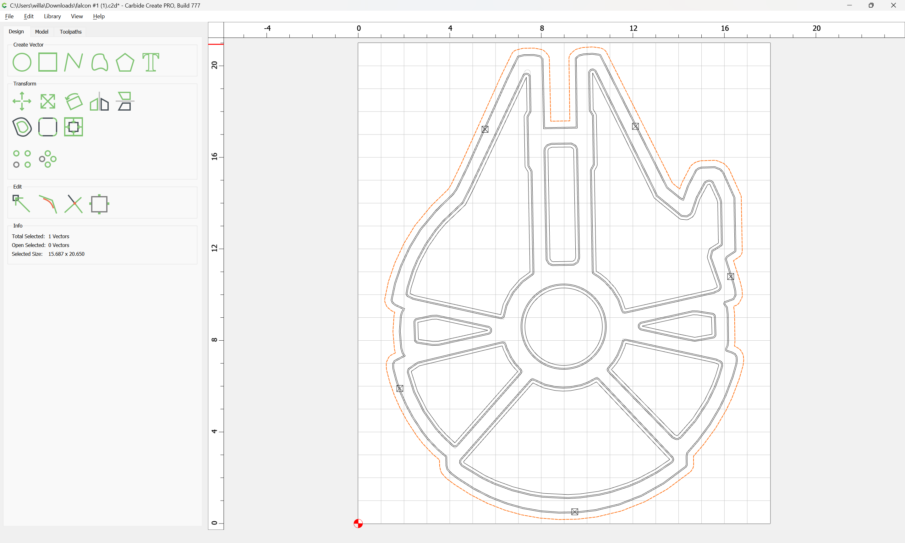

I have a project finished and ran it, however the bowl cut needs to be cleaned up a bit so how do I create a finish toolpath with the existing project? I have tried to highlight the toolpath and just add a finish toolpath but the project wont highlight, I am new as you can tell so can anyone give me step by step on how to do this?

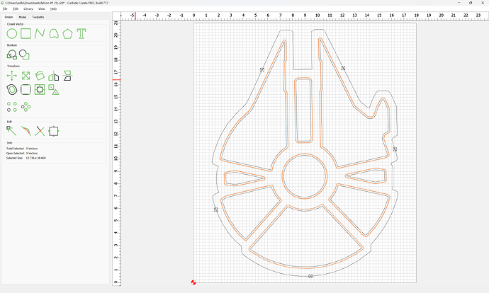

Making a finishing pass in the current version of Carbide Create pretty much requires that one adds geometry so as to create a “Roughing Clearance”

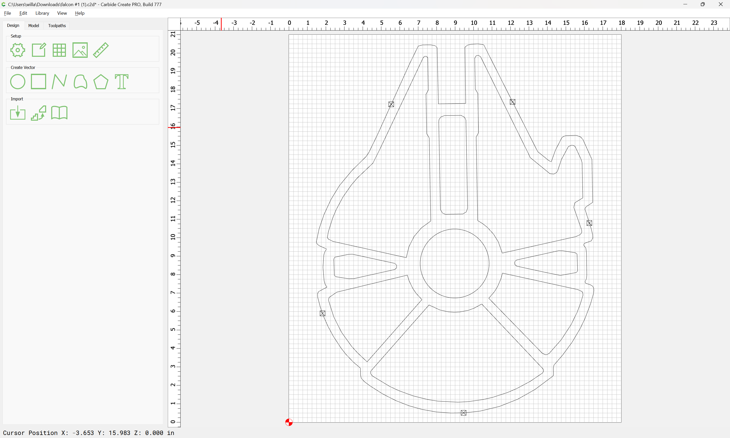

Given the design:

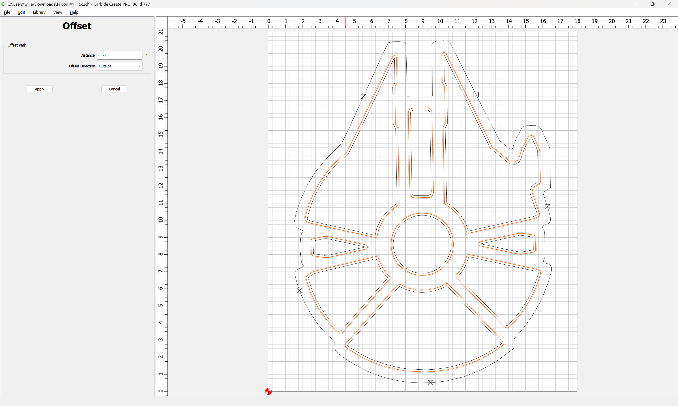

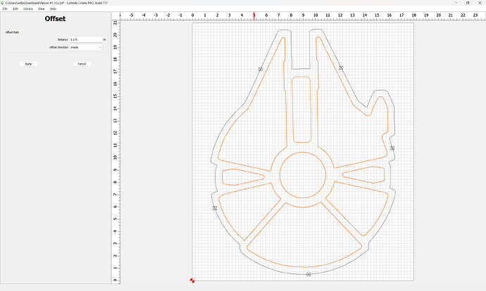

assuming that one wants to create a rounded bottom perimeter using a 1/4" ball-nosed tool and to leave an 0.05" roughing clearance we would start by selecting all the geometry for the pockets:
and offsetting to the inside by the radius of the tool (0.125") plus the desired roughing clearance (0.05") for a total inset of 0.175":
Apply
This geometry should represent the flat bottom of the pocket — there are two ways to get an effective finishing pass for the bottom of a pocket:
  • leave a roughing clearance uncut and cut with a different tool as a finishing pass
  • do the math and ensure that the final pass removes a very thin layer of material
We will do the latter — if the specifics of the bowl bit were provided we could provide a different tutorial showing the former.

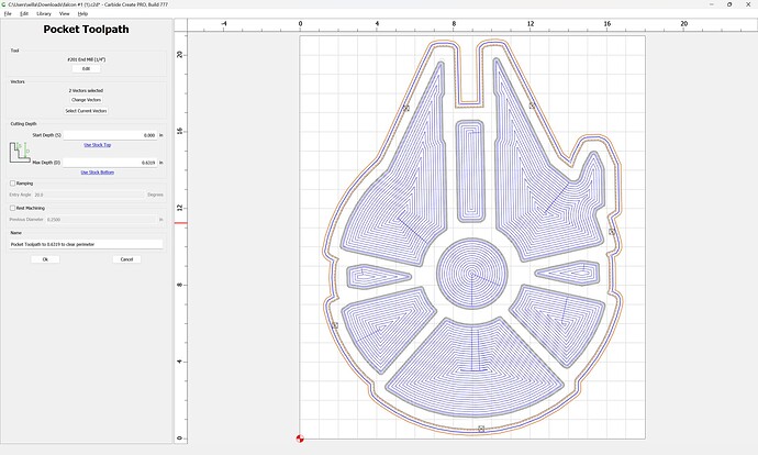

Using a #201 in hardwood the default Depth per Pass is 0.125":
in this case, the desired pocket depth is 0.45":
0.45/0.125 == 3.6
which yields a rather heavy cut for the last pass, instead trying for 4 passes we determine:
0.45/4 == 0.1125
so if we reduce the depth per pass to 0.112" we will get four full depth passes which will cut to a depth of:
0.112 * 4 == 0.448
leaving a roughing clearance of 0.002" and a final pass which removes just that thin layer:

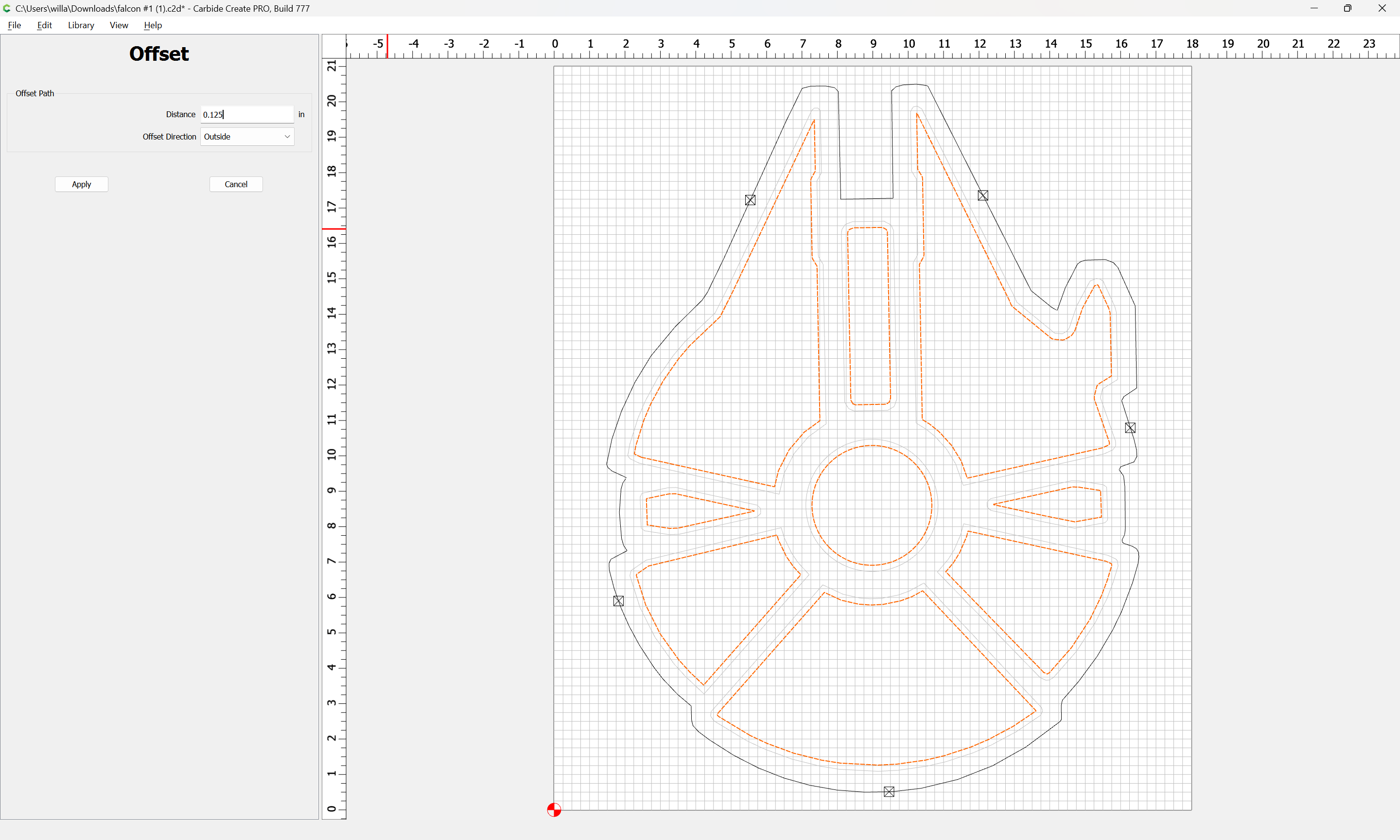

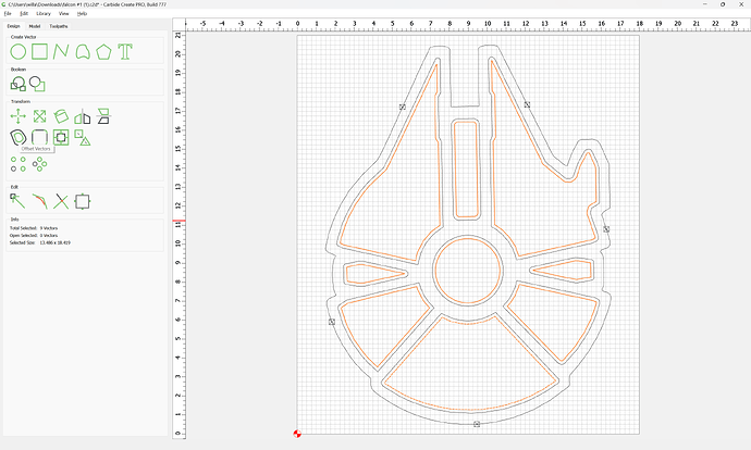

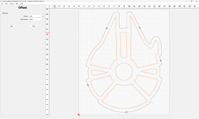

We then go back to the Design pane and offset to the outside by the radius of the tool:
(probably to make this clearer it will be better to select the original geometry and put it on a hidden or locked layer)
Apply

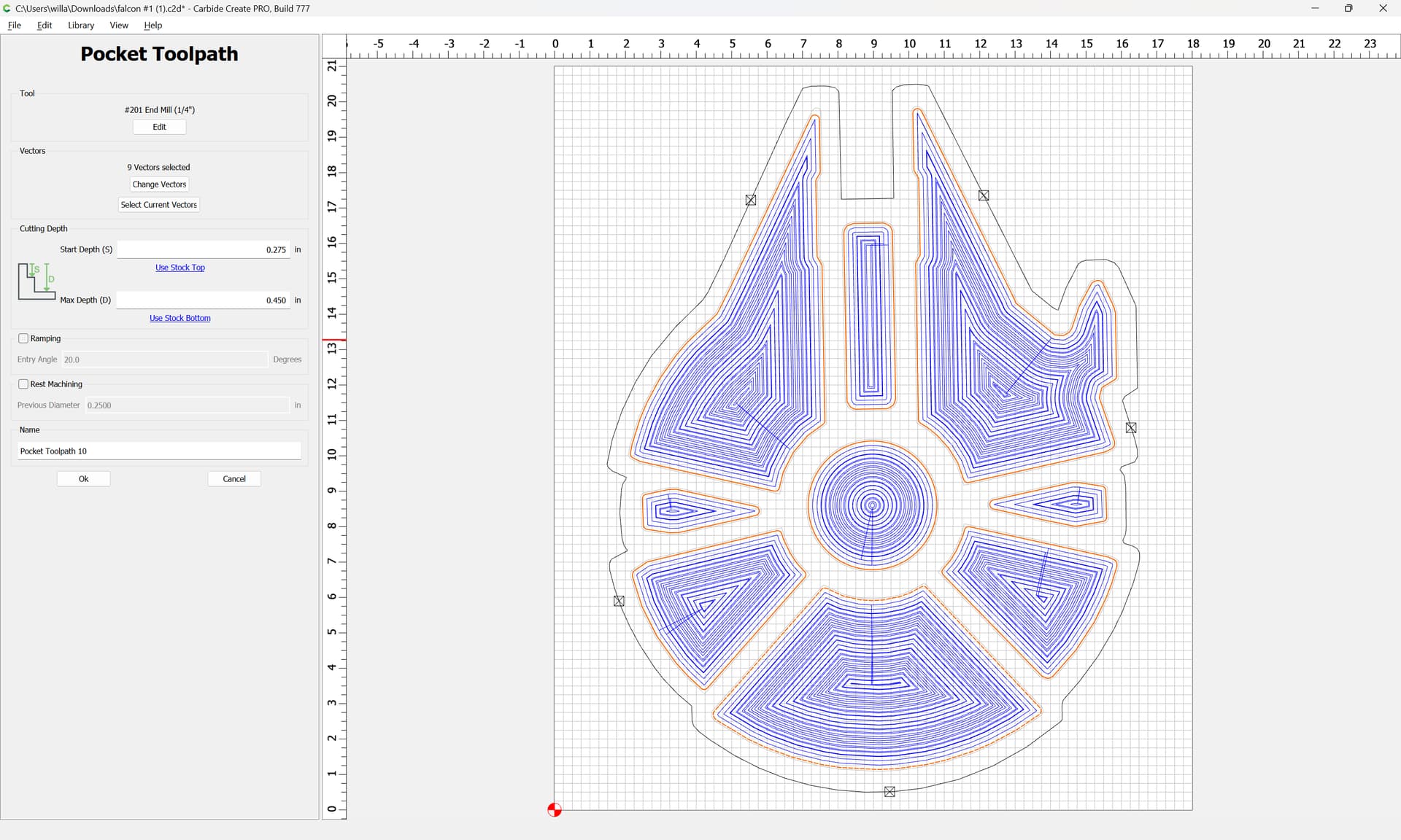

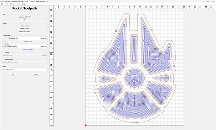

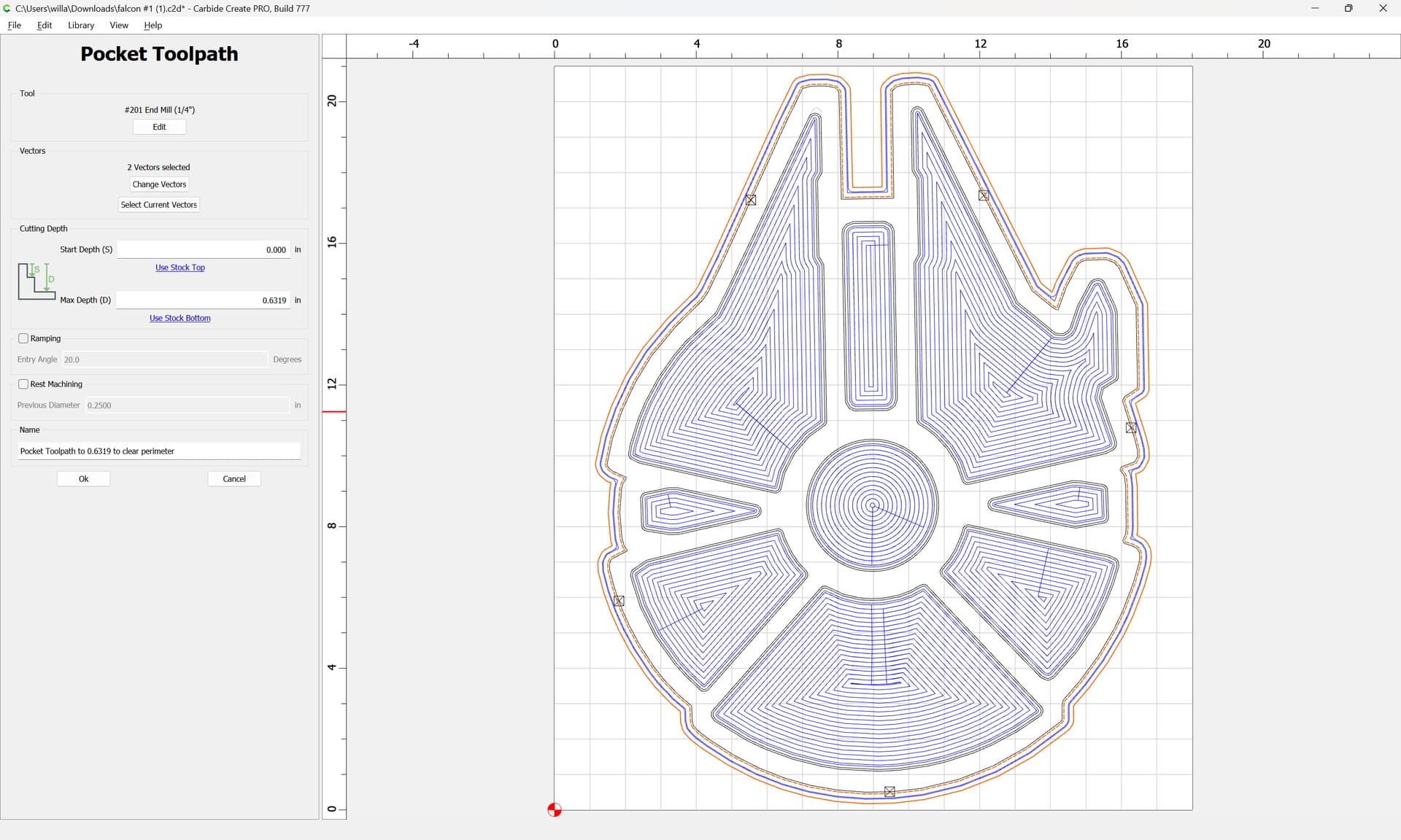

Again, this wants a pocket cut to
depth - (radius + roughing clearance)
arguably one cut before the other, but that can be adjusted for:
Cutting this to a depth of 0.275" we move this pocket up before the previous operation:
and then adjust the now second operation to start at the bottom of that pocket:
and adjust Depth per Pass to make a single heavy pass and then cut the finishing pass thickness.

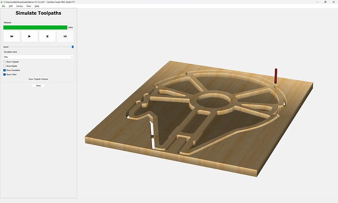

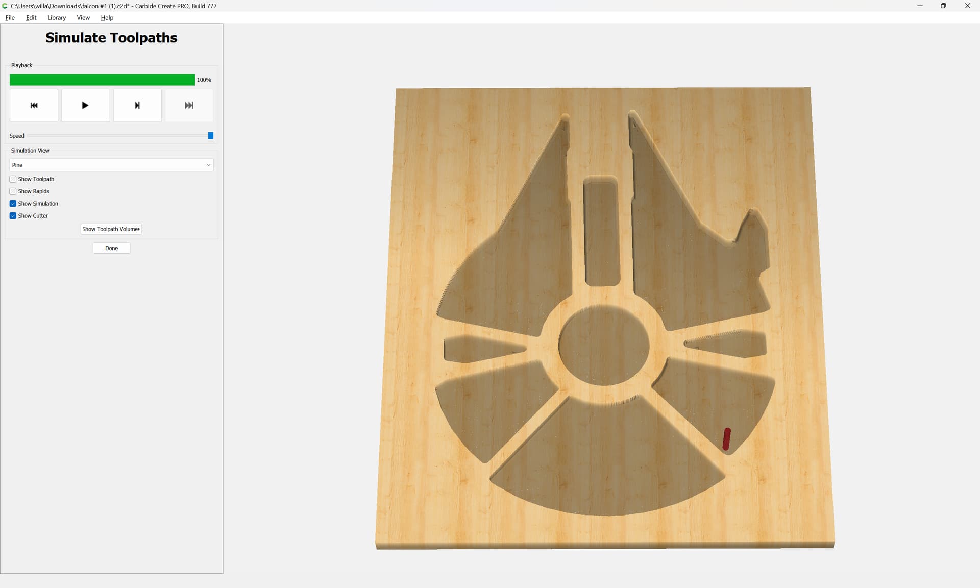

Checking the 3D preview:

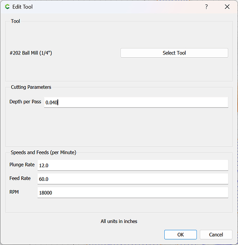

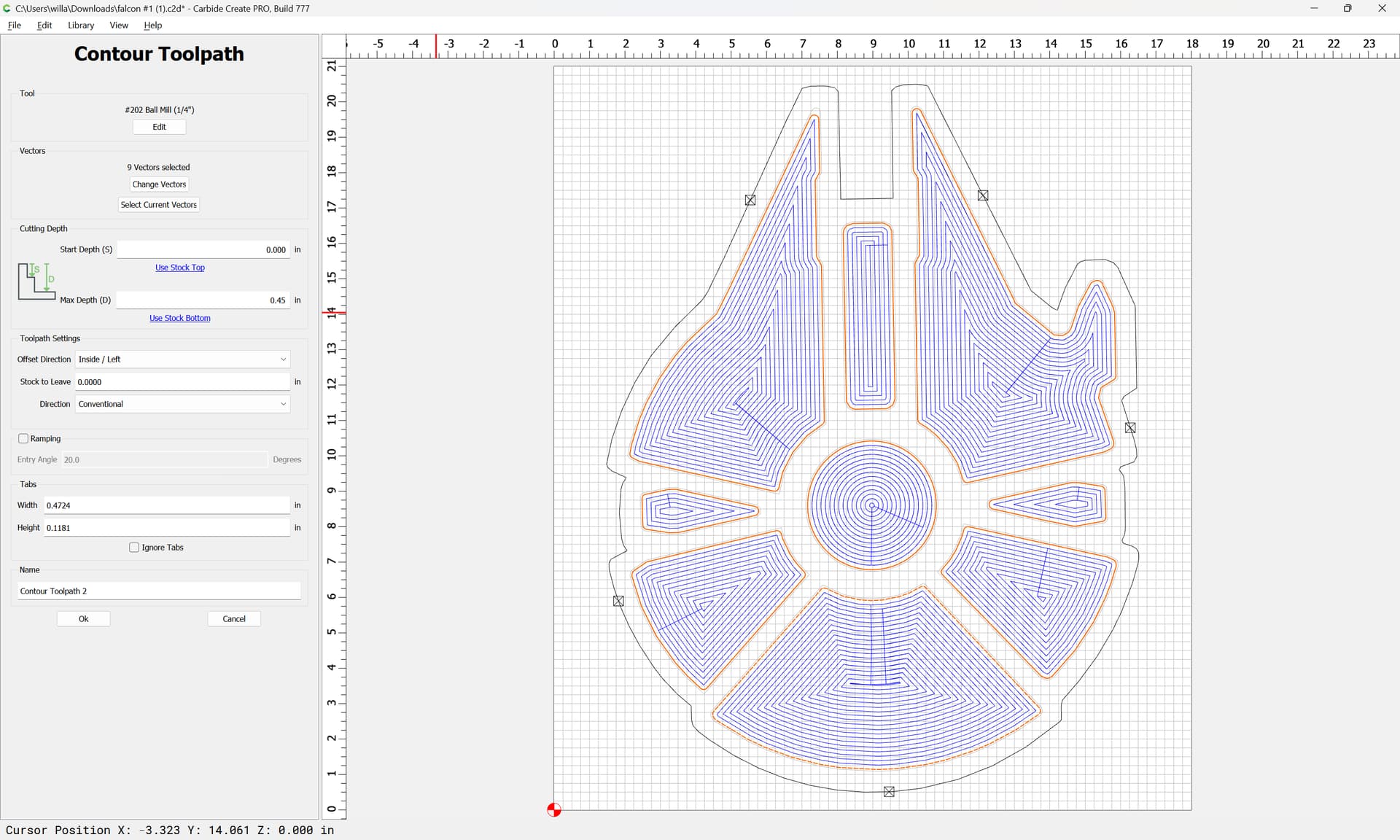

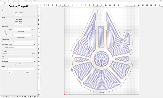

we can see that we need to smooth out the perimeter — this will be done in a pair of toolpath operations — the first will use the current geometry to remove the balance of the material at the perimeter:
again, adjusting the Depth per Pass so as to ensure that the final pass removes a very thin thickness of material:
which fortuitously is the case:
0.45" / 0.04" == 11.25

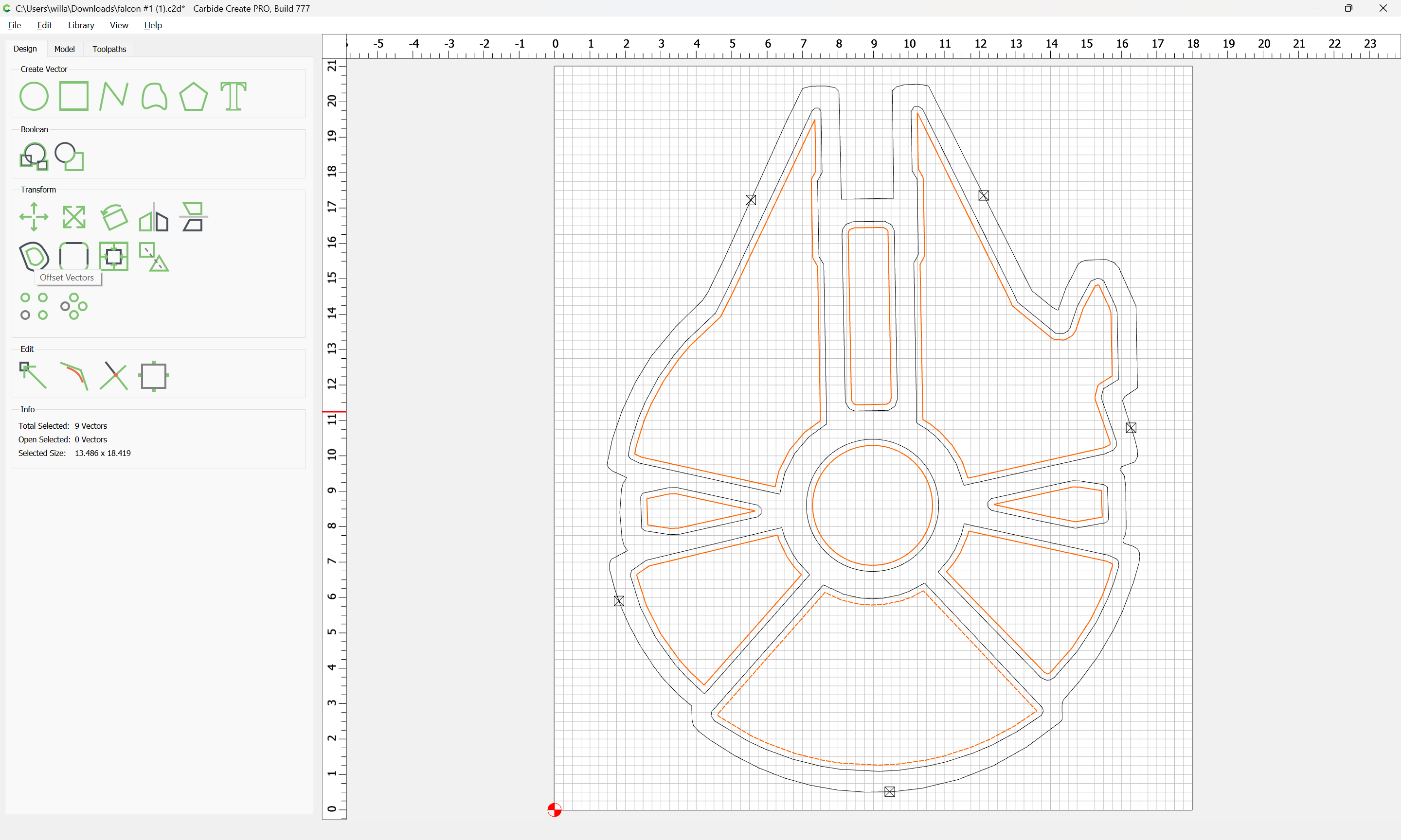

We then offset to the outside by the roughing clearance:
Apply

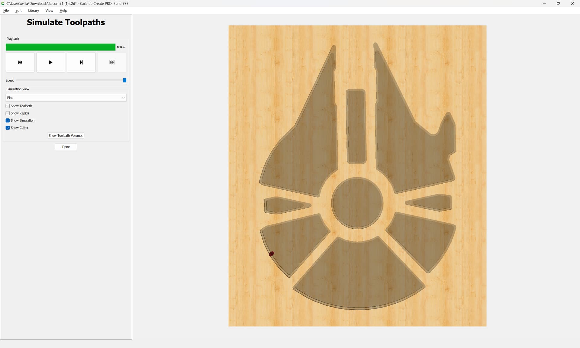

which now previews as:
We can verify that the rounding occurs for the pockets by temporarily adjusting the Stock Thickness:

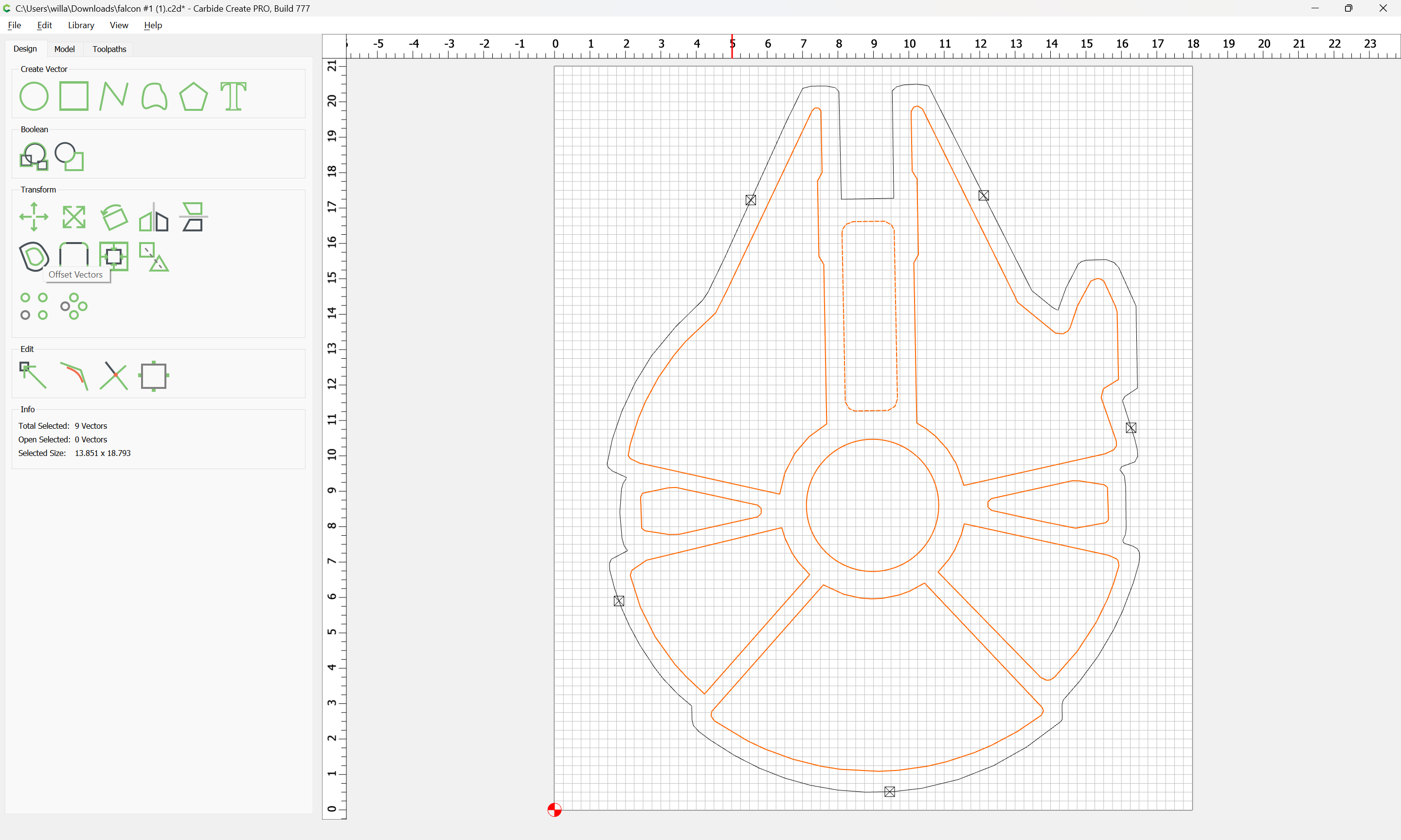

To apply this same principle to the perimeter we would need to perform similar offsetting, but in reverse:

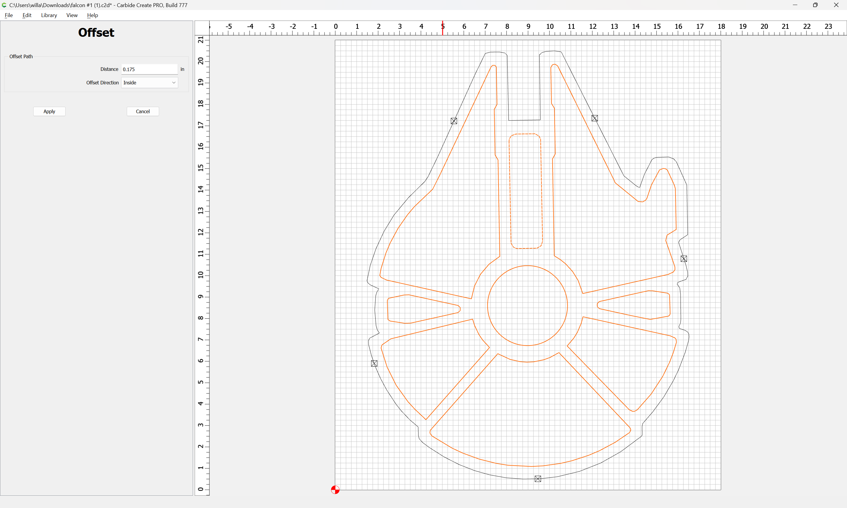

Offset Vectors:
(that gets one a roughing clearance)
Then offset by endmill diameter plus 10%:
The two offset goemetries may then be selected and used for a Pocket down to tab height:
Then the original geometry may be selected and an Outside Contour toolpath used to cut the part free:
