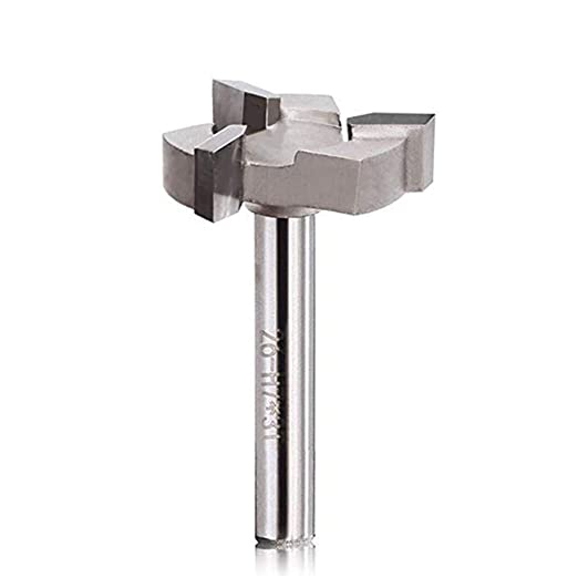

I have a surfacing bit, but it’s just the vertical faces, no plunge allowed. Other than turning it on and manually jogging it, is there a way with Carbide Create & Carbide Motion that I could have it do the plunging outside the work face?
Attached is a pic of the bit. Should be clear why I’m not keen on plunging inside the work face (though perhaps I could do it to a very small amount, as the teeth reach lower than the shank).
You should be taking such a light cut, w/ such a small value for depth per pass and such a shallow total depth of cut that plunging won’t be an issue.
Flat.nc (775 Bytes)
This is the file I use for my XXL Pro. Turn off your Bit Setter. Use the paper method to measure “Z” zero
