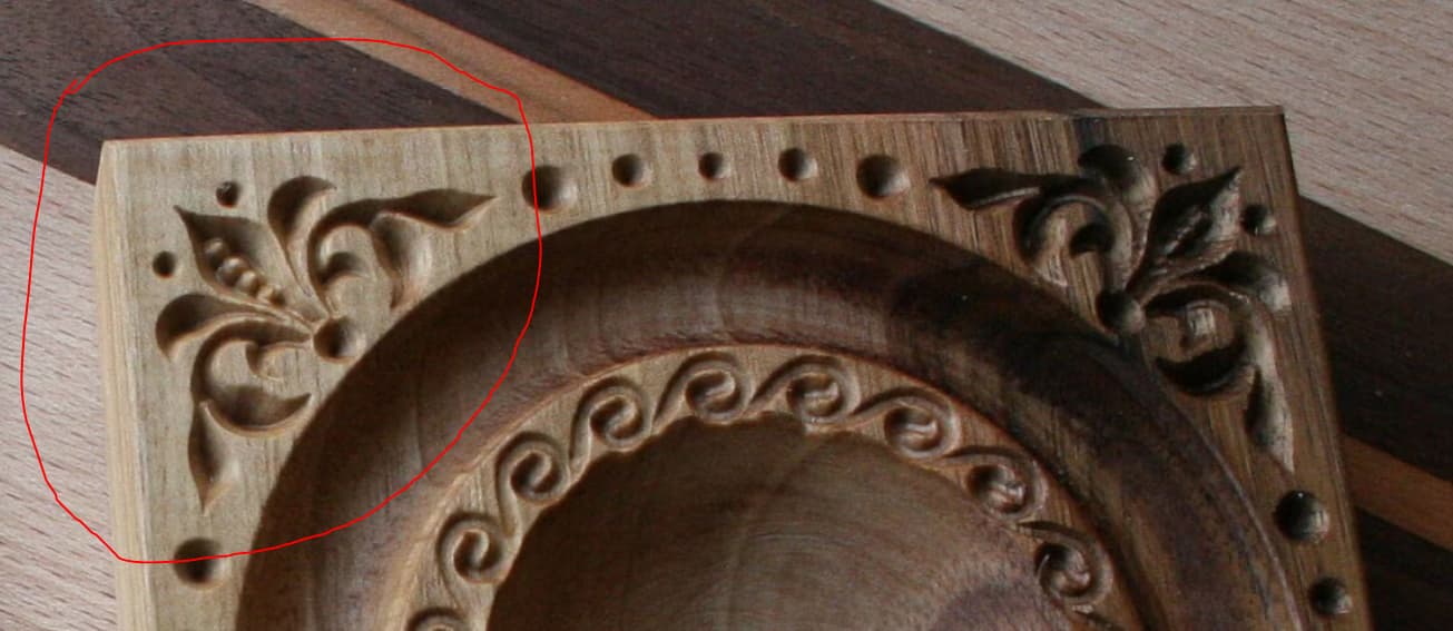

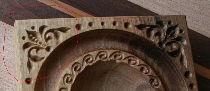

Can anyone explain how to (or point me at a resource) create these sorts of flourishes that might appear in the corner of a rosette moulding or box lid? Is this something that can be accomplished with Vcarve? What bit is needed? Anyone know of existing patterns?
I’m running Carbide Create (free version) and a Shapeoko Pro 4.
Thanks!
Dave
One traditional term for this is fleuron, “printer’s flowers”, one style for this sort of design is called Sheridan.
The Craftsmanspace folks have some files:
Given a suitable vector such designs should cut well as V carvings.
And if you want to make your own, you can make a simple black and white image and convert it to a vector with Inkscape - among many other programs - and have your own design that no one else has.

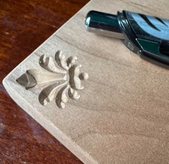

Will’s magic word “fleuron” helped a lot. I found this sample on craftmanspace.com and here is an example cut.
And here’s an example of the cut (CC Vcarve, 90deg V):
So, I’m well on my way to creating exactly what I was looking for.
